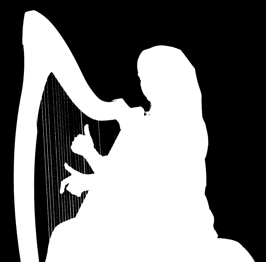

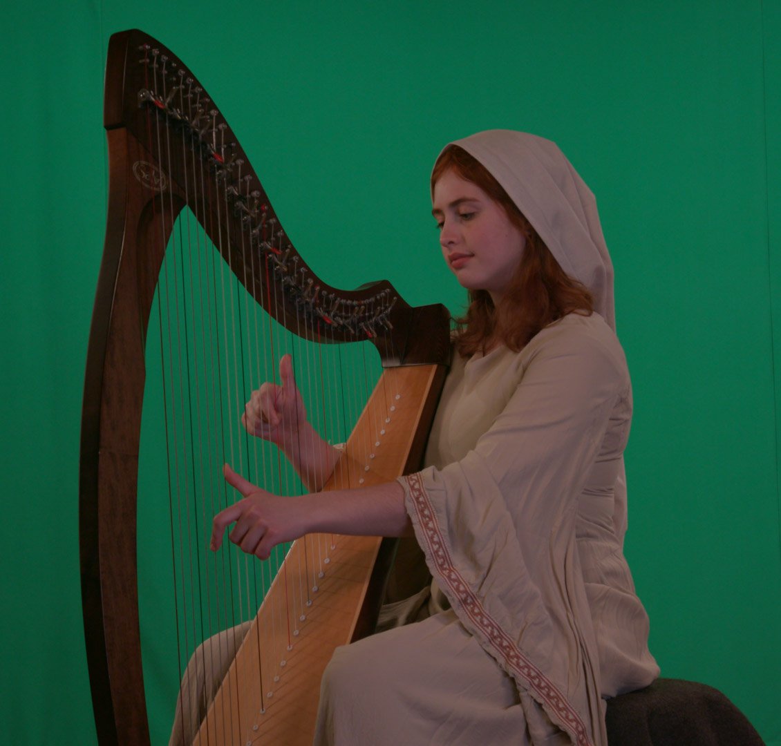

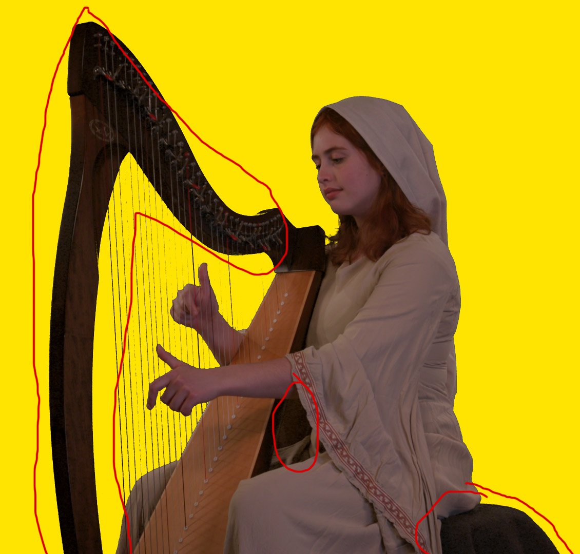

davidlondon Posted February 7, 2020 Author Share Posted February 7, 2020 Hi, thanks for writing. Here's the images first from the camera direct , a flat profile no editing. The second is the key, I've just done this quickly so I know it's not perfect but you can see the main body of the white area is clean. And on the final picture the noise comes in on the darker wood and seat areas plus the strings. It's on a 16 bit channel, I tried 32 bit didn't make a difference.. I have done green screen before, I added the key to show I'm not making a basic error. It actually appears that adding keylight , or a spill suppressor ..makes the footage grainy ? I hope it's my workflow, then I can correct it . I've not used 4:4:4 footage before.. ? Thinking out loud..possible codec issue ? Thanks again for getting involved , David Link to comment Share on other sites More sharing options...
HockeyFan12 Posted February 8, 2020 Share Posted February 8, 2020 This is not so bad. I don't think you did anything wrong, it might be a half stop underexposed but not that bad. Those strings are a bit tricky though... If you were to reshoot, I would rate the camera at around 160 ISO, whatever the lowest ISO is before highlights clip. That will get the shadows super clean and a nice thick image to work with. Cinema cameras generally don't apply denoising to the image (or look like garbage if they do) so you can get a much noisier image from a C300 MK II than for instance an A7S. Buy Neat Video, watch a few tutorials, and apply it before the key. It will slow your render down and cost $100 or something but it will also solve these problems. You will probably want to regrain after keying even. The data you need is there, you can get a clean key. Or try setting Keylight to "intermediate result" and using the spill suppressor plug in set to advanced and colorpicker green. It can look a bit less noisy but won't solve a dancing key. kaylee 1 Link to comment Share on other sites More sharing options...

mrtreve Posted February 8, 2020 Share Posted February 8, 2020 It does look a bit underexposed. It's best to fill up the waveform as much as you can without clipping to get clean results. I've had good results by lighting the green screen at about 60% IRE (in a rec709 profile). If you have to turn up the gain in Keylight it starts to eat into the rest of the image and makes things grainy. I think those strings are going to be touch either way as they're quite thin and with sort of blend in with the green. So if you do reshoot - It might actually be worth shooting this in 4K. You can pull good keys with 422 material. You could also up the shutter speed a bit to get less motion blur. Maybe one thing you could try is to transcode to prores in case AE is having a problem with the codec. I used to own a C300II and can vaguely remember some occasional issues with the 444 codec in Adobe. I think it's an RGB file instead of YUV so maybe it's something to do with that. Link to comment Share on other sites More sharing options...
