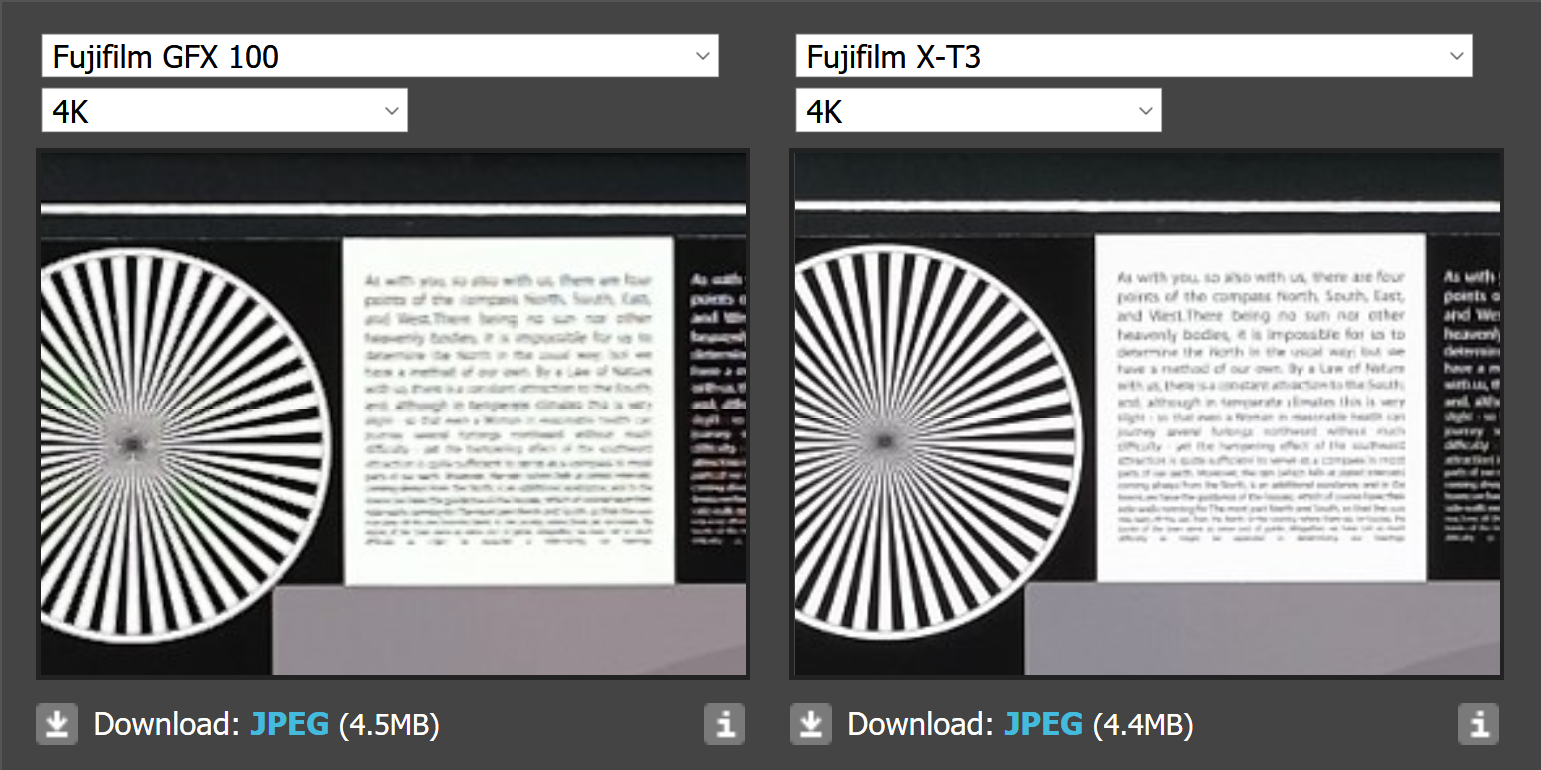

In terms of the image in 4K on the GFX 100 I am impressed by it and I wouldn't say heavy moire or aliasing... More like barely noticeable and very detailed, especially with real world (of course you can always see some zoomed in on a chart).

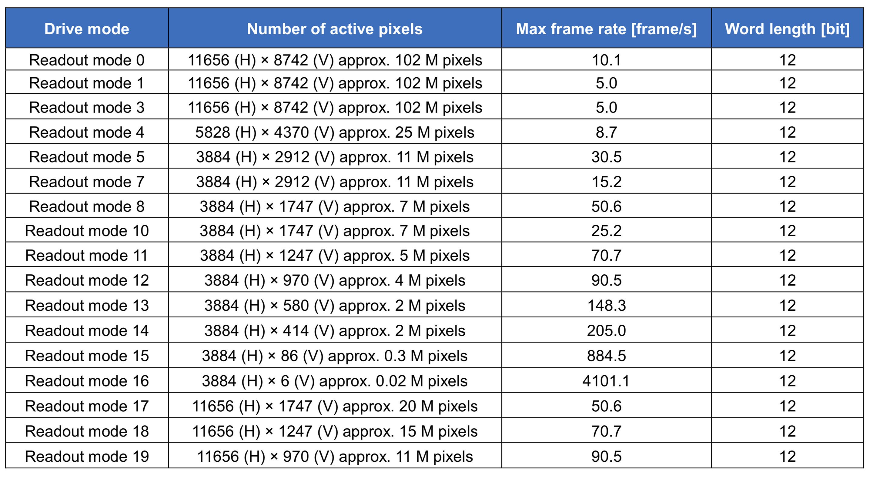

It's right there in the data sheet...
https://www.sony-semicon.co.jp/products/common/pdf/IMX461ALR_AQR_Flyer.pdf
See readout mode 5 at up to 30fps 12bit. Resolution is exactly 3882 x 2912.
So if the GFX100 sensor can bin like that, why would it heavily line skip instead?

If it bins like that, it doesn't sound good in marketing material.
GFX100 reads the full width of the sensor at 11604 pixel, and vertically 2/3 subsamples from 6528 to 4352. The downsamples to 4K. So technically it oversamples.

On close inspection there is aliasing and some jaggies on high contrast edges, some moire, a bit like an A7R IV or D850, but it's more or less under control for the most part. Certainly helps to turn the sharpness down in-camera.
