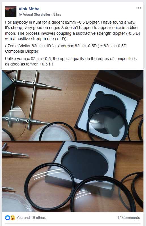

heart0less Posted March 7, 2020 Share Posted March 7, 2020 This popped up only today. Unfortunately, it's 82 mm.. Link to comment Share on other sites More sharing options...
Tito Ferradans Posted March 8, 2020 Share Posted March 8, 2020 9 hours ago, HockeyFan12 said: Thanks. It looks like a +0.5 is a necessity on the lomo. It only focuses to 1.5 meters so with a +1 you're missing the 1-1.5 meter range entirely. So the Focars, if they are +1 and +2, are not a good option except as a supplement. I talked with Raf and he thinks the 86mm might vignette as the original lomo diopter lenses are 93mm. I can custom order a Schneider +0.5 close up filter (single element) for a lot of money, but otherwise I can't find any good options. Do you know of any? If not no worries, appreciate all the help and will be confident getting the Schneider that it's the best option. Series 9 are unthreaded 86mm, so maybe you can get some wiggle room there? They are usually cheap enough that you could order just for trying, and they have +0.5. If you wanna be extra safe - and extra large - 4.5" and 138mm also exist, or look for the elusive +0.8 4x4 I found once. 7 hours ago, heart0less said: This popped up only today. Unfortunately, it's 82 mm.. I'm a bit skeptical and would only believe after seeing results and comparisons... Link to comment Share on other sites More sharing options...
