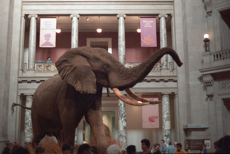

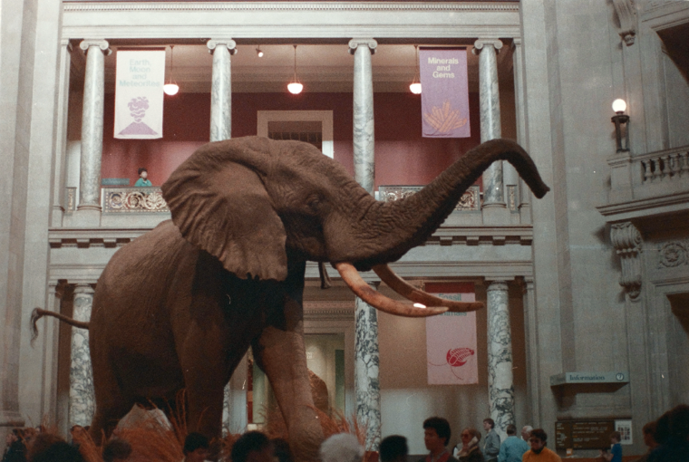

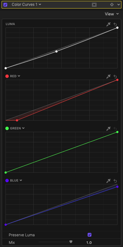

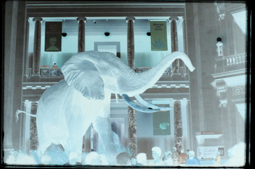

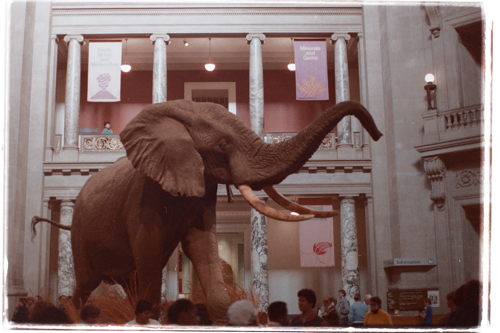

Jay60p Posted March 17, 2021 Share Posted March 17, 2021 On 2/17/2021 at 4:08 AM, UncleBobsPhotography said: I have "scanned" quite a lot of film with a macro-lens. In my opinion, it works great resolution wise. My main problem has been getting the colours right. I start with inverting the colour curves in lightroom and setting white balance on the base film colour, but it still takes a lot of fiddling with the RGB channels to get it right. One problem is that since the film base colour is so red, the temperature in lightroom maxes out at 2000K while I believe it should go even lower to get it correct. Anyone else has any tips on getting the colours right? Is there something like a "Portra 400 LUT" I could use which would correct the colours? Here are results from my 1st experimental 35mm full frame negative capture with an X-T3. From my years of shooting Kodachrome long before digital, I had color filters for adjusting daylight film to tungsten, and vice versa. I had noticed that the orange color of negatives was similar to two stacked #85b filters. 85’s are used to adjust tungsten balanced reversal films to sunlight. Therefore the logical correction for two 85’s would be two blue #80B filters stacked together, filters used for the opposite of 85’s - adjusting daylight balanced film for tungsten light. First, here is an old Nikon CoolscanV capture of the negative for reference: a casual shot in a museum on a family trip years ago. I wanted to see how close the X-T3 with 80B filters could match it’s color… I shot the negative on a daylight 5000K LED Lightbox, with two 80B blue filters under the negative. The X-T3 had a 50mm Fuji enlarger lens on bellows. White balance was at sunlight (5000K), ISO 200, 6K JPEG. My main question was - would double 80b filtering remove the orange to the extent that grading would not need to be drastic? (However I spent more time to get the settings in this camera for the best raw result for this particular negative for least amount of grading. I found that it needed a boost in contrast and color. I used Fuji’s Classic Chrome, color +4, dynamic range 100, Highlight and shadow tones +2, and exposed +2/3 stop brighter so the whites don’t get clipped. But no color shifts.) I reversed the negative to positive in GraphicConverter, and Imported into Final Cut Pro. I adjusted the color with curves, reduced red in the shadows and reduced blue in the highlights. Here’s X-T3 capture after final grading in FCPX: It doesn’t match the quality of the Nikon scanner, but better than I expected. (I have a binder full of plastic pages full of color negatives and the orange color among them can vary quite a bit, so grading could vary quite a bit.) The SOOC capture (JPEG) and inverse: Grading In Final Cut: My purpose for testing capturing negative is to prepare for digitizing my personal 16mm film, a frame at a time, using a Siemens projector being run off a geared down motor, similar to what I did with the Arri II for 35mm. That’s why I graded in FCPX. I can’t use the CoolscanV for that! P.S. I just looked online to see if other people are using blue filters. I found one person who suggested particular Cingel filters of colors similar to double 80b, here: https://photo.stackexchange.com/questions/70225/how-to-invert-color-negative-scan-via-dslr-without-clipping-the-red-channel However most other posts are suggesting using RAW image color grading, with varying techniques of removing the massive amount of orange after it is in the shot. I will be using JPEG files, RAW is not required if the orange is already filtered out. Link to comment Share on other sites More sharing options...
Jay60p Posted March 18, 2021 Share Posted March 18, 2021 Further testing shows two 80b filters are not needed, one should be enough to reach a white balance comfortably within reach of a digital camera. Find a blank frame or unexposed section of a negative film strip, and auto-white balance the orange out with with an 80A or 80B filter or gel between your light source and the film. One blue filter under a blank orange 35mm frame brings my camera’s white balance to about 3800K on my light box. Two filters bring it up around 5600K, and it will vary between different film types. After the orange is auto-balanced out, the actual color of the shot (emulsion) is left for grading. I was so used to seeing color negatives on orange masks that the bluish X-T3 results looked wrong. But I inverted a random bunch of photos to negative and found the overall bluish tone to be normal for my shots, orange areas show up only in deep blue areas such as blue skys. Link to comment Share on other sites More sharing options...
