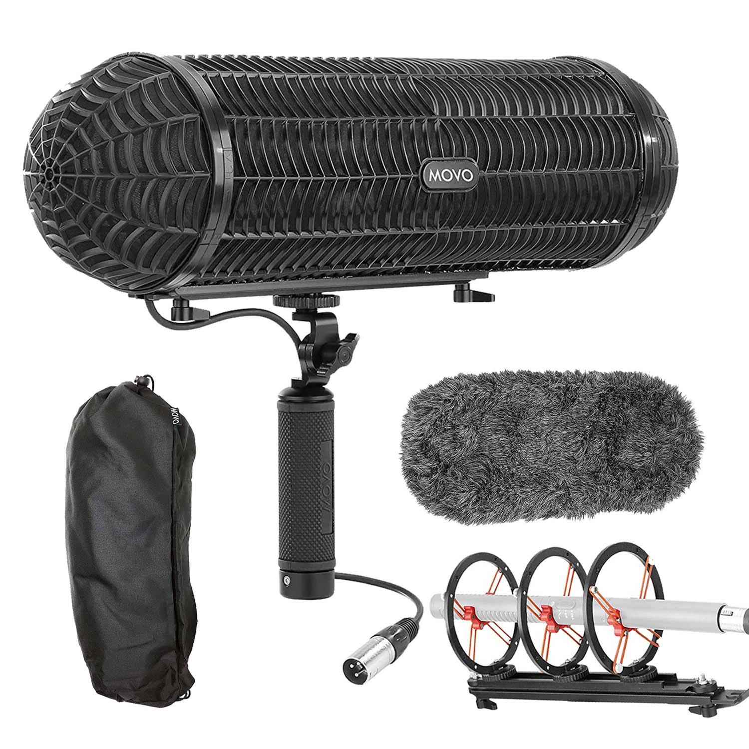

newfoundmass Posted March 23, 2020 Share Posted March 23, 2020 I've heard very good things about the Movo blimp. It's even cheaper than Rode! Link to comment Share on other sites More sharing options...

IronFilm Posted March 24, 2020 Share Posted March 24, 2020 14 hours ago, newfoundmass said: I've heard very good things about the Movo blimp. It's even cheaper than Rode! Keep in mind that absolutely NO audio professional specialist appear to have reviewed it. Not so much as a one paragraph review, let alone a detailed video review. So it is hard to judge if it is worthwhile, but by simply glancing at the product photos I'd already err in leaning towards shit rather than great But hey, it's also dirt dirt cheap, so for non-critical work, why not give it a punt? 13 hours ago, FranciscoB said: Unfortunately I'm not working with a sound team, it's just me with the mic and camera. Blimp is a no go. Thanks for the help. That's always going to be a tough ask then under windy conditions. Perhaps a lav with more extra wind protection? On camera mics are a shit approach anyway. Kisaha 1 Link to comment Share on other sites More sharing options...
