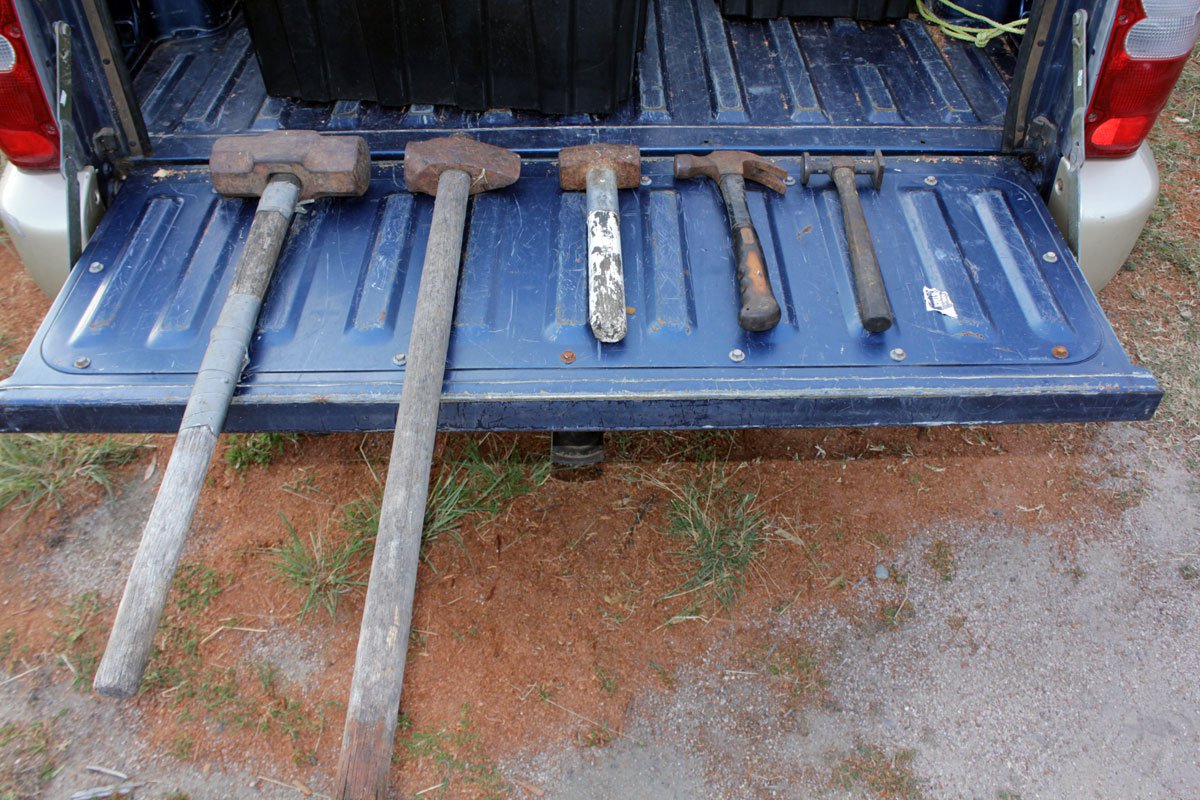

buggz Posted May 7, 2020 Share Posted May 7, 2020 On 5/4/2020 at 10:37 AM, BTM_Pix said: In my world, I refer to the hammer as a fine adjustment tool. A large and heavy "calibration instrument" is an R&D neccessity... BTM_Pix 1 Link to comment Share on other sites More sharing options...

kye Posted May 7, 2020 Share Posted May 7, 2020 4 hours ago, buggz said: A large and heavy "calibration instrument" is an R&D neccessity... The phrase that we used to use when I was an IT Support Monkey was "percussive maintenance". BTM_Pix, gt3rs and buggz 3 Link to comment Share on other sites More sharing options...
