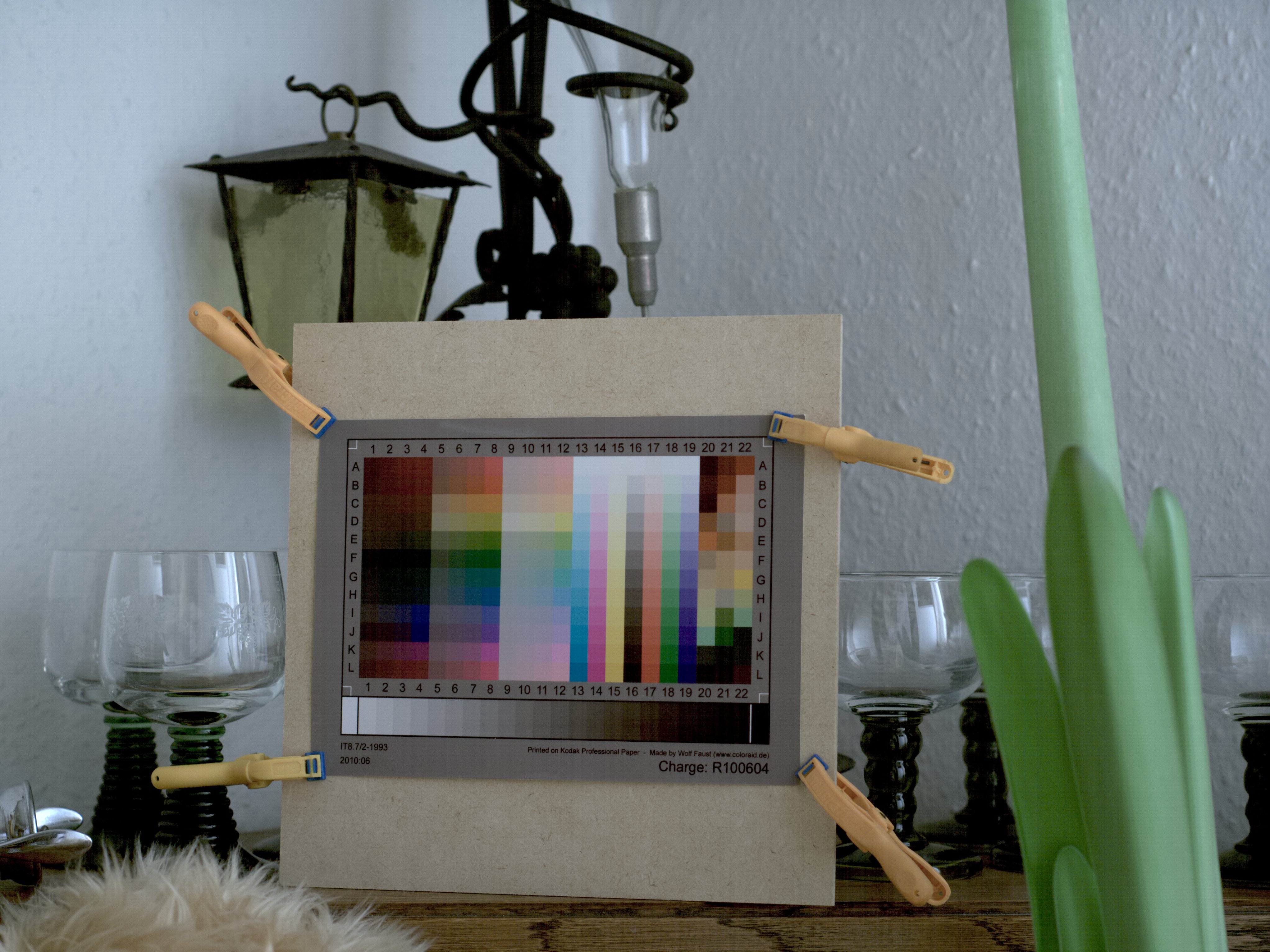

rawshooter Posted July 13, 2020 Share Posted July 13, 2020 On 5/26/2020 at 10:46 PM, Anaconda_ said: The .rgb file is raw data. I'd love to work out how to view this in a coherent way - or convert it into DNG frames. [...] https://www.dropbox.com/sh/seddezwwymwnh4v/AAAU5es-RCWOXCj1Fpkbz3Dba?dl=0 I'm wondering - did you shoot multiple frames/raw video, or just a single frame? PyDNG is able to extract a single DNG from your files (whether it's the .yuv or.rgb files), which looks like this when converted to JPEG in a Raw Converter (I used RawTherapee, with white balance correction and slight noise filtering): Link to comment Share on other sites More sharing options...
