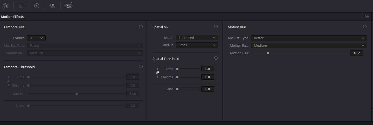

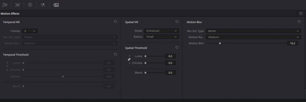

gt3rs Posted May 7, 2020 Share Posted May 7, 2020 5 hours ago, kye said: One thing that caught my eye recently was the idea of using a short SS, stabilising in post, then applying a fake motion blur to emulate a 180-shutter after the stabilisation has been done. I think for my work, which isn't for commercial purposes, that might simplify things quite a bit and might be good enough from a quality perspective. Of course, just holding the camera steady remains the best approach, if at all possible. I'm experimenting a bit like this using high SS and adding motion blur back as I have sometime the requirement to have photo and video at the same time. I also use remotes for photo but still would be nice to combine both so kind of compromise SS 1/250 or so... The motion estimation of Resolve is not too bad, is not like the real thing but it can fool non critical eyes. I also add motion blur for time shifts or with 360 camera where there are no NDs.... I did also experiment a bit using 5.5k 60 fps and slowing down in Resolve like it was done 120fps and not always but many times the result is much better than 1080p 120fps of the 1Dx The EIS in the 1Dx III with wide-angle lens and higher SS works quite well especially if you are not running around or so. Slowly moving works quite well but definitely not like on a Gimbal. kye 1 Link to comment Share on other sites More sharing options...

gt3rs Posted May 8, 2020 Share Posted May 8, 2020 I normally use 24 fps timeline (some time if is for tv 25 fps I'm a PAL country). I use the following settings: Motion Estimation always Better, Motion Ra... depends how big are movements so either small, medium or large and then I play with the Motion Blur slider until I find the spot that looks good. Again it will never be the same as real as some motion are very complex. I should try to do a repeatable test with 180° and one with 1/250 and 1/500 + motion blur in post. Link to comment Share on other sites More sharing options...
