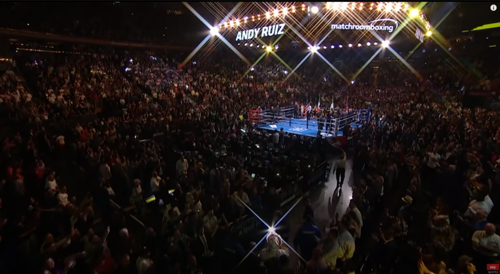

Inazuma Posted May 13, 2020 Share Posted May 13, 2020 Does anyone know if they use a particular type of lens or filter for this? kaylee 1 Link to comment Share on other sites More sharing options...
Super Members BTM_Pix Posted May 13, 2020 Super Members Share Posted May 13, 2020 16 minutes ago, Inazuma said: Does anyone know if they use a particular type of lens or filter for this? Its produced naturally (intentionally or otherwise) by refraction when using narrower apertures. You can buy filters such as this cheap and cheerful set which will create the effect without having to stop down. https://www.amazon.co.uk/Fotover-Filter-Pieces-Olympus-Cameras/dp/B07LF8KY4F newfoundmass and kaylee 2 Link to comment Share on other sites More sharing options...
Geoff CB Posted May 13, 2020 Share Posted May 13, 2020 This filter: https://www.adorama.com/tf77s4.html?gclsrc=aw.ds&gclid=CjwKCAjwte71BRBCEiwAU_V9h3OGvyjOFdz1IBFcjdhHidJnf9P_Om1vlLXwLgHyIwwT2ffArKGhpBoC7IEQAvD_BwE&utm_source=nmpi-google-dsa noone 1 Link to comment Share on other sites More sharing options...
FranciscoB Posted May 13, 2020 Share Posted May 13, 2020 I guess it's the effect that BTM_pix is talking about, only on a broadcast system with a 4 blade aperture lens. Link to comment Share on other sites More sharing options...
newfoundmass Posted May 13, 2020 Share Posted May 13, 2020 Yeah, stopping down is done both because the ring area is so bright compared to the rest of the venue and because for shots like that especially you want as much in focus as possible, since it shows how large the crowd is. That's the end result. Happens to me when doing wrestling events though it doesn't look nearly as cool because most events don't have that much lighting nor as many spectators, at least not the ones I film and produce! kaylee 1 Link to comment Share on other sites More sharing options...

Inazuma Posted May 15, 2020 Author Share Posted May 15, 2020 16 hours ago, newfoundmass said: You can achieve this with most lenses when stopping them down, even ones with more blades. On 5/13/2020 at 10:11 PM, newfoundmass said: Yeah, stopping down is done both because the ring area is so bright compared to the rest of the venue and because for shots like that especially you want as much in focus as possible, since it shows how large the crowd is. That's the end result. Happens to me when doing wrestling events though it doesn't look nearly as cool because most events don't have that much lighting nor as many spectators, at least not the ones I film and produce! The camera will have a small sensor and the focal lenth will be wide so I don't think you'd need to stop down to get achieve the desired depth of field. And for a small sensor you'd need to let in as much as light as you can otherwise the image would be grainy. Also you can only get 4 pointed stars with a lens that has 4 aperture blades.. and I've never heard of a lens with 4 blades. Link to comment Share on other sites More sharing options...
FranciscoB Posted May 15, 2020 Share Posted May 15, 2020 If you do a long exposure at night, with the lens stopped down, you'll get the star effect on most lights in the shot. That's just a consequence of stopping down the lens. If you open up the aperture, that effect will go away. If you need the light and open up the lens, then you'll need one of the filters mentioned above. That's it. Link to comment Share on other sites More sharing options...

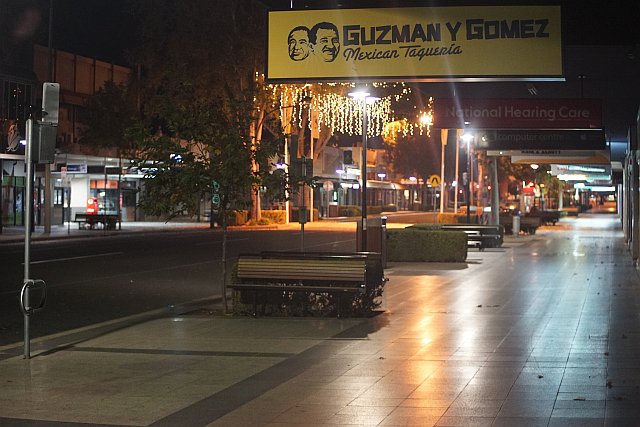

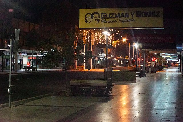

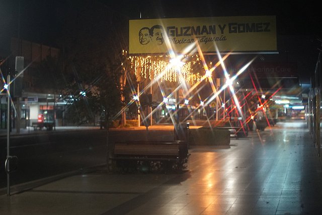

noone Posted May 15, 2020 Share Posted May 15, 2020 Ignoring how poor the photos are (this old 70-150mm lens is very ordinary, I can take it back and get my money back but better to not let it back out in the wild again). The filter looks a lot better on a 50mm lens but I do not have any anymore (will get a cheap one soon i guess). Near wide open with filter, without and stopped down without at 70mm. By rotating the front ring of the filter it effectively changes from four rays to two (it is freezing out so I just went out my front door for minute or so). leslie and FranciscoB 1 1 Link to comment Share on other sites More sharing options...
