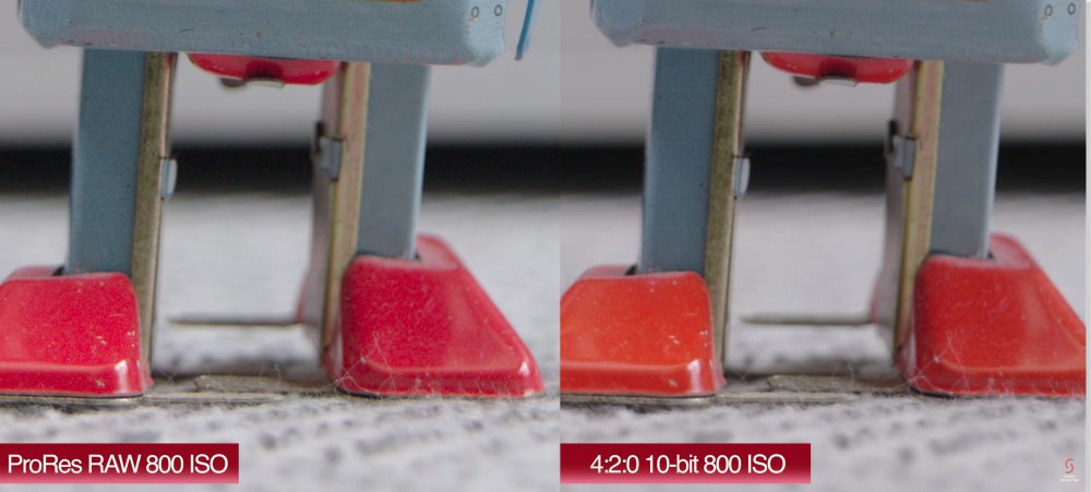

TheBoogieKnight Posted May 22, 2020 Share Posted May 22, 2020 One thing I don't get (and I've seen it on a few videos recently) is how the S1/S1H render some reds as a vivid orange, but only certain shades (other reds don't get affected at all). It doesn't look like it's sensor related as a recent test with RAW showed the effect vanished! One's the Pocket 6k, the other the S1H. PannySVHS 1 Link to comment Share on other sites More sharing options...
TheBoogieKnight Posted May 22, 2020 Share Posted May 22, 2020 There's the video comparing RAW recording. Link to comment Share on other sites More sharing options...
MeanRevert Posted May 22, 2020 Share Posted May 22, 2020 2 minutes ago, TheBoogieKnight said: There's the video comparing RAW recording. Pretty obvious that there's a big quality jump. I think you have to use an external recorded though. And what is the file size difference between the 2? Link to comment Share on other sites More sharing options...
Lux Shots Posted May 23, 2020 Share Posted May 23, 2020 12 hours ago, MeanRevert said: Thanks so much! I see a slight difference btw the 8-bit 60p and 10-bit 24p although I didn't see much difference between the H264 and H265. This does help me making a decision so I'm starting to lean towards that S1 now. I'd like to hear more about that firmware upgrade people are talking about now.. The internal 4K 60p of the S1H is in 10-bit, not 8-bit. This is a big deal with a harder grade. 8 hours ago, TheBoogieKnight said: One thing I don't get (and I've seen it on a few videos recently) is how the S1/S1H render some reds as a vivid orange, but only certain shades (other reds don't get affected at all). It doesn't look like it's sensor related as a recent test with RAW showed the effect vanished! One's the Pocket 6k, the other the S1H. I AM ALSO HAVING ISSUES WITH REDS FROM THE S1H!!!! The damn thing almost looks like its super neon when doing stills with the slightest bump in saturation. Link to comment Share on other sites More sharing options...
deezid Posted May 23, 2020 Share Posted May 23, 2020 14 hours ago, TheBoogieKnight said: One thing I don't get (and I've seen it on a few videos recently) is how the S1/S1H render some reds as a vivid orange, but only certain shades (other reds don't get affected at all). It doesn't look like it's sensor related as a recent test with RAW showed the effect vanished! One's the Pocket 6k, the other the S1H. Did you use the official Lut? Usually it actually shifts towards the magenta side. Only explanation I have is you didn't convert to Rec709 properly. 14 hours ago, TheBoogieKnight said: One thing I don't get (and I've seen it on a few videos recently) is how the S1/S1H render some reds as a vivid orange, but only certain shades (other reds don't get affected at all). It doesn't look like it's sensor related as a recent test with RAW showed the effect vanished! One's the Pocket 6k, the other the S1H. Did you use the official Lut? Usually it actually shifts towards the magenta side. Only explanation I have is you didn't convert to Rec709 properly. Link to comment Share on other sites More sharing options...
