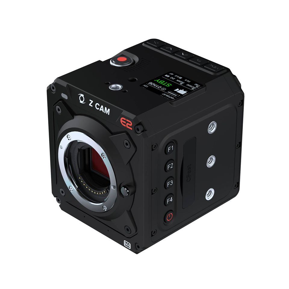

IronFilm Posted May 25, 2020 Share Posted May 25, 2020 Z CAM E2-M4 @USD1,499 - Basically same as Z CAM E2 but without sync feature. - Exterior design same as Z CAM E2 Flagship Series. - Interchangeable MFT lens mount in standard package. - Optional interchangeable EF, PL and M mount. - Shipment will start first week of June. Z CAM E2 - the only model that supports multi-cam sync feature. - Price USD1,999 remains unchanged. Z CAM E2-S6 - Price changed from USD2,995 to USD2,499 Z CAM E2-F6 - Price changed from USD4,995 to USD3,999 All Z CAM E2 series will soon support direct RTMP, RTMPS and SRT live streaming, including but not limited to Facebook and YouTube, without going through a computer. With that price drop, I think the Z Cam E2 M4 is now more appealing than the BMPCC4K which is now only marginally cheaper. andrgl, heart0less and KnightsFan 3 Link to comment Share on other sites More sharing options...

Administrators Andrew Reid Posted May 25, 2020 Administrators Share Posted May 25, 2020 4 hours ago, IronFilm said: Z CAM E2-M4 @USD1,499 - Basically same as Z CAM E2 but without sync feature. - Exterior design same as Z CAM E2 Flagship Series. - Interchangeable MFT lens mount in standard package. - Optional interchangeable EF, PL and M mount. - Shipment will start first week of June. Cheaper than an X-T3 at launch. 4 hours ago, IronFilm said: Z CAM E2-S6 - Price changed from USD2,995 to USD2,499 Bargain alert! Much more capable specs than the Pocket 6K. 4 hours ago, IronFilm said: Z CAM E2-F6 - Price changed from USD4,995 to USD3,999 With that price drop, I think the Z Cam E2 M4 is now more appealing than the BMPCC4K which is now only marginally cheaper. Don't forget the cost of the screen and cage though. tweak 1 Link to comment Share on other sites More sharing options...
