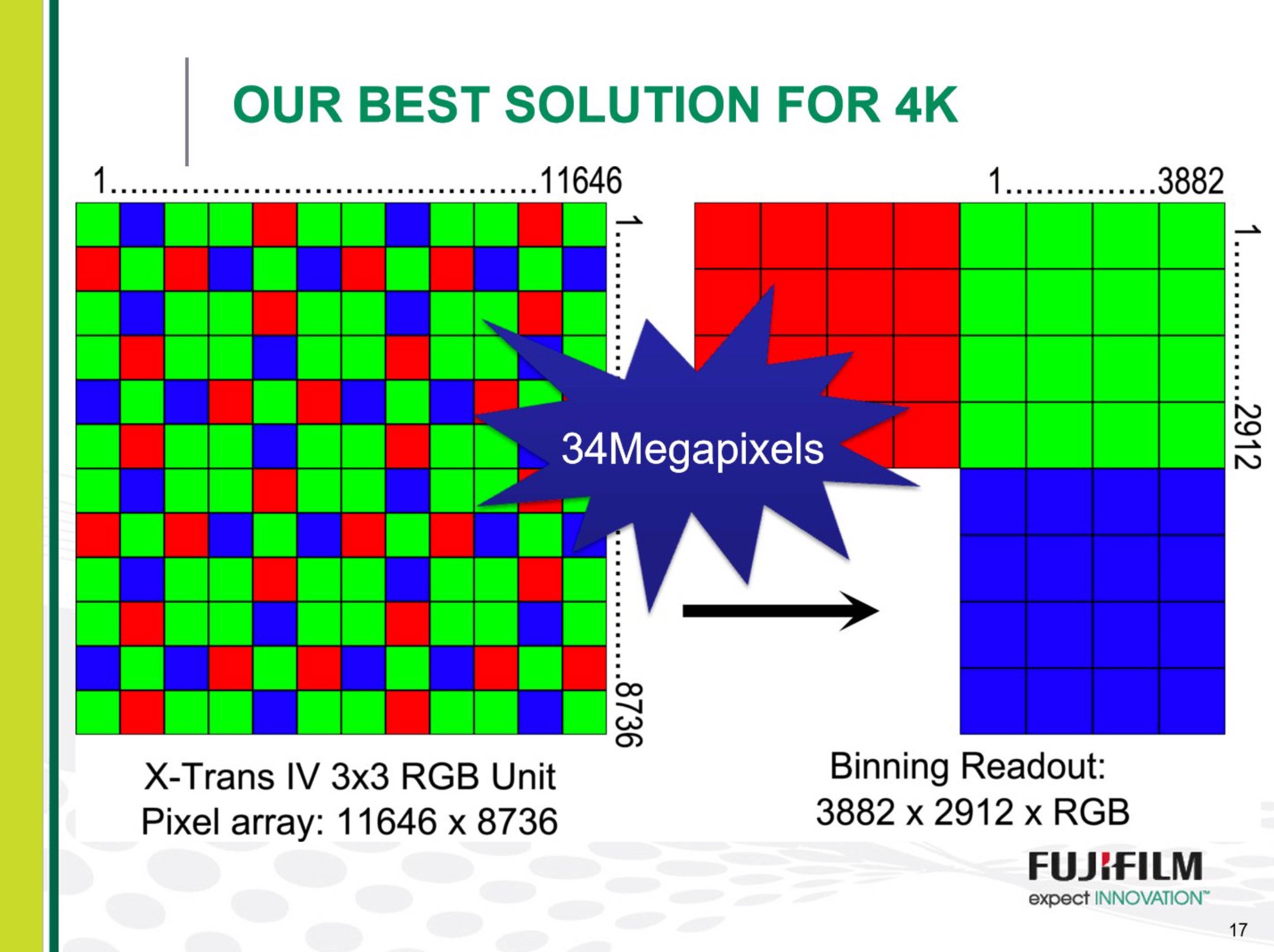

androidlad Posted July 1, 2020 Share Posted July 1, 2020 4 hours ago, Caleb Genheimer said: The complete non-starter issue for me on all these external RAW updates over HDMI is the fact that it’s always C4K or 16:9. What’s the heckin point of a “medium format” or “full frame” RAW camera if I can’t even use the FULL frame? #anamorphicproblems Seriously though, I want to use the full sensor height. Anything else is just infuriating. I assume it’s some limitation of the HDMI hardware, either the camera’s output, the signal format, or the Atmos’ input, but that doesn’t make it less frustrating. When there’s a camera that can shoot RAW and be speedboosted into IMAX 15/70 territory, I’ll be there with bells on. Until then, my GH5S and Blackmagic Pocket 4K will tide me over just fine. It requires far more aggressive line-skipping to readout the full height of the sensor which is 8736 pixels. Currently GFX100 uses 2/3 subsampling vertically to derive a 4352 pixel Bayer from a 6528 pixel height, and that already saturated the maximum readout time of 32ms required to achieve 30fps video frame rate. Link to comment Share on other sites More sharing options...

Administrators Andrew Reid Posted July 1, 2020 Author Administrators Share Posted July 1, 2020 5 hours ago, androidlad said: It requires far more aggressive line-skipping to readout the full height of the sensor which is 8736 pixels. Currently GFX100 uses 2/3 subsampling vertically to derive a 4352 pixel Bayer from a 6528 pixel height, and that already saturated the maximum readout time of 32ms required to achieve 30fps video frame rate. https://www.eoshd.com/news/fujifilm-hint-at-44x33-large-format-gfx-h100-filmmakers-camera-open-gate-4k3k/ What 100MP quad bayer capable sensor were Fuji referring to in this document (if not the GFX 100)? It doesn't look like the GFX 100 actually employs this readout method. So is this something they are saving for a future camera? Link to comment Share on other sites More sharing options...
androidlad Posted July 1, 2020 Share Posted July 1, 2020 4 hours ago, Andrew Reid said: https://www.eoshd.com/news/fujifilm-hint-at-44x33-large-format-gfx-h100-filmmakers-camera-open-gate-4k3k/ What 100MP quad bayer capable sensor were Fuji referring to in this document (if not the GFX 100)? It doesn't look like the GFX 100 actually employs this readout method. So is this something they are saving for a future camera? That's their 100MP X-Trans project that has since been shelved. Link to comment Share on other sites More sharing options...
