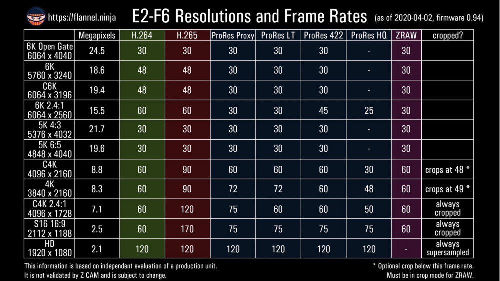

I'm a current Sony A7III & 1.5x aivascope shooter and wanted to ask if there is a "need" for an anamorphic lenses on camera's that have a 2.4:1 shooting resolution mode like the ZCAM E2F6.  6K 2.4:1 6064 x 2560 / C4K 2.4:1 4096x1728.  Although one will not get the characteristics of anamorphic. Is there a benefit to such resolutions?

and wanted to ask if there is a "need" for an anamorphic lenses on camera's that have a 2.4:1 shooting resolution mode like the ZCAM E2F6.   Although one will not get the characteristics of anamorphic.
Well, you answered your own question - those modes allow you to get a widescreen aspect ratio, but without an anamorphic look.
Surely, there are benefits to this - if you plan on delivering the final image in 2.4:1, then you don't waste storage space and processing power on pixels you won't use.
But at the same time - if you wanted to do some re-framing in post, add some head room, etc. then you're out of luck, because there is no data there.
I'd rather be on the safe side and shoot at 16:9 with 2.4:1 framing in mind and then crop it in post.
And, as you can see from the chart, those widescreen aspect ratios let you record a bit higher FPS video.
C4K in 2.4:1 goes up to 120 FPS in H265, whereas "normal" C4K allows 'only' 90 FPS.
If you really want to take use this sensor to its full potential, then you'd shoot 6K Open Gate and put some anamorphic glass in front.
Even your Aiva would do.
After desqueezing this setup would roughly give you a 2:1 image, which is a Netflix standard.
Pretty neat.

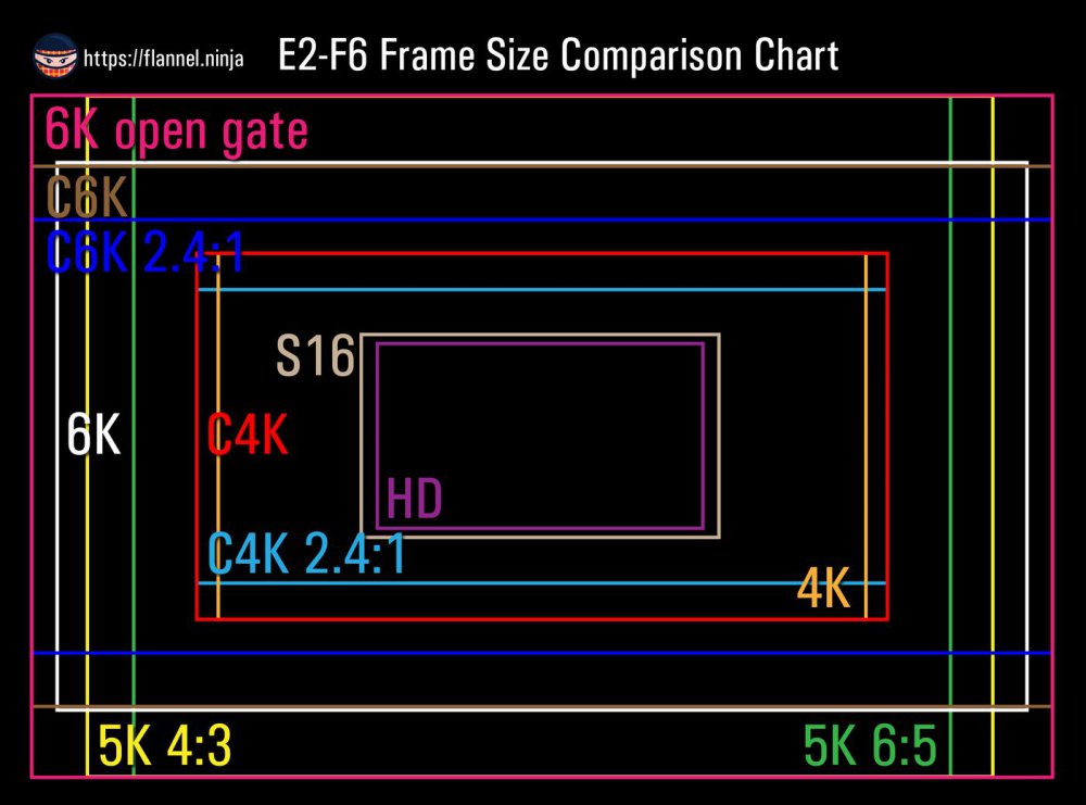

Here is a sample of the Sensor Resolution Ratios
