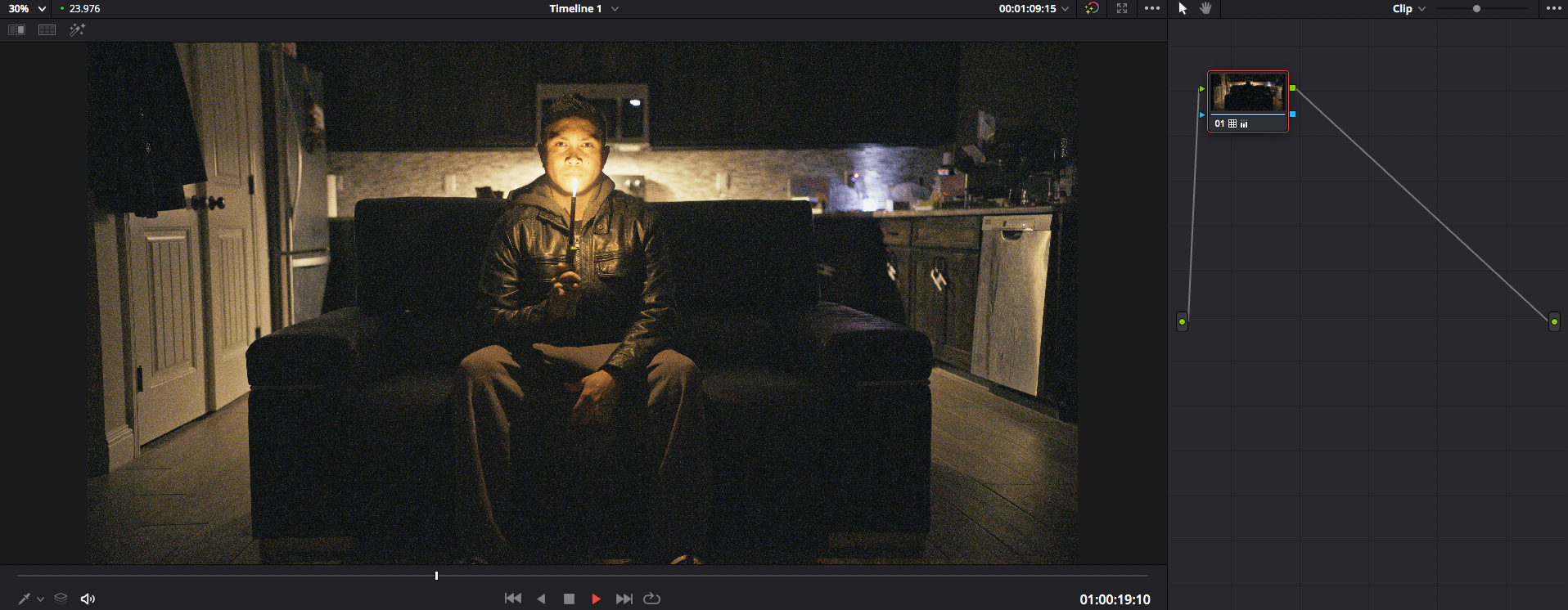

gt3rs Posted June 3, 2020 Share Posted June 3, 2020 2 minutes ago, Snowbro said: I have had some issues in Resolve with RAW files, I tried all the obvious things like making sure CUDA is enabled and force enabling GPU for decoding etc. None of that really did too much, then I did the clunky smart rendering stuff and manually optimizing the clips, which worked, but it redundantly made me lose tons of SSD space to do it. The solution I found: I just turned off the smart or selected rendering, did not optimize clips. Made a new project, threw clips into its native res timeline and turned on fusion memory cache. Then I would just hit play on the timeline, it would still be lower fps, but after it went through it once, it plays back smoothly every time, even with heavy color grading etc. I found that this is the only way I can get my computer to actually start utilizing more of my CPU/GPU power in Resolve for some reason. I don't know why this works, but it does for me, give it a go. RAW are 100% "decoded" and debayerd in CPU as far as I know, the grading is applied by the CUDA. h264 and h265 are decoded in the CUDA GPU but not the 10bit 4:2:2 only 10bit 4:2:0.... this is why 1Dx III LOG file are even more demanding on the CPU than RAW.... 20xx Nvidia can also HW decode h265 4:4:4 but apparently not 4:2:2 Link to comment Share on other sites More sharing options...

Stathman Posted June 3, 2020 Share Posted June 3, 2020 No problem here. It plays smoothly with a lut applied and some basic adjustments (4K DCI timeline). macOS 10.13.6 - i7 8700K - 1080Ti Resolve 16.2.2 Maybe bad hackintosh configuration? Resolve version? *edit: - This is true when using metal GPU processing mode. I tried with OpenCL and I get 8-11fps maximum. gt3rs 1 Link to comment Share on other sites More sharing options...
Administrators Andrew Reid Posted June 3, 2020 Author Administrators Share Posted June 3, 2020 I get better performance with OpenCL than Metal, so it's the other way round. Running Mojave. Hackintosh is working flawlessly. Resolve 16.2 Can't figure it out at all yet. Link to comment Share on other sites More sharing options...
Stathman Posted June 3, 2020 Share Posted June 3, 2020 Latest versions of Resolve are optimised for Metal on macOS. I suspect this is the case. Do you have any utility to check gpu usage while playback? Try to disable igpu in bios to see if it makes any difference. Link to comment Share on other sites More sharing options...
Administrators Andrew Reid Posted June 4, 2020 Author Administrators Share Posted June 4, 2020 I see where the FPS shows up now. It is around 7fps with Metal. Real-time 24fps / 25fps with OpenCL. So the problem is Metal. Not the only problem mind you - there is the H.265 / Fuji shadow clipping issues that make all the files look like trash! Definitely all needs to be looked into by Blackmagic. Link to comment Share on other sites More sharing options...
