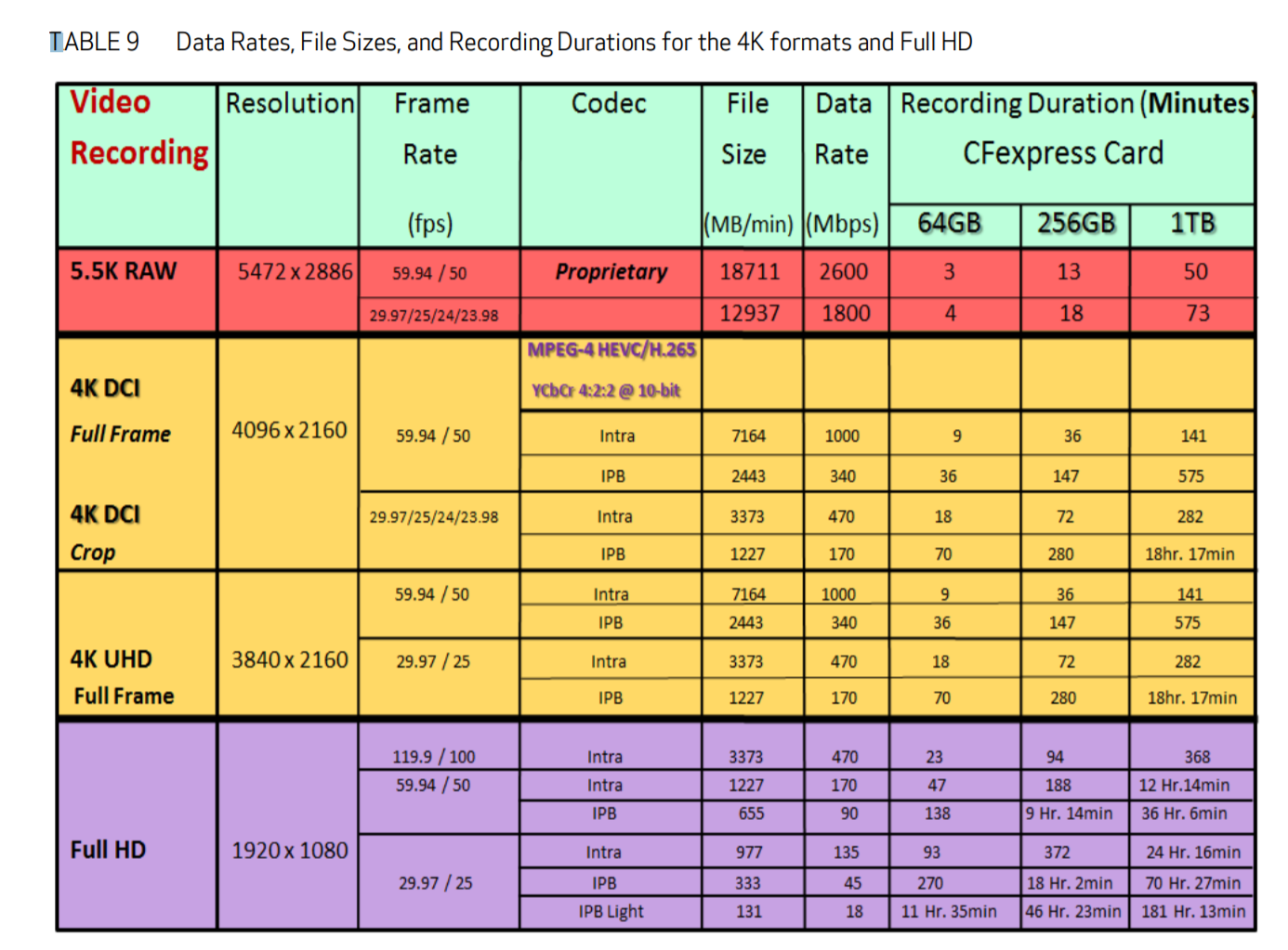

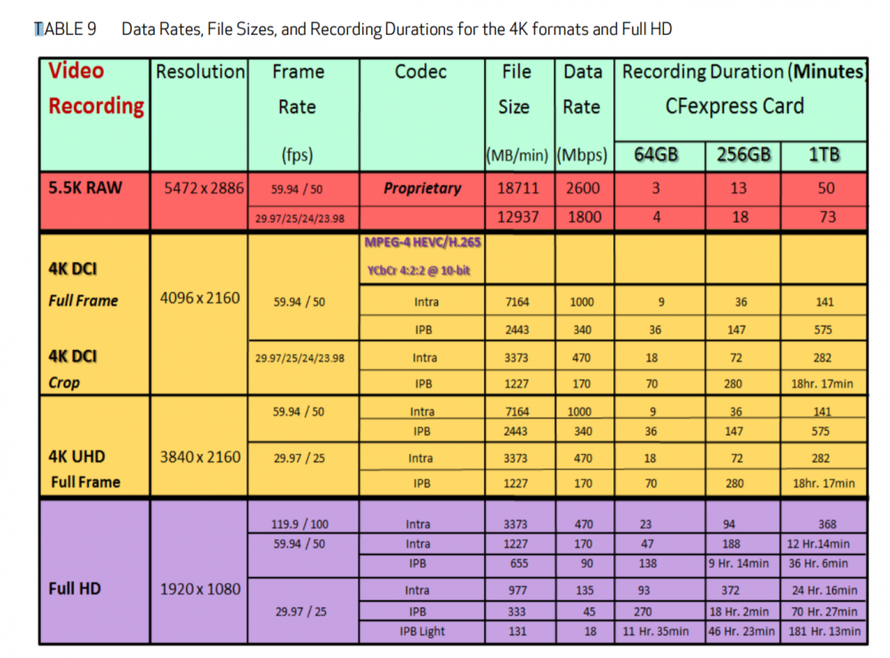

gt3rs Posted June 5, 2020 Share Posted June 5, 2020 48 minutes ago, Andrew Reid said: 230Mbit in 4K/60p 10bit? Don't think so. In 24p maybe, but then you have the rolling shutter to contend with. I took the wrong table 😒 Rolling shutter in crop mode is the same or very similar if not 100% identical between 24fps and 60fps try yourself and you will see So with the right table 4k DCI 1.33 crop 24 fps w2ill be 170 Mbits and 340 Mbits at 60 fps . Link to comment Share on other sites More sharing options...
