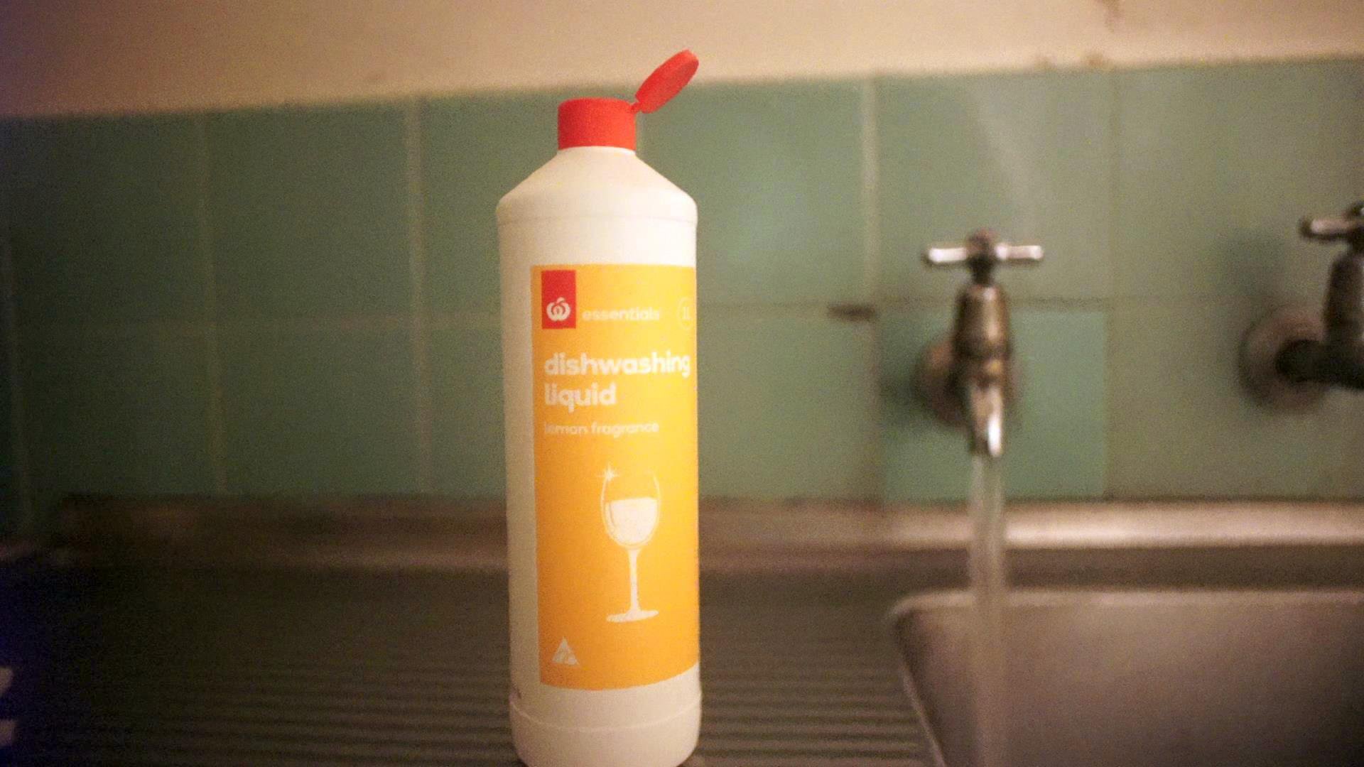

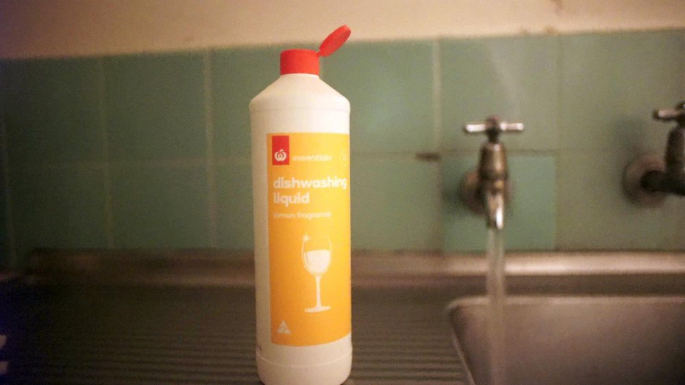

Snowfun Posted June 2, 2020 Author Share Posted June 2, 2020 I film the aurora borealis so everything else is secondary to low light performance. I have used a P4k at iso 25k and 6fps 360 degrees and the images are good but they are timelapse and in that sense inferior to those from my A7S (which I stupidly sold anticipating the A7S3 last year). (P4K) (A7S) Yes, I’d like to improve 101 things about the Sony but if it still has the best low light performance then those things can be overlooked. heart0less, noone and kye 3 Quote Link to comment Share on other sites More sharing options...
