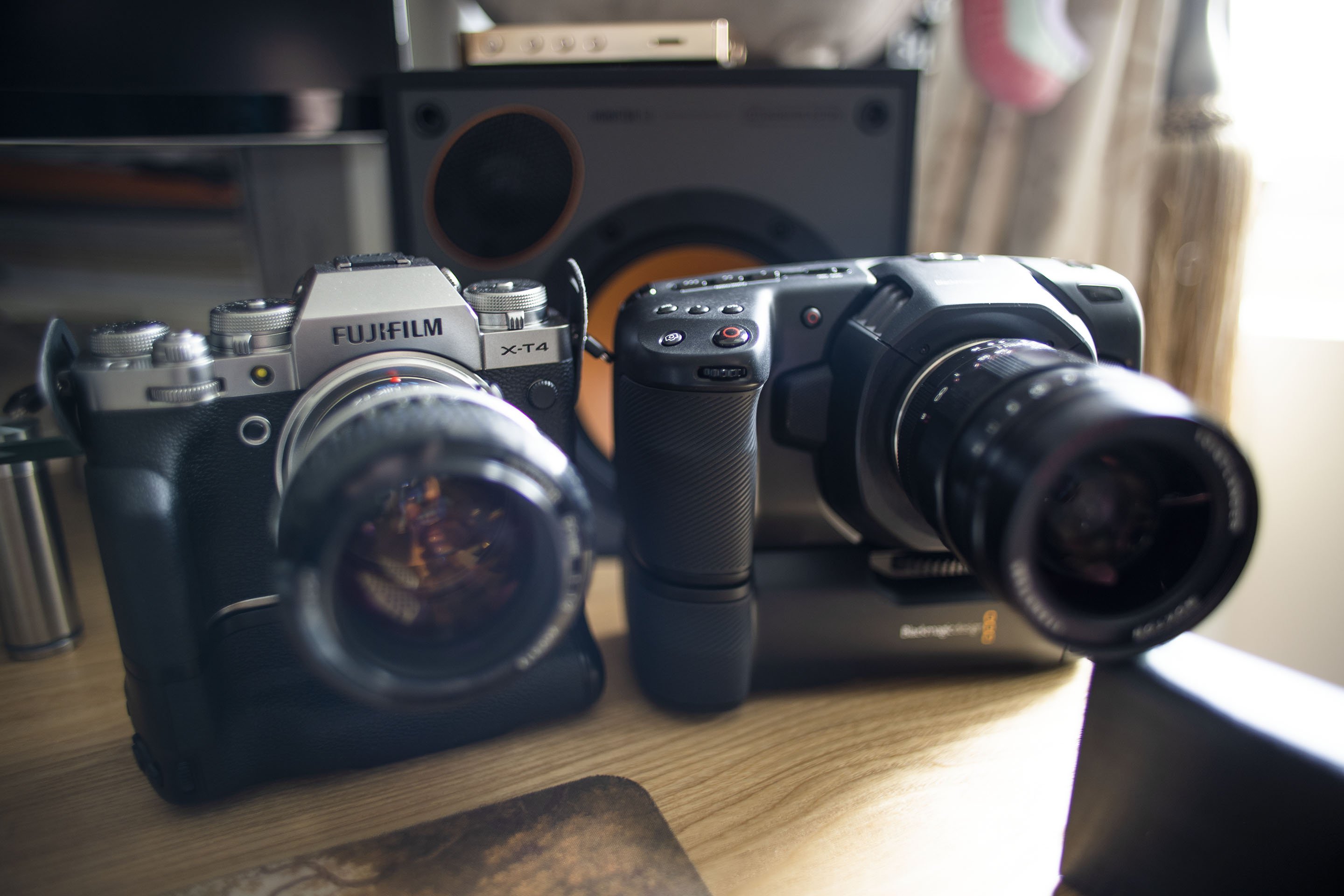

Administrators Andrew Reid Posted June 4, 2020 Administrators Share Posted June 4, 2020 Found one on eBay for £200 so thought I'd give it a go. Got the rusty potato out for a test shoot versus the X-T4. The Voigtlander 17.5mm F0.95 is really nice on it. Did I miss any firmware updates on the Pocket 4K since I last bothered with it? JordanWright and billdoubleu 2 Link to comment Share on other sites More sharing options...

Administrators Andrew Reid Posted June 4, 2020 Author Administrators Share Posted June 4, 2020 The first thing I am filming is to do a codec test vs the latest 10bit LOG cameras like X-T4 and to figure out whether the codec in the Blackmagic is actually worth losing so much other functionality for. Kisaha 1 Link to comment Share on other sites More sharing options...
