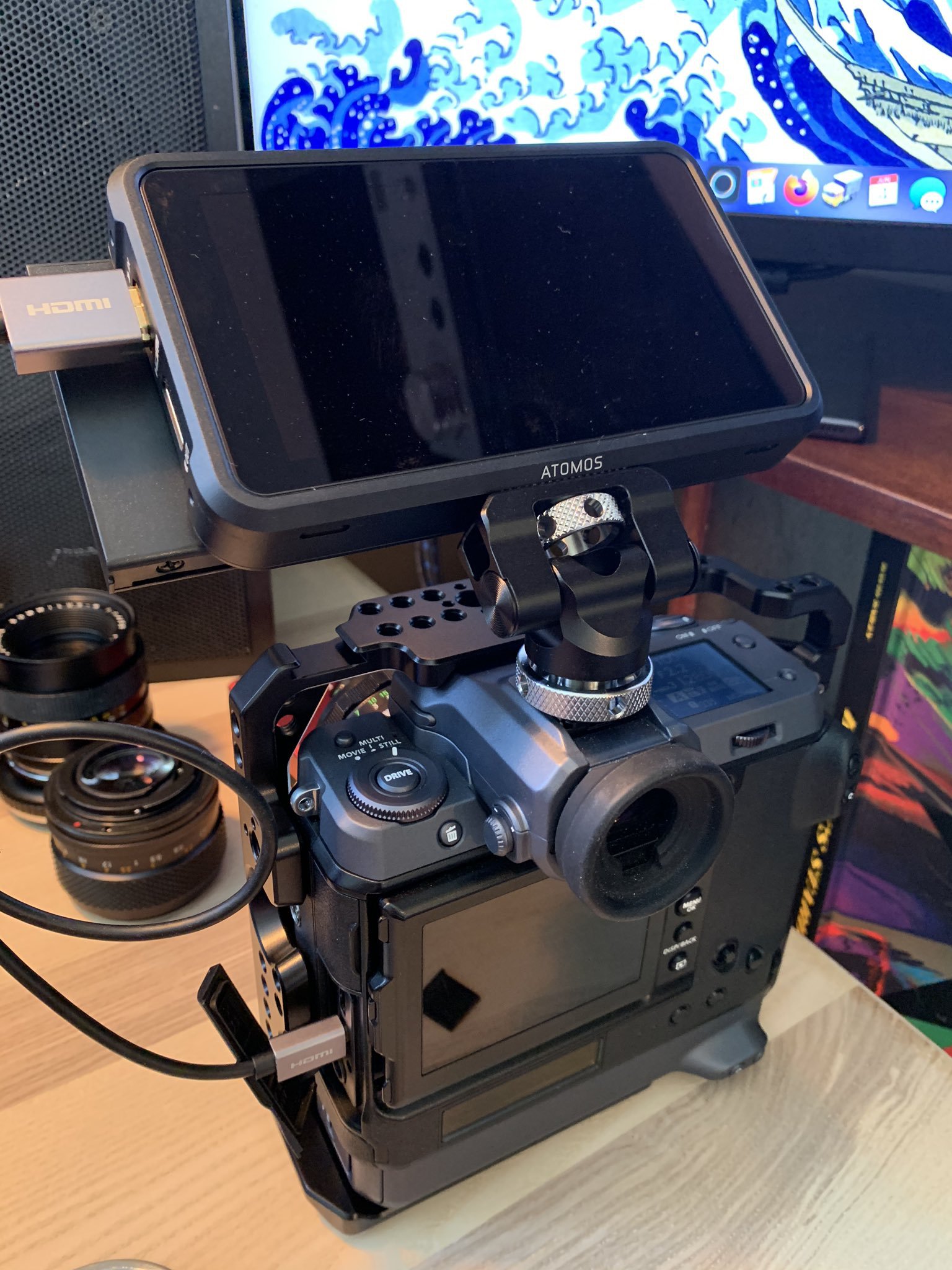

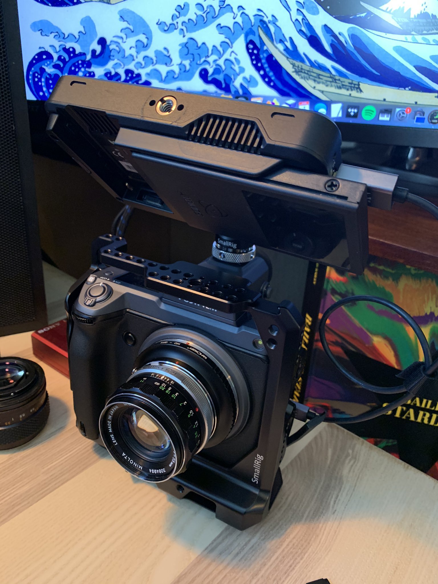

Administrators Andrew Reid Posted June 4, 2020 Administrators Share Posted June 4, 2020 Never been the huge fan of external monitors or HDMI cables that everyone else seems to be Well I have changed my mind. It's a U-turn bigger than any Boris-led government is capable of. It's hypocrisy of the highest order. But it just feels so much better balanced on a larger, heavier camera than it does on a small mirrorless camera. The cage is excellent as well (SmallRig). Very generous to charge £120 for a cage that fits a $10,000 camera. LockCircle would have changed $20,000. If only they would route the video feed up through the smart hot-shoe like they do for the EVF. Cable is ZILR, by an ex-Atomos Brooke-Benton Smith. Monitor mount is also SmallRig. That bit was £35. It's a pity the camera wasn't £35. But this is a 5 year investment for me... Can't see there being much like this coming out! Now to test the ProRes.... buggz 1 Link to comment Share on other sites More sharing options...

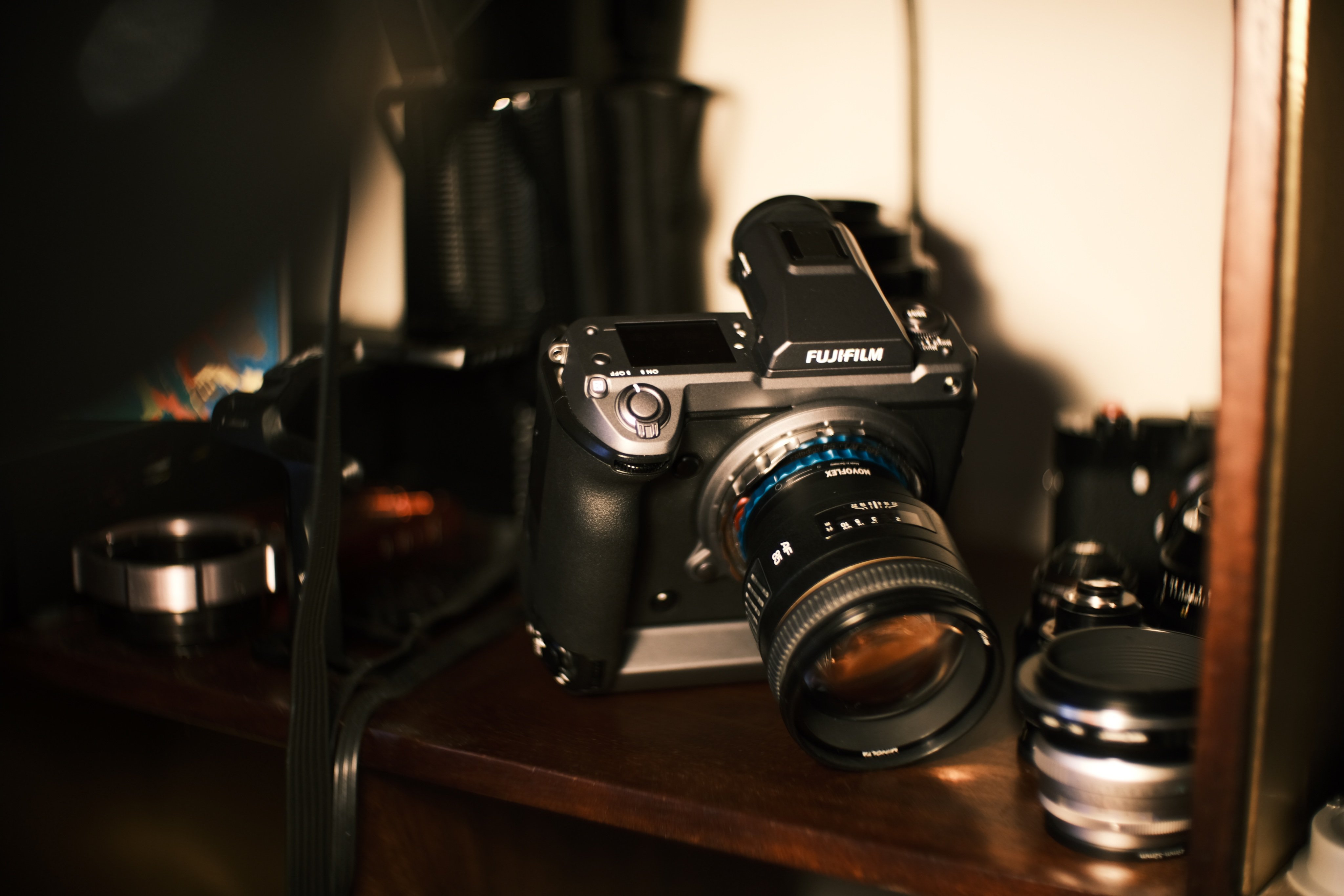

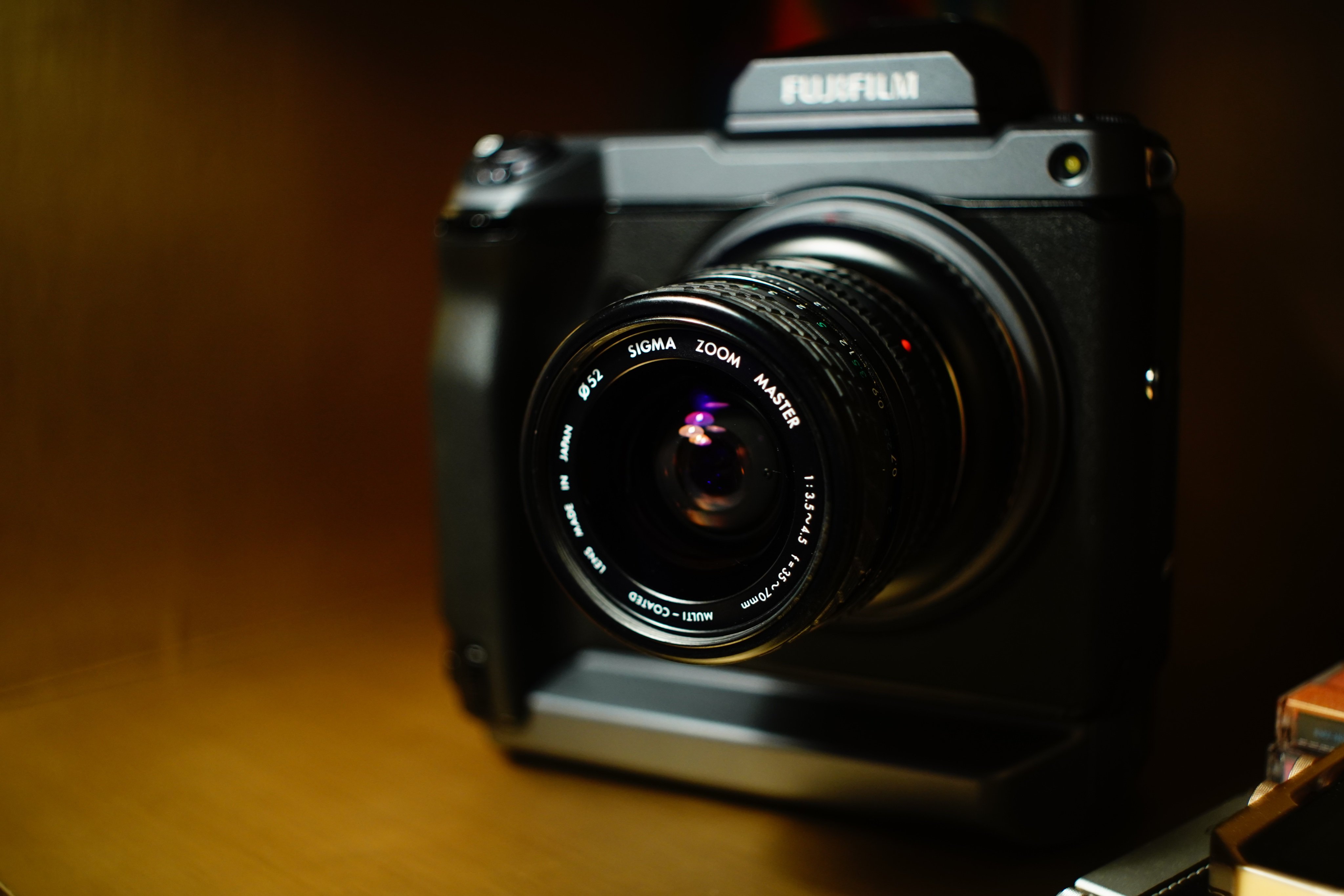

Administrators Andrew Reid Posted June 4, 2020 Author Administrators Share Posted June 4, 2020 Here is the ZOOM MASTER! No vignette. Here is the Minolta A mount 85mm F1.4. Truly beautiful with the larger sensor. In full frame terms, the image is a 68mm F1.1 with that. If we really want to get into Kubrick NASA territory though we pop the Canon FD 85mm F1.2L on there. 68mm F0.95 I think I have that right anyway. * 0.8x vs full frame?! Or is it even larger? (44 x 33) 5 minutes ago, PannySVHS said: Now, for the next five years you might wanna buy that kippon speedbooster from fuji to Pentax 645 for the ultimate medium format look, giving you approximately 60mm equivalent of sensor width and 46mm in height. Thats 645 digital medium format for the next five years!:) Oh yeah forgot about that. I want one! However the fast sensors on medium format compared to P645 glass really give you the "even larger" sensor look anyway. F4 on speed booster on 44 x 33 or full frame F1.2 on 44 x 33? The F1.2 would look more 3D I think. noone 1 Link to comment Share on other sites More sharing options...
PannySVHS Posted June 4, 2020 Share Posted June 4, 2020 f2.8 on speedbooster on 44x33 I would assume. More creamyness possibly due to lens construction and glass. Flickr might provide some great examples. I don´t know if there are third party lenses as well for the Pentax 645 mount. FOV of a 45mm 2.8 would be around 26mm eq. to 35mm FF, DOF eq. of 1.6. Summarized: the 45mm F2.8 on a 645 sensor gives an image like a 26mm f1.6 on 35mm FF. Maybe with tastier attributes and image though. https://en.wikipedia.org/wiki/Pentax_645#Lenses Alternative would be the Mamiya focal reducer. That way you could put a 80mm 1.9 on there giving you the eq. of 0.81 x 0.71 x 80mm = 46mm, with 1.1 DOF. Link to comment Share on other sites More sharing options...
Administrators Andrew Reid Posted June 4, 2020 Author Administrators Share Posted June 4, 2020 Something like the Pentax 67 105mm F2.4 would be very nice on the Kipon speed booster, but you are still a bit limited in terms of choice of glass compared to all the full frame stuff. 85mm F1.4 tends to cover the 44 x 33 very well and with edge to edge sharpness at F2.0 So there is a limit to what the Speed Booster can do to better that. I'm still keen to give one a try though. How much are they? Link to comment Share on other sites More sharing options...
PannySVHS Posted June 4, 2020 Share Posted June 4, 2020 @Andrew Reid 700 each, the Mamiya and the Pentax one. 105mm Pentax sounds like a legendary lens, since there is quiet a bit of legendary glass above 80mm focal length. I might surf flickr a bit now and my evening of lens nerdery is perfect. Just look at the images on Flickr and get a feel for the different lenses, Andrew. Not trying to sound patronizing, just cheering.:) It is way more than just simple math as we know. Link to comment Share on other sites More sharing options...
Alpicat Posted June 4, 2020 Share Posted June 4, 2020 2 hours ago, PannySVHS said: Alternative would be the Mamiya focal reducer. That way you could put a 80mm 1.9 on there giving you the eq. of 0.81 x 0.71 x 80mm = 46mm, with 1.1 DOF. I have the Mamiya 645 Kipon focal reducer for the S1H and the 80mm at f1.9 it's a bit soft and the image seems to glow a bit. I think that might possibly be an issue with the speedbooster not being able to handle fast apertures, rather than the lens. I heard someone else who had the same issue with this combination. You can very briefly see this in the video I shot below, at the 1:20 mins mark, when I open up the aperture to max for a second. It's more noticeable in bright conditions than in low light. f2.8 it's fine though - even around f2.4 it's ok. 44 minutes ago, Andrew Reid said: I'm still keen to give one a try though. How much are they? Can't find the Pentax 67 one, but with the Mamiya and Contax ones, linked below, you can add an additional adapter to mount Pentax 67 lenses (and also have the option to use 645 lenses) so it's probably a more versatile option? GFX to Mamiya 645: https://www.ebay.co.uk/itm/Kipon-Adapter-Focal-Reducer-Speedbooster-for-Mamiya-645-Lens-to-Fuji-GFX-Camera-/122599541498 GFX to Contax 645: https://www.ebay.co.uk/itm/Kipon-Adapter-Focal-Reducer-Speedbooster-for-Contax-645-Lens-to-Fuji-GFX-Camera/333350155153 You may get vignetting on some lenses if using this with the GFX due to speedbooster limitations, however I may be wrong. Alternatively Metabones make a speedbooster for the GFX which definitely won't vignette, but it only takes Hasselblad lenses: https://www.metabones.com/products/details/MB_SPHV-FG-BM1 heart0less and billdoubleu 1 1 Link to comment Share on other sites More sharing options...
Administrators Andrew Reid Posted June 4, 2020 Author Administrators Share Posted June 4, 2020 Pentax 67 adapts to Pentax 645 so you just buy that adapter tube, and stick it on the Kipon speed booster. So there is the Kipon full frame one for S1 and Nikon Z6... I have the Nikon version from them. And there is the monstrous GFX speed booster for Pentax medium format lenses too And that's the one I want next Kipon doing an amazingly wide range of adapters at the moment. Alpicat 1 Link to comment Share on other sites More sharing options...
