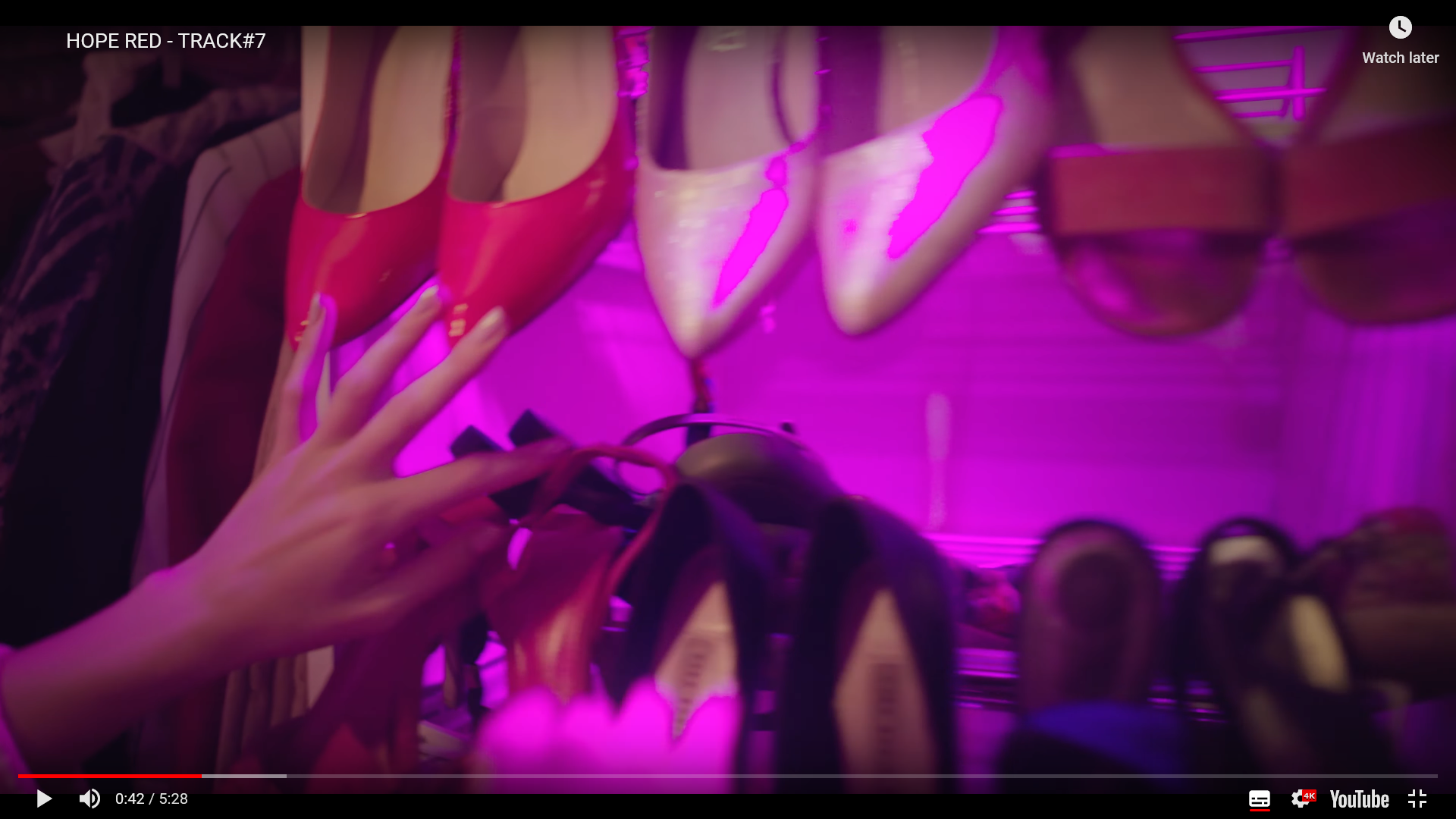

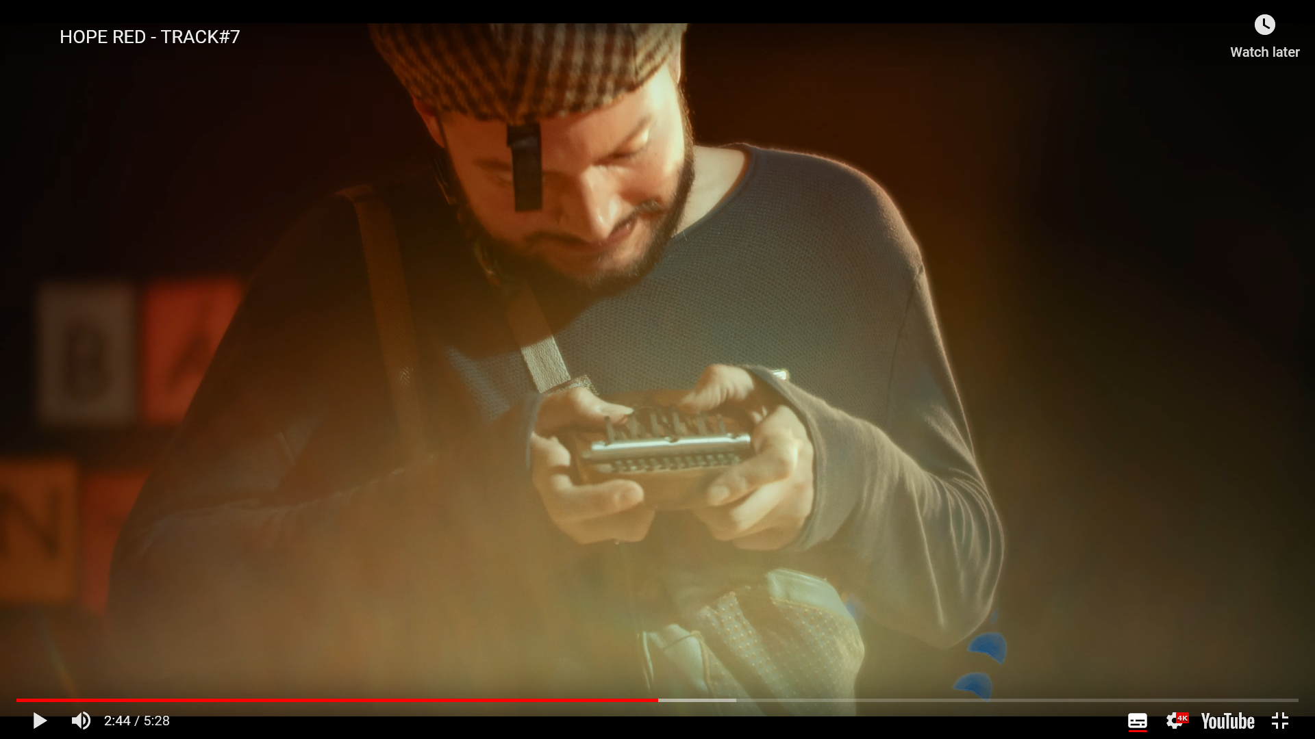

heart0less Posted June 23, 2020 Share Posted June 23, 2020 Congrats! This is a solid piece. I really liked the tune and I think the visuals matched it very well. Kudos for being able to uphold it for over 5 minutes without making it repetitive and boring. Cross-cutting definitely helped. Regarding lighting: in my opinion it's on point, wouldn't change anything myself. Stage lighting might be quite harsh, but this makes it believable and solid. Grading looks awesome. Beautifully enhances your set production. Though I noticed some small issues with clipped colors, like those blue blobs and pink highlights: You mentioned using Resolve, so I can wholeheartedly recommend adding a node at the end with 'Gamut Limiter' Effect (it's a built-in effect). It should fix it. Another thing that didn't quite match my taste was overall sharpness. The footage looks like you added a tiny bit too much digital sharpening to it. It's especially visible during the opening shot in the plastic wrap you used to secure the mic boom. IMHO, a soft look would nicely complement the tone you set. Once again: great work and thanks for sharing! funkyou86 1 Link to comment Share on other sites More sharing options...

funkyou86 Posted June 23, 2020 Author Share Posted June 23, 2020 46 minutes ago, heart0less said: You mentioned using Resolve, so I can wholeheartedly recommend adding a node at the end with 'Gamut Limiter' Effect (it's a built-in effect). It should fix it. Oh! What a great idea! Thank you TBH, i was so focused on shotmatching, i did not realised these mistakes. Quote Another thing that didn't quite match my taste was overall sharpness. The footage looks like you added a tiny bit too much digital sharpening to it. It's especially visible during the opening shot in the plastic wrap you used to secure the mic boom. We shot everything on the native ISOs, yet still a huge amount of noise were present which was very noticeable after the heavy grading, so I had to denoise it, than the image become mushy and very soft. I added some 35mm filmgrain to highlights and midtones but maybe I should add even more. The s1 footage really hates the denoiser and sharpening, the p4k was kind of okay with it. Thanks for y'all comments I'm grateful for your feedback. heart0less 1 Link to comment Share on other sites More sharing options...
