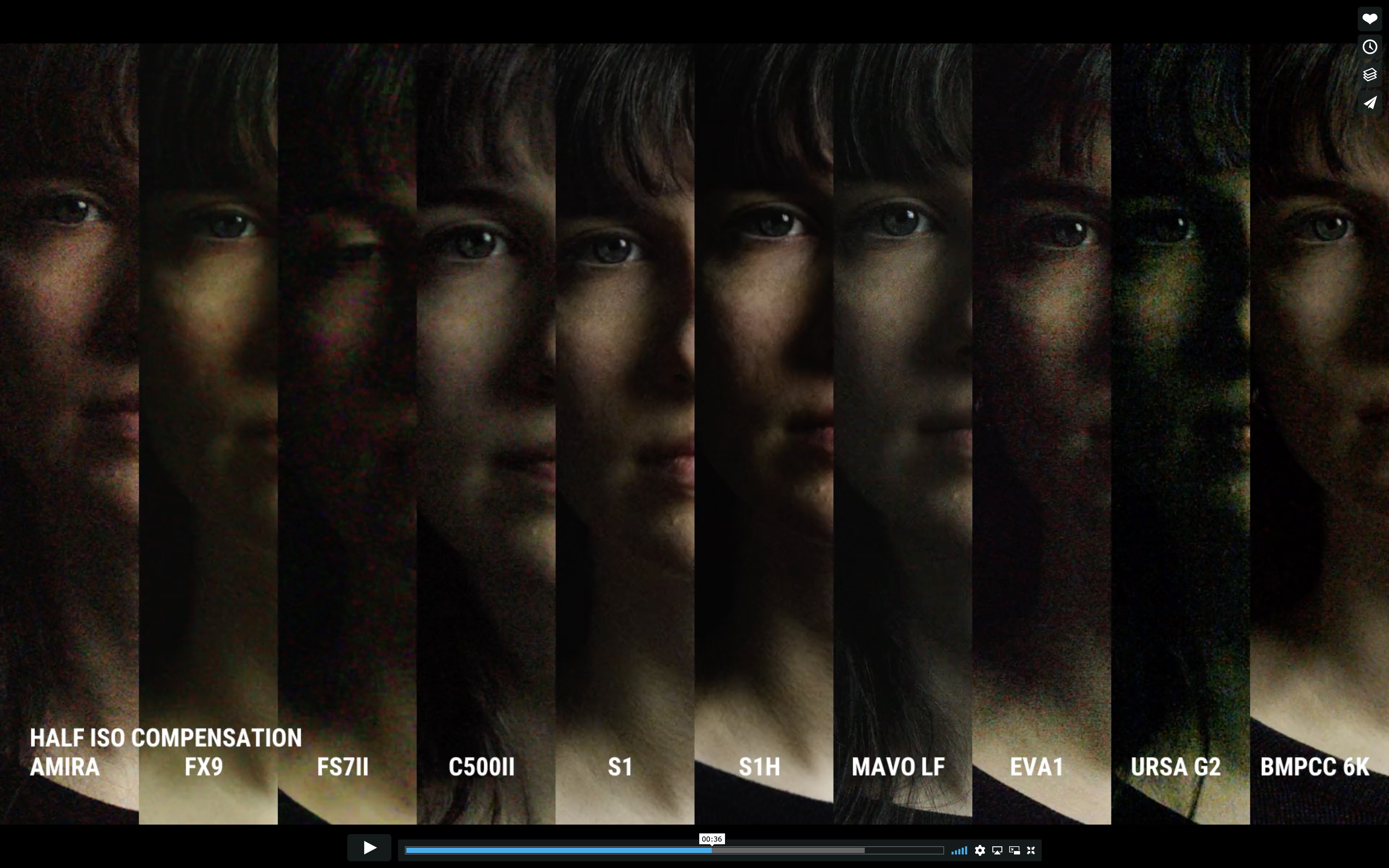

androidlad Posted June 25, 2020 Share Posted June 25, 2020 If this was truth, then there would be accompanying empirical evidence to support it. For now, it's only your subjective opinion. Also in BRAW, 6K scored 11.8 stops and URSA Mini G2 scored 12.1. Link to comment Share on other sites More sharing options...

Administrators Andrew Reid Posted June 25, 2020 Administrators Share Posted June 25, 2020 5 hours ago, androidlad said: If this was truth, then there would be accompanying empirical evidence to support it. Like this? Link to comment Share on other sites More sharing options...
HockeyFan12 Posted June 25, 2020 Share Posted June 25, 2020 1 hour ago, Andrew Reid said: Like this? I think that particular thumbnail is from a low light comparison, but that's a very useful channel. To my eye; 4.6K G2: https://vimeo.com/408639496 Highlights hold to about +4.5. Shadows go deep but get green and unusable around -4 or -4.5. EVA1: https://vimeo.com/399691355 Highlights hold almost to +5. Shadows go deep but heavy noise. Nice color linearity, but maybe good to -3.5? https://vimeo.com/400031418 Amira clips around +5.5, maybe a bit better. Great color linearity but noisy, but nice noise texture. Good to -4.5 but noisy? So would measure much worse but it looks good. Subjective. S1H: https://vimeo.com/404396461 Pretty similar to EVA1, much more banding. Difficult to judge shadows because banding, noise texture, etc. is all more subjective than results on a wedge chart. P6K: https://vimeo.com/408524414 This was at 400 ISO. So it looks like +4 or +4.5 and -2 or -3 if you can tolerate some banding. But at 800 ISO that would be +5 or +5.5 and -1 or -2 but that's from banding, not noise. So if you don't underexpose and rate at 800 ISO I can see this being surprisingly close to an Alexa unless you need to dig into the shadows. S1 has great highlight detail, not so good shadows: https://vimeo.com/399496111Every result is fantastic. An embarrassment of riches on the market today. I don't entirely trust the methodology though. filmmakereu 1 Link to comment Share on other sites More sharing options...
Administrators Andrew Reid Posted June 25, 2020 Administrators Share Posted June 25, 2020 Considering the price difference to the Amira, the S1 and S1H hold up very well in comparison, a cinematic dynamic range is no longer the exclusive privilege of ARRI MAVO LF and Pocket 6K are also on a similar level in that test. So yes, the URSA G2 dynamic range, if it is better than Pocket 6K, is not distributed very far down in the blacks that's for sure. Video Hummus 1 Link to comment Share on other sites More sharing options...
