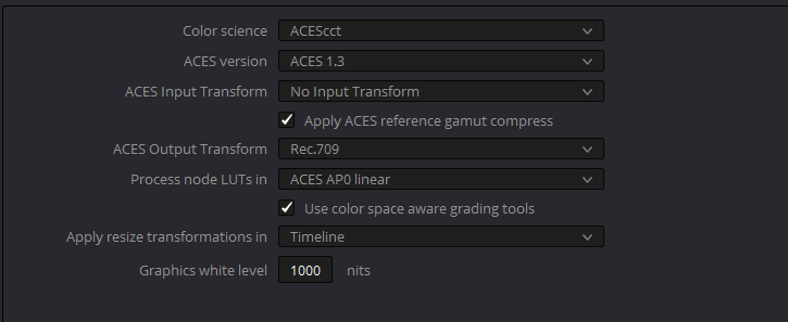

Ryan Earl Posted May 4, 2022 Share Posted May 4, 2022 14 hours ago, Llaasseerr said: For the most flexibility, you can just use an ACES project to import the DNG files to Resolve, then export to a format you're familiar with (like Alexa LogC/Alexa wide gamut) and use in a non-ACES project. Depending on how the metadata is written in the ML raw files, it should work pretty well but obviously it's good to compare how well they work within the MLV app as well I'm not too familiar with ACES, I've just tried these project settings and all the highlights seem available, lift gamma gain tools are responding great, color seems good: How would you suggest setting it up for ARRI log C? Link to comment Share on other sites More sharing options...

Llaasseerr Posted May 4, 2022 Share Posted May 4, 2022 6 hours ago, Ryan Earl said: I'm not too familiar with ACES, I've just tried these project settings and all the highlights seem available, lift gamma gain tools are responding great, color seems good: How would you suggest setting it up for ARRI log C? Yes if you wanted to stay in ACES then those settings are fine. If you wanted to use Arri LogC/AWG, I suggest rendering it out which works well if you render something like a Prores 4444 file. Then you can bring it into a new non-ACES project afterwards if you want, because the DNGs will have been correctly interpreted by the DNG IDT within the ACES project. If reusing in a new ACES project or the same ACES project, then when importing use the Alexa IDT which I think is also called "Arri LogC EI800 AWG". First set the Output Transform to "no output transform" and apply an ACES Transform node to the footage, where the input is "no input transform" and the output is "Arri LogC EI800 AWG". Also set the gamut compress type to "reference gamut compress". Then render. Also note that you can create your own ACES workflow in a non-ACES project by using the ACES Transform node. But this doesn't work for importing DNGs because the IDT is only available in an ACES project. So I do that in a dedicated ACES project as a first step. Link to comment Share on other sites More sharing options...
