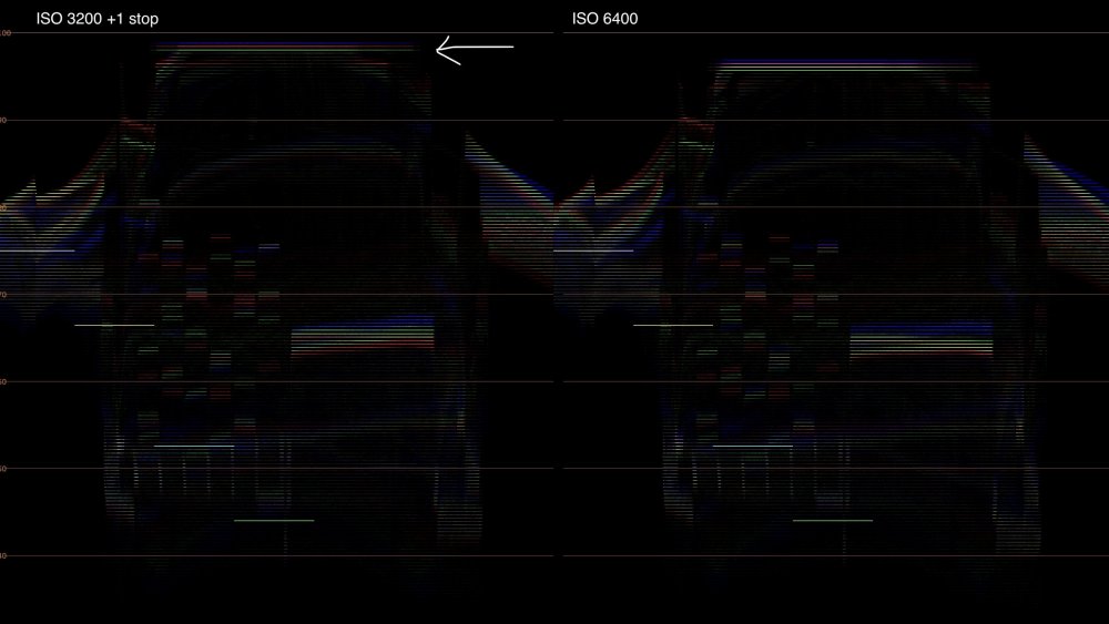

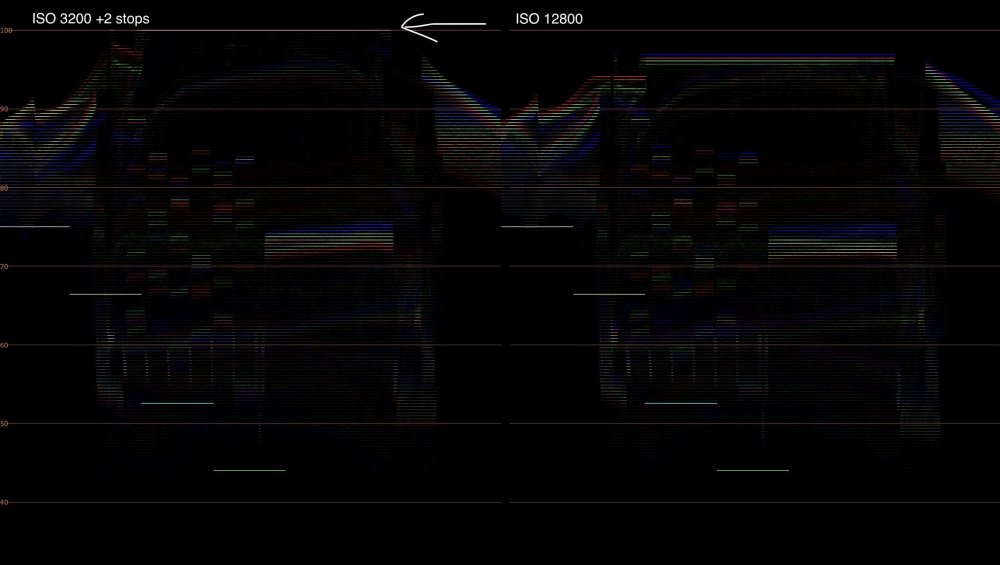

Llaasseerr Posted May 21, 2022 Share Posted May 21, 2022 10 hours ago, Ryan Earl said: I exposed the following frames starting at ISO 100 using false color. I just kept the wall behind the light without clipping and the mask with some clipping, the gray card at ISO 100 is underexposed. Not sure how helpful this will be. . . https://we.tl/t-82kFKys7LH Here's the highlight clipping without/with highlight recovery based on the just the red channel: ISO 100: 1.0 / 2.09 ISO 200: 2.0 / 4.13 ISO 400: 4.0 / 8.25 ISO 800: 8.0 / 16.1 ISO 1600: 8.0 / 16.1 ISO 3200: 5.0 / 9.92 ISO 6400: 8.0 / 16.48 ISO 12800: 8.0 / 16.73 So the clipping point in the DNG is reached at ISO 800, but it's just due to amplifying the signal by +3 stops from base ISO 100. ISO 800 seems to be the starting point for the Ninja V implementation, which clips at ~9.34. This seems about right since I don't think it uses any kind of highlight recovery. When I balance ISOs 100-800 to the same exposure, they're the same clipping point because 800 hits the max highlight value form that point on. The noise floor actually looks the same to me as well. In this case, ISO 1600 and up are not adding anything in the highlights. ISO 3200 clips earlier than the rest, so ~9.9 vs 16.1, but the noise floor is about the same as ISO 800. If you think about it, there's a net gain here because the highlights are holding about 1/3 stop less than 6400 but the noise floor is -1 stop less. So it's the same as 800, which is really just ISO 100+3 stops). So to me, the way to take advantage of this is to underexpose 3200 by at least 1 stop so you're rating for at least 6400. The effect is that the noise floor is the same as 6400, but the highlights now clip a bit higher. This ISO difference is the same behaviour with the Ninja V at 3200. I'm uploading two waveforms: 1. ISO 3200+1 stop vs ISO 6400. = +1/4 stops more highlight detail. Max value 19.86 vs 16.48 in the red channel, noise floor the same. 2. ISO 3200+2 stops vs ISO 12800 = +1 1/4 stops more highlight detail. Max value 39.7 vs 16.48 in the red channel, noise floor the same. For reference, Alexa's sensor clips at 55 in linearized logC which is only half a stop more, so it seems that the shadow detail would hold up okay if the ISO rating was pushed further. I was going to upload a split screen of the shadow noise, but it honestly looks the same in each image when inspecting each channel individually so take my word for it. It would definitely be interesting in more test images showing the same ISO range at the same exposure level (adjusted with either lens or ND), and also protecting the highlights. It does seem like there's plenty of room to push shadow detail way down and still recover a decent image. EDIT: I just want to clarify that in the +2 stops waveform image (LHS), the highlights are not getting clipped but they're in the upper code values of the log range and can be pulled back. Ryan Earl and OleB 2 Link to comment Share on other sites More sharing options...
Llaasseerr Posted May 21, 2022 Share Posted May 21, 2022 15 minutes ago, Llaasseerr said: I'm just noticing the shadow levels are getting a little lost at the bottom of the waveform for the pushed 3200 image, so despite the fact it looked visually the same to me when inspecting noise per channel, it evidently is throwing a bit of detail out in service of the highlights. It will be interesting to see how the deepest shadows hold up if the image is shot -2 stops or more underexposed. Also, sorry for the numerous typos in the above post. OleB 1 Link to comment Share on other sites More sharing options...

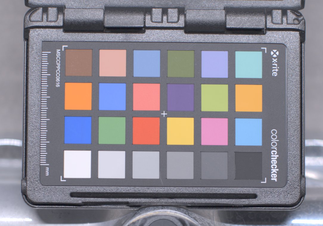

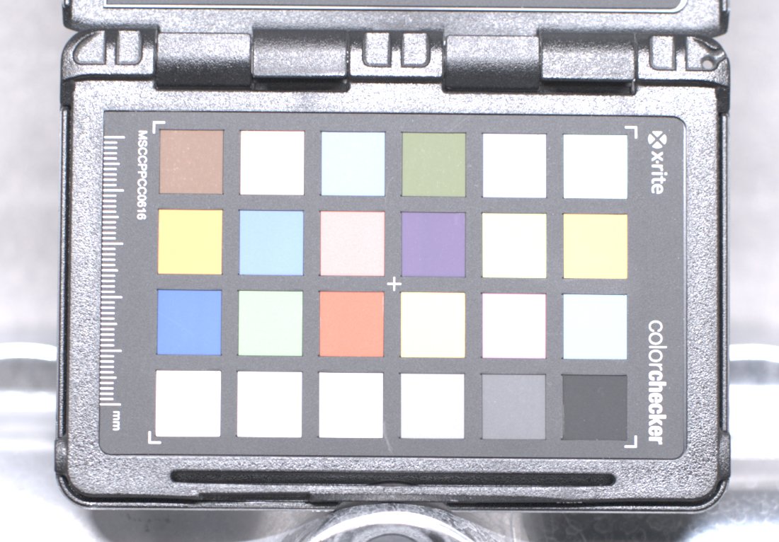

OleB Posted May 26, 2022 Share Posted May 26, 2022 Took the public holiday today to investigate further, results before were not good enough. You can disregard my tables. Dead end street... Llaasseerr you were right, if I underexpose middle grey the post production is a becoming a big headache. Now what I did today is set up lighting (camera ISO 800) and my color checker passport. Turned on false colors and tuned the lighting so that the patch which is representing middle grey was green (44 - 47 IRE) in the Atomos. (the one marked in the picture) False color screen showed the following values for those patches, starting with white... 93 IRE, 84 IRE, 75 IRE, 59 IRE, 46 IRE, 26 IRE Loaded the file into FCPX, but instead of pulling the highlights down as usual I did something different this time. On import the file looks totally over... The new idea was to create a curve to bring down the patches to their appropriate brightness. The curve, as smooth as I could get it, looks like this for all ISO values expect for ISO 3200. ISO 800: ISO 3200: Last but not least I now had to search for the correct light meter values to get the exposure matching with my middle grey patch of the color checker. Camera - light meter ISO 800 - 250 ISO 1600 - 640 ISO 3200 - 2000 ISO 6400 - 2500 ISO 12800 - 5000 ISO 25600 - 10000 That's it 🙂 I am happy now. Can use the false colors now correctly and even take a meter reading which is matching the Ninja. Since I have saved my curves as a preset it is now a one double clic action to get the file in FCPX exactly matching what I saw when recording. Basically it seems I have created my own brightness calibration file. Might take a further investigation in regards to colors, but for now the result seems pleasing. Obviously I have tested it with various of my previous recordings and it is just so much better. Maybe this could be of help 🙂 PannySVHS 1 Link to comment Share on other sites More sharing options...
