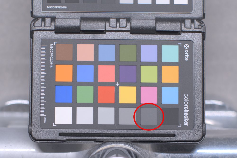

Llaasseerr Posted May 27, 2022 Share Posted May 27, 2022 20 hours ago, OleB said: Took the public holiday today to investigate further, results before were not good enough. You can disregard my tables. Dead end street... Llaasseerr you were right, if I underexpose middle grey the post production is a becoming a big headache. Now what I did today is set up lighting (camera ISO 800) and my color checker passport. Turned on false colors and tuned the lighting so that the patch which is representing middle grey was green (44 - 47 IRE) in the Atomos. (the one marked in the picture) False color screen showed the following values for those patches, starting with white... 93 IRE, 84 IRE, 75 IRE, 59 IRE, 46 IRE, 26 IRE Loaded the file into FCPX, but instead of pulling the highlights down as usual I did something different this time. On import the file looks totally over... The new idea was to create a curve to bring down the patches to their appropriate brightness. The curve, as smooth as I could get it, looks like this for all ISO values expect for ISO 3200. ISO 800: ISO 3200: Last but not least I now had to search for the correct light meter values to get the exposure matching with my middle grey patch of the color checker. Camera - light meter ISO 800 - 250 ISO 1600 - 640 ISO 3200 - 2000 ISO 6400 - 2500 ISO 12800 - 5000 ISO 25600 - 10000 That's it 🙂 I am happy now. Can use the false colors now correctly and even take a meter reading which is matching the Ninja. Since I have saved my curves as a preset it is now a one double clic action to get the file in FCPX exactly matching what I saw when recording. Basically it seems I have created my own brightness calibration file. Might take a further investigation in regards to colors, but for now the result seems pleasing. Obviously I have tested it with various of my previous recordings and it is just so much better. Maybe this could be of help 🙂 Just a few quick notes here. First of all, the middle grey patch (0.18) is the third from right, so it's the lighter one immediately to the left of the patch you're using right now. Secondly, you never have to break linearity to get correct exposure when shooting raw. You just need to do exposure shifts on the whole image until the middle grey value is at 0.18 in linear spave. Overall, without having tested the Ninja V workflow with this camera myself, I think your approach of metering based on ISO 800 is sound, and using the Atomos false color to hit the *correct* middle grey patch. It's clear that in most cases the base ISO for the Ninja V interpreting Sigma fp raw footage is ISO 800. If you want, you can try exposing by getting the green in the false color to hit the correct patch, which we can assume for now will be based on exposing for ISO 800, and then send me the raw image so I can check the exposure in linear space. It really should be that simple. Link to comment Share on other sites More sharing options...

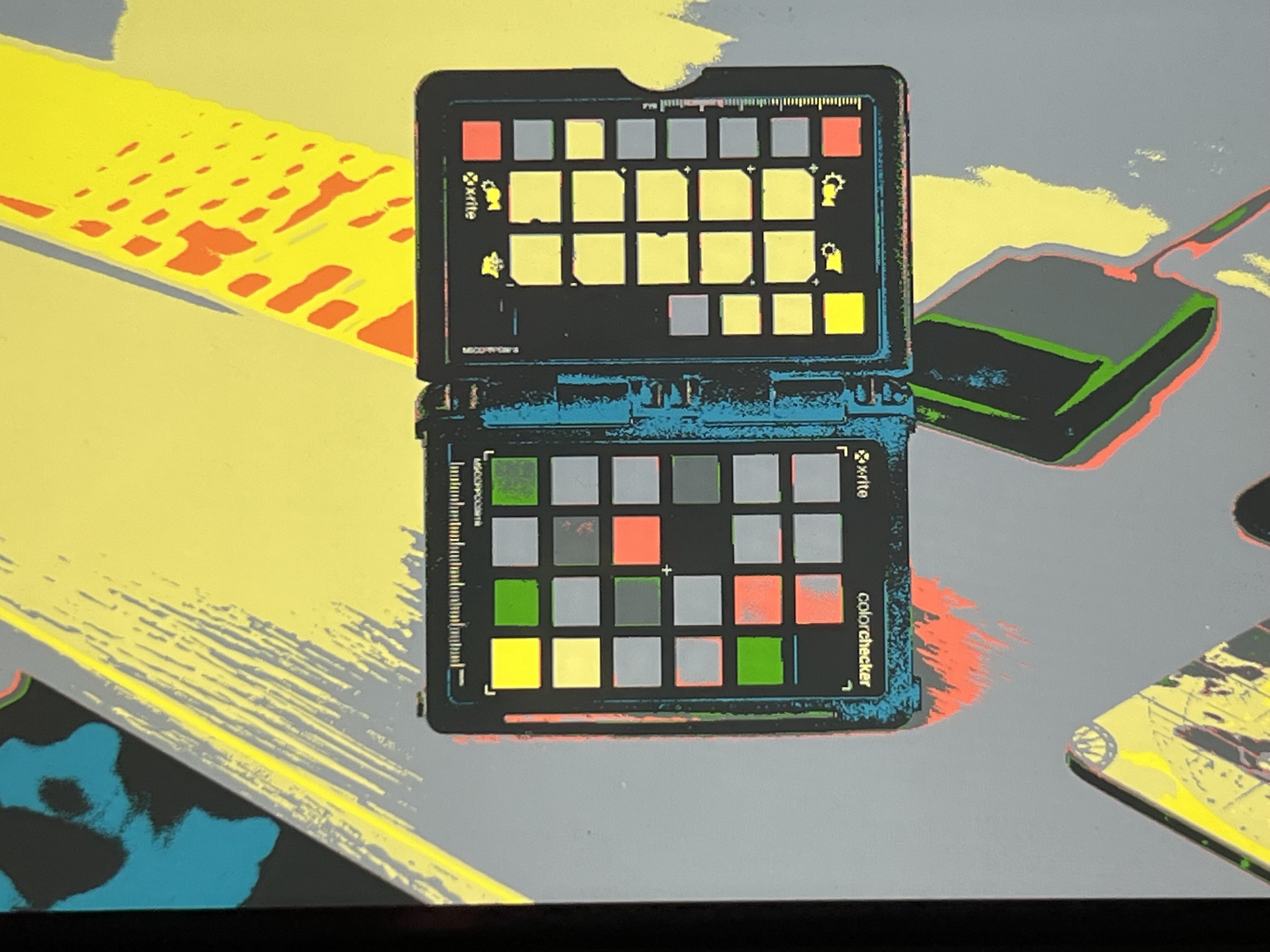

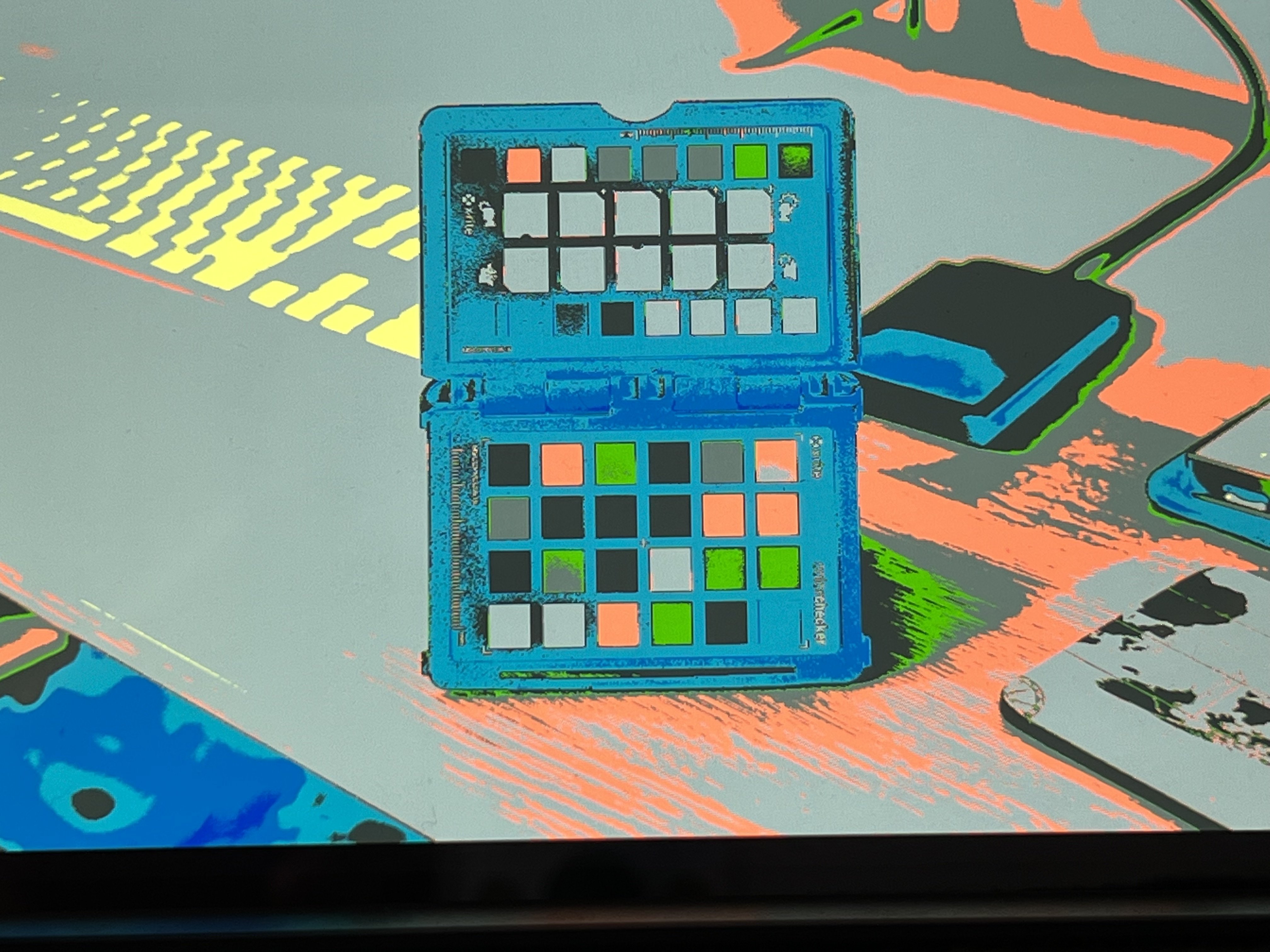

OleB Posted May 27, 2022 Share Posted May 27, 2022 2 hours ago, Llaasseerr said: Just a few quick notes here. First of all, the middle grey patch (0.18) is the third from right, so it's the lighter one immediately to the left of the patch you're using right now. Have taken two photos with the false color scale. If I expose for the third one from right as middle grey, there is not even white...So this cannot be the case, at least not in the way the Ninja interprets the brightness. My middle grey approach: Exposed according to your middle grey choice: It is impossible to get the patches look the same for both the Ninja and FCPX by adjusting exposure/iso only. Don't ask me why. Maybe something (Gain?) is transferring incorrectly, or a different sort of gamma curve. Which it seems you cannot change in FCPX. Would be great if someone with a Blackmagic Assist could record BRAW and see if with DaVinci Resolve there is a better chance to get things how they should be... Link to comment Share on other sites More sharing options...

Llaasseerr Posted May 27, 2022 Share Posted May 27, 2022 3 hours ago, OleB said: Have taken two photos with the false color scale. If I expose for the third one from right as middle grey, there is not even white...So this cannot be the case, at least not in the way the Ninja interprets the brightness. My middle grey approach: Exposed according to your middle grey choice: It is impossible to get the patches look the same for both the Ninja and FCPX by adjusting exposure/iso only. Don't ask me why. Maybe something (Gain?) is transferring incorrectly, or a different sort of gamma curve. Which it seems you cannot change in FCPX. Would be great if someone with a Blackmagic Assist could record BRAW and see if with DaVinci Resolve there is a better chance to get things how they should be... Unfortunately without knowing all the color transforms occurring, you can't monitor the image and get the same result in FCPX. The underlying raw image is always linear with no gamma adjustment. It's just that the Ninja V by default applies a baseline adjustment, then you are applying PQ on top, then in FCPX it allows you to select a new way to display it. With a managed color pipeline, you do not have to do any adjustments at all. It looks the same on the monitoring device as it does when you initially import it into the editing software. Maybe try the internal false color and see if you can get that working, then go back to the Ninja knowing what your baseline is. Also try disabling PQ. Just cut out all the variables first. With ProRes Raw on a Sony camera, this all works very predictably and easily. OleB 1 Link to comment Share on other sites More sharing options...
