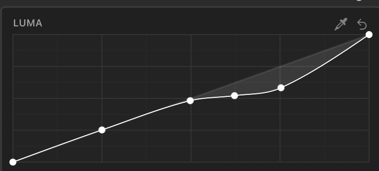

OleB Posted May 30, 2022 Share Posted May 30, 2022 Unique indeed, will try that Assimilate Play Pro way, sounds at least like a good idea in regards to what it does. For me the solution with the curve presets is working fine. Agree that one should not have to fiddle with that kind of things, but anyway. After 1 year and 4 months of trying to get my feet on the ground in regards to using that camera properly and predictable I am somehow happy now. Today I focused on something different finally. Highlight rolloff. Trying to get the sharp edge off a little. Seems to be working quite well. 🙂 SOOC: Highlight rolloff: PannySVHS and kye 1 1 Link to comment Share on other sites More sharing options...

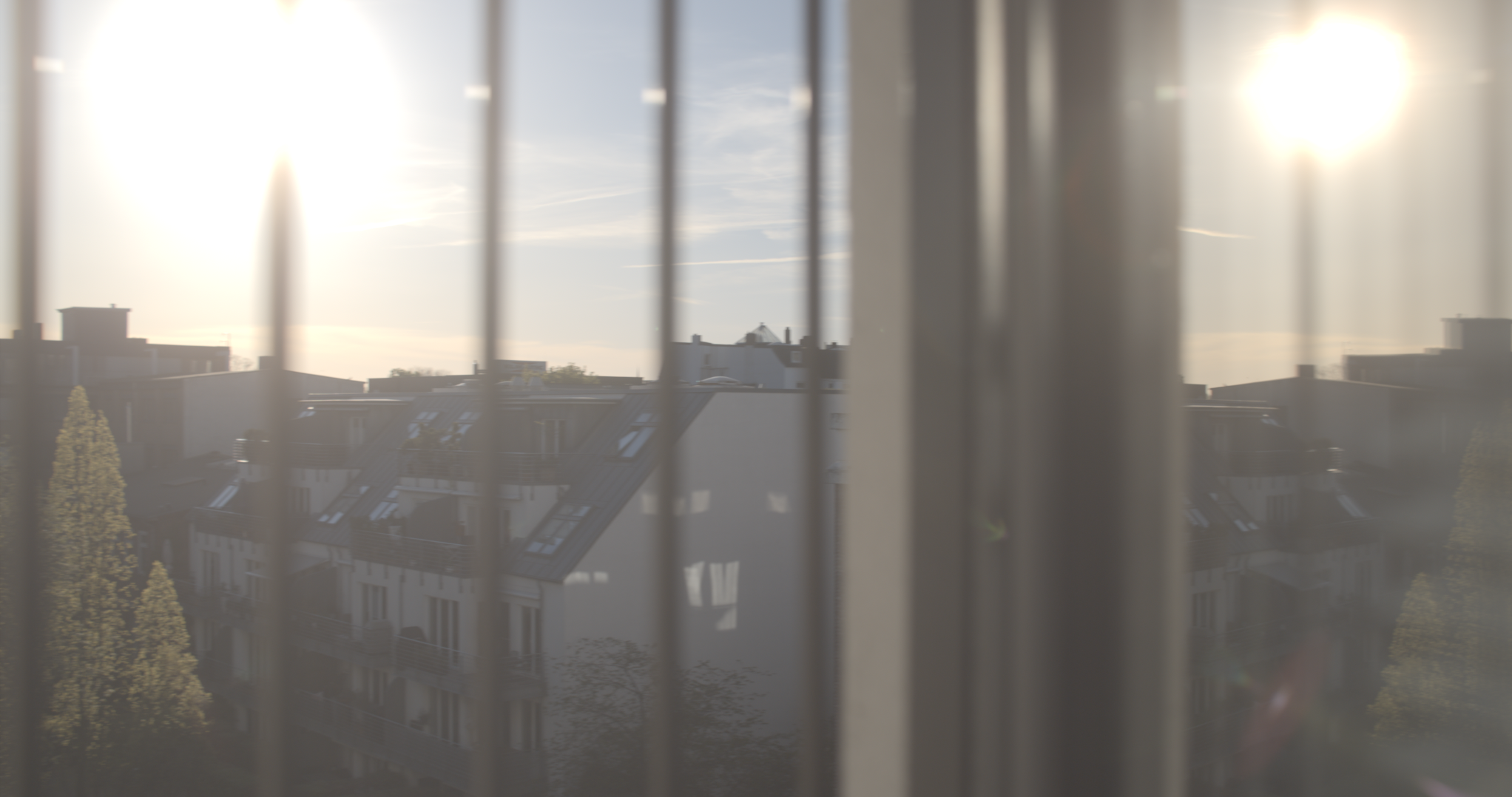

OleB Posted May 30, 2022 Share Posted May 30, 2022 One possibly a little more real word sample of what can be achieved quite easily. In my opinion this does not look bad at all. 🙂 SOOC: Highlight rolloff: PannySVHS 1 Link to comment Share on other sites More sharing options...
Owlgreen Posted May 30, 2022 Share Posted May 30, 2022 3 hours ago, OleB said: Today I focused on something different finally. Highlight rolloff. Trying to get the sharp edge off a little. Seems to be working quite well. SOOC: Highlight rolloff: I am most impressed. Can you tell us a bit about your process? Thanks. Link to comment Share on other sites More sharing options...
Llaasseerr Posted May 30, 2022 Share Posted May 30, 2022 6 hours ago, OleB said: One possibly a little more real word sample of what can be achieved quite easily. In my opinion this does not look bad at all. 🙂 SOOC: Highlight rolloff: 7 hours ago, OleB said: Unique indeed, will try that Assimilate Play Pro way, sounds at least like a good idea in regards to what it does. For me the solution with the curve presets is working fine. Agree that one should not have to fiddle with that kind of things, but anyway. After 1 year and 4 months of trying to get my feet on the ground in regards to using that camera properly and predictable I am somehow happy now. Today I focused on something different finally. Highlight rolloff. Trying to get the sharp edge off a little. Seems to be working quite well. 🙂 SOOC: Highlight rolloff: With raw there's no such thing as SOOC. I think that what you're seeing as SOOC is just some random interpretation by FCP. But as long as it works for you that's the main thing. You should get a good predictable starting point just by transcoding raw to Arri LogC and applying the standard Arri log to Rec709 LUT, which has a visually similar highlight rolloff to the default ACES look transform but it's a bit less contrasty. Both are based roughly on the s-curve of a film print. Why make life hard? Everyone talks about Alexa highlight rolloff, but all they are really looking at most of the time is the rolloff of the 709 LUT from the raw sensor data since the sensor itself has no highlight rolloff in the captured image. My opinion from limited testing is that working internally with DNGs seems pretty straightforward. OleB 1 Link to comment Share on other sites More sharing options...

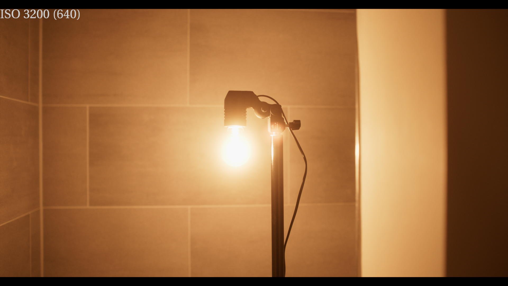

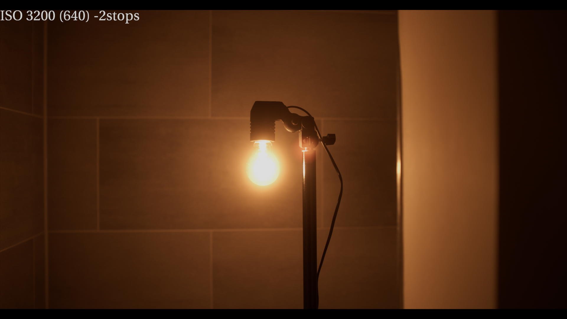

Llaasseerr Posted May 30, 2022 Share Posted May 30, 2022 Here's the image rendered through the default ACES look transform. In this case, I first exported the PRR files as Arri LogC/AWG then I used the Alexa input device transform to ACES. This is from the ISO 3200 image you provided. It's quite a graceful transition for blown out highlights. If we pull the exposure on this image down -2 stops, it's not too bad because the LUT is doing a good job interpreting the raw data. But you start to see the sensor clipping and the rolloff is more abrupt towards the core which is lacking detail. This is where the Alexa wins out, as it will allow the LUT to keep going with the rolloff. It's the LUT that is providing the rolloff, the sensor data is just linear - but the Alexa has a lot more of it captured on the top end by default. If you underexpose with the Sigma, obviously you will keep that rolloff going too and it will not look like a flat white blob with magenta edges at the transition. OleB and PannySVHS 1 1 Link to comment Share on other sites More sharing options...

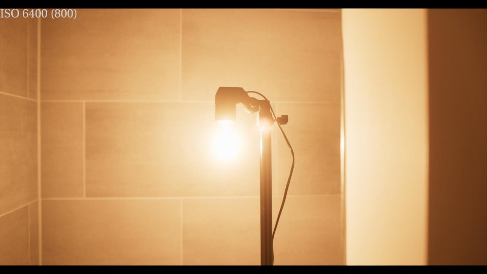

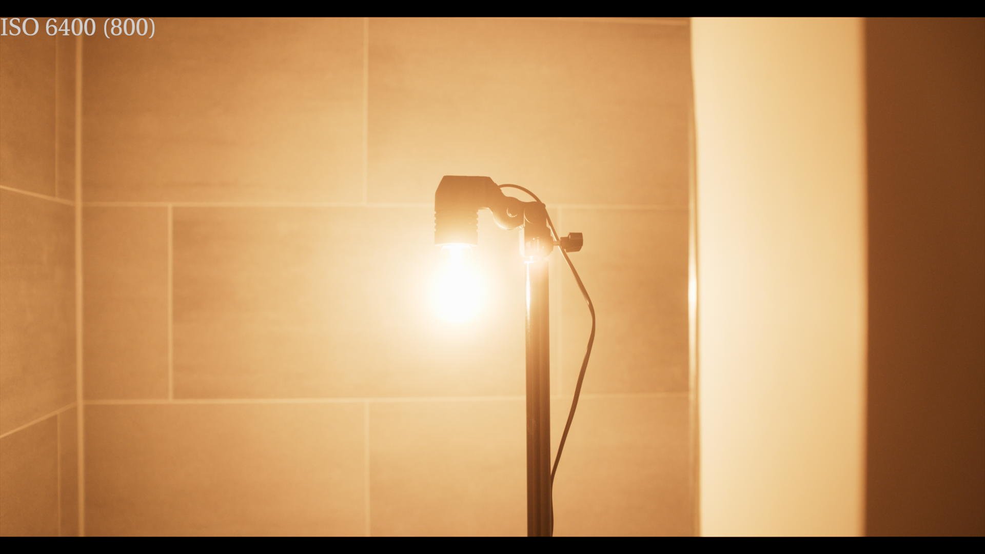

Llaasseerr Posted May 30, 2022 Share Posted May 30, 2022 Here is the same thing, but with your ISO 6400 image and 6400 -2 stops. The point of these is not to just show another look, but this is a "good enough" technically accurate pipeline for most people based on a scene referred image, and I did not need to do any special modifications. Link to comment Share on other sites More sharing options...
