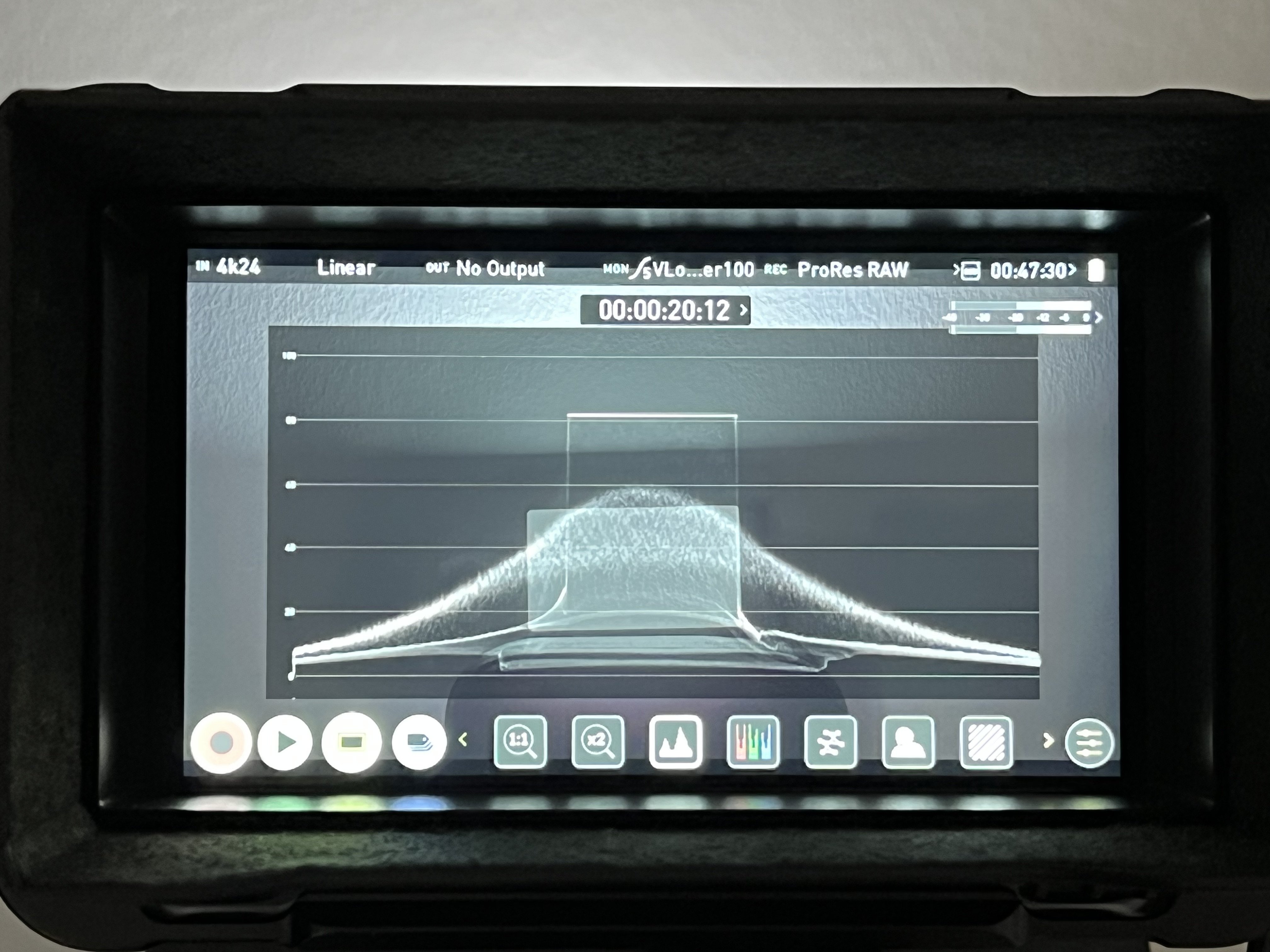

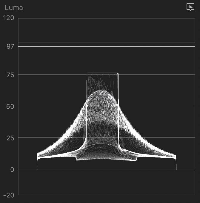

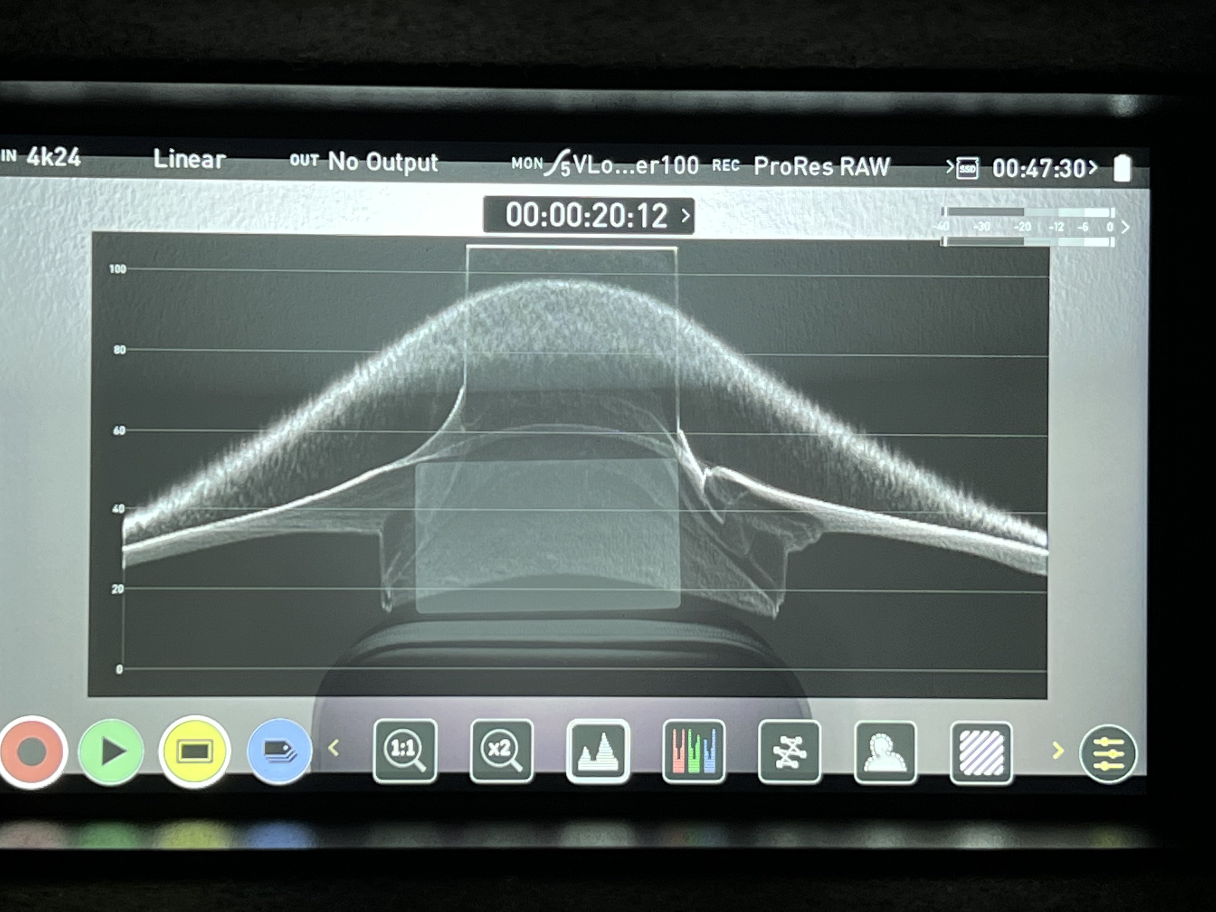

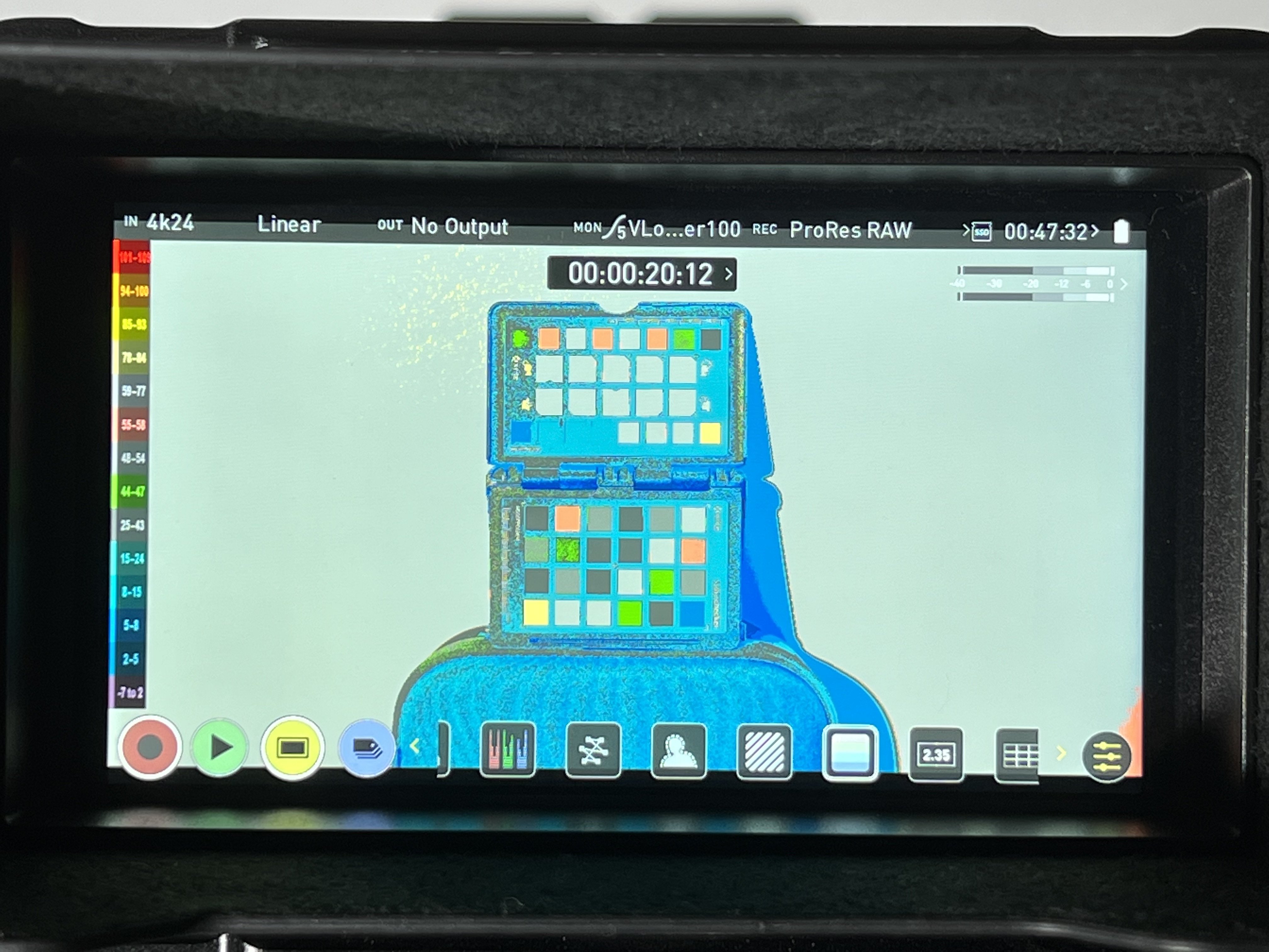

OleB Posted May 31, 2022 Share Posted May 31, 2022 We are getting really close. The LUT seems to do the trick. There is a minimal difference in highlight brightness (monitor shows 78 IRE, FCPX shows 75 IRE) when imported into FCPX and applying the same LUT as in the monitor. Suppose this is due to the not 100% matching RAW to V-log conversion which is built into FCPX. ISO values and middle grey seem to work as intended now. Interestingly the brightest part in the picture is only reaching red in the false colors when using ISO 400 and upwards. Seems the maximum steps from middle grey to white are increasing (that reacts as per Sigma ISO manual). Will investigate further now. Link to comment Share on other sites More sharing options...

Llaasseerr Posted May 31, 2022 Share Posted May 31, 2022 3 hours ago, OleB said: We are getting really close. The LUT seems to do the trick. There is a minimal difference in highlight brightness (monitor shows 78 IRE, FCPX shows 75 IRE) when imported into FCPX and applying the same LUT as in the monitor. Suppose this is due to the not 100% matching RAW to V-log conversion which is built into FCPX. ISO values and middle grey seem to work as intended now. Interestingly the brightest part in the picture is only reaching red in the false colors when using ISO 400 and upwards. Seems the maximum steps from middle grey to white are increasing (that reacts as per Sigma ISO manual). Will investigate further now. Does the linear to V-log transform (without the log to 709 LUT) in FCPX match the default image on the Ninja V? That would be another way of checking this. Could the slight mismatch be a video vs data levels display issue? Link to comment Share on other sites More sharing options...

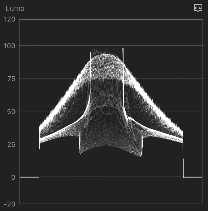

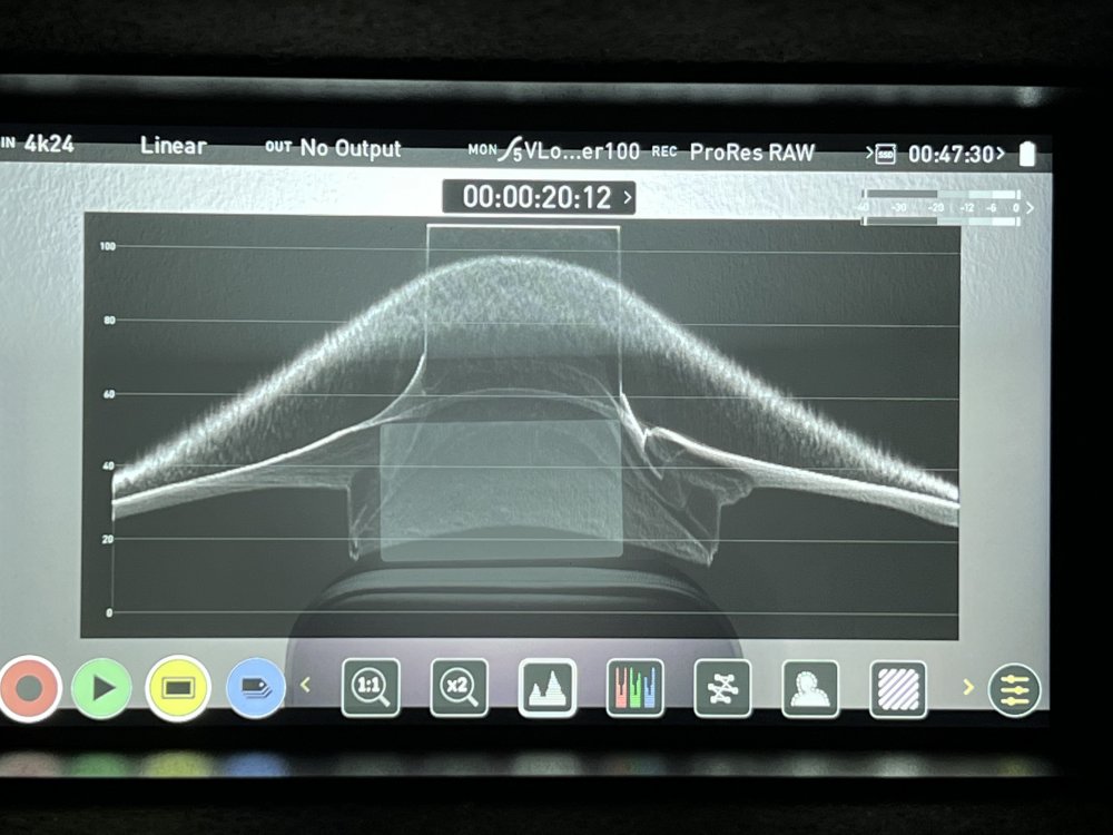

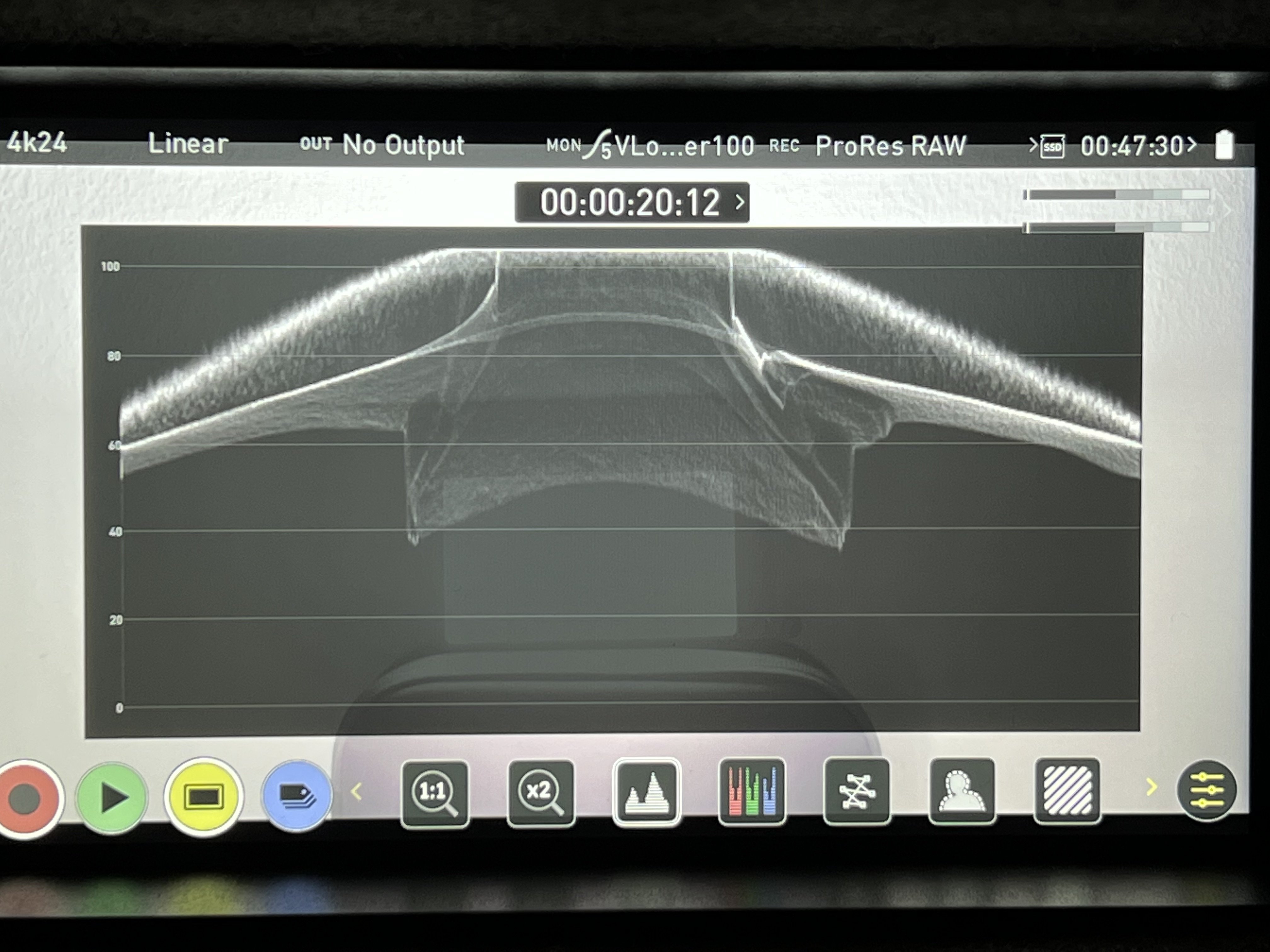

OleB Posted May 31, 2022 Share Posted May 31, 2022 31 minutes ago, Llaasseerr said: Does the linear to V-log transform (without the log to 709 LUT) in FCPX match the default image on the Ninja V? That would be another way of checking this. Could the slight mismatch be a video vs data levels display issue? Will check that tomorrow in detail. But at first glance I would say they are extremely similar (V-Log transform and native monitoring). What I don't get is that with ISO 100 & 200 the false colors with LUT applied are not going to full 100 IRE, they stay well below. I was under the impression that the LUT should stretch that out. Middle grey is shifting correctly with the ISO steps and display is as well doing so. All in all at least another really good approach which might turn out to be the best choice instead of my cumbersome curve editing. Link to comment Share on other sites More sharing options...
Llaasseerr Posted May 31, 2022 Share Posted May 31, 2022 29 minutes ago, OleB said: Will check that tomorrow in detail. But at first glance I would say they are extremely similar (V-Log transform and native monitoring). What I don't get is that with ISO 100 & 200 the false colors with LUT applied are not going to full 100 IRE, they stay well below. I was under the impression that the LUT should stretch that out. Middle grey is shifting correctly with the ISO steps and display is as well doing so. All in all at least another really good approach which might turn out to be the best choice instead of my cumbersome curve editing. I'm a bit confused because I thought you said the Ninja recording starts at 800. What about on a waveform instead of false colors? What is the max IRE value according to that? I assume you mean you're just applying the standard V-log to Rec709 LUT on the naked image on the Ninja. There is a chance that this doesn't work and you're actually stuck with some random flat image from the camera. Link to comment Share on other sites More sharing options...
OleB Posted May 31, 2022 Share Posted May 31, 2022 1 hour ago, Llaasseerr said: I'm a bit confused because I thought you said the Ninja recording starts at 800. What about on a waveform instead of false colors? What is the max IRE value according to that? I assume you mean you're just applying the standard V-log to Rec709 LUT on the naked image on the Ninja. There is a chance that this doesn't work and you're actually stuck with some random flat image from the camera. For Rec709 and PQ it is true that ISO 800 = ISO 100 in terms of sensor clipping and the metering starts to change only from ISO 800 and upwards. Native mode and now with the standard V-Log to Rec709 LUT the Ninja measures as from ISO 100 (both waveform and false colors change). However I do not know if this really showing something in regards to real sensor saturation or if it is just showing applied gain. Actually I think it is the later because of the Sigma ISO guide. ISO 100-800 is the same but with different distribution and gain levels. Will take the measures tomorrow, at least for some key ISO values like 100, 800, 3200. Update to follow. Llaasseerr 1 Link to comment Share on other sites More sharing options...

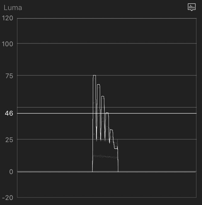

OleB Posted June 1, 2022 Share Posted June 1, 2022 So here we go, took the measurements and uploaded the files for your own tests. https://www.dropbox.com/sh/cgm80q9w682oc19/AADWHieOS-Wka9JuD-GnXerca?dl=0 Have used the LUT which is also included in the dropbox for monitoring and as LOG to Rec709 conversion in the FCPX info tab. RAW to LOG was the build in Panasonic V-log. You cannot load custom conversions into that tab by the way. Good things first, the light meter is matching for all ISO settings with the middle grey representation on the false colors screen of the Ninja V. Visually the preview picture is also a pretty good match. So that part ist out of the way. ISO 100 representation on the Ninja V: How the greyscale looks after import and conversion settings applied in FCPX: That seems to be really close, with a little bit of less highlight brightness. Middle grey is still where it belongs though. All ISO settings will result into the exact same picture of the luma values. Also positive. Now we are coming to the clipping. ISO 100 clipping point as per waveform in the monitor: After import: That is a little bit weird already. Would have expected that the LUT is extending the values further. So basically clipping will be at over 100 IRE in FCPX, but that is only the case roughly for ISO 800. Waveform ISO 800: Waveform ISO 3200: Looking forward to your own investigation results. For my part I will try to create some more footage to see how this works with real pictures. The colors need work as from what I see, too little saturation for my taste. Link to comment Share on other sites More sharing options...
