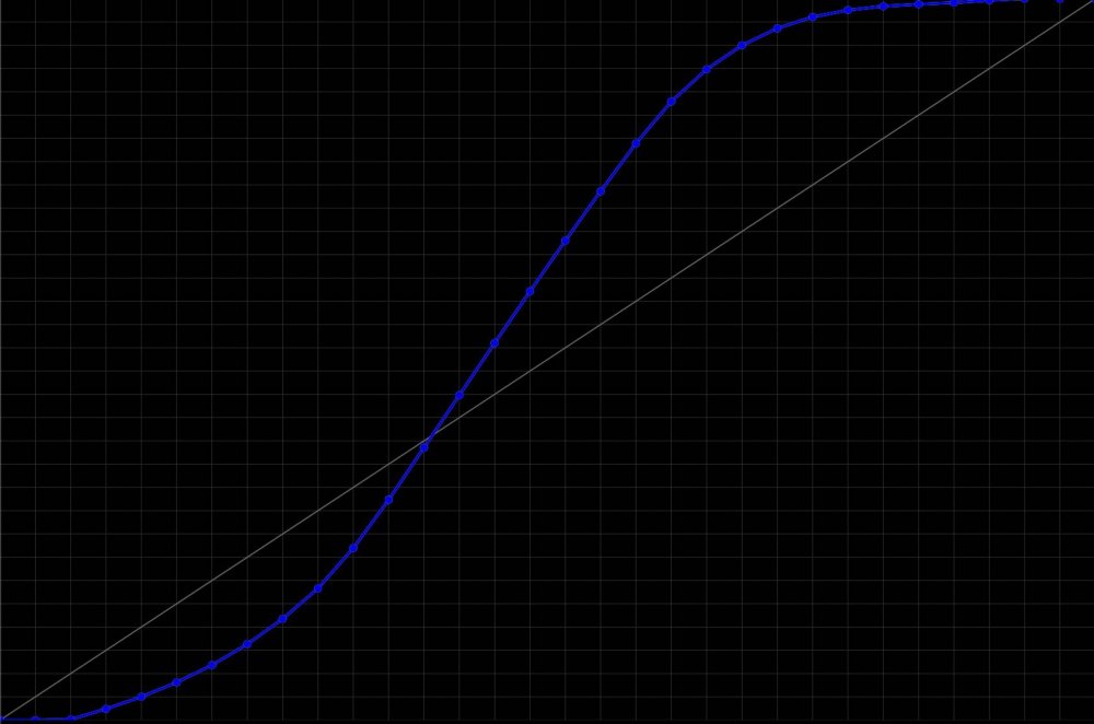

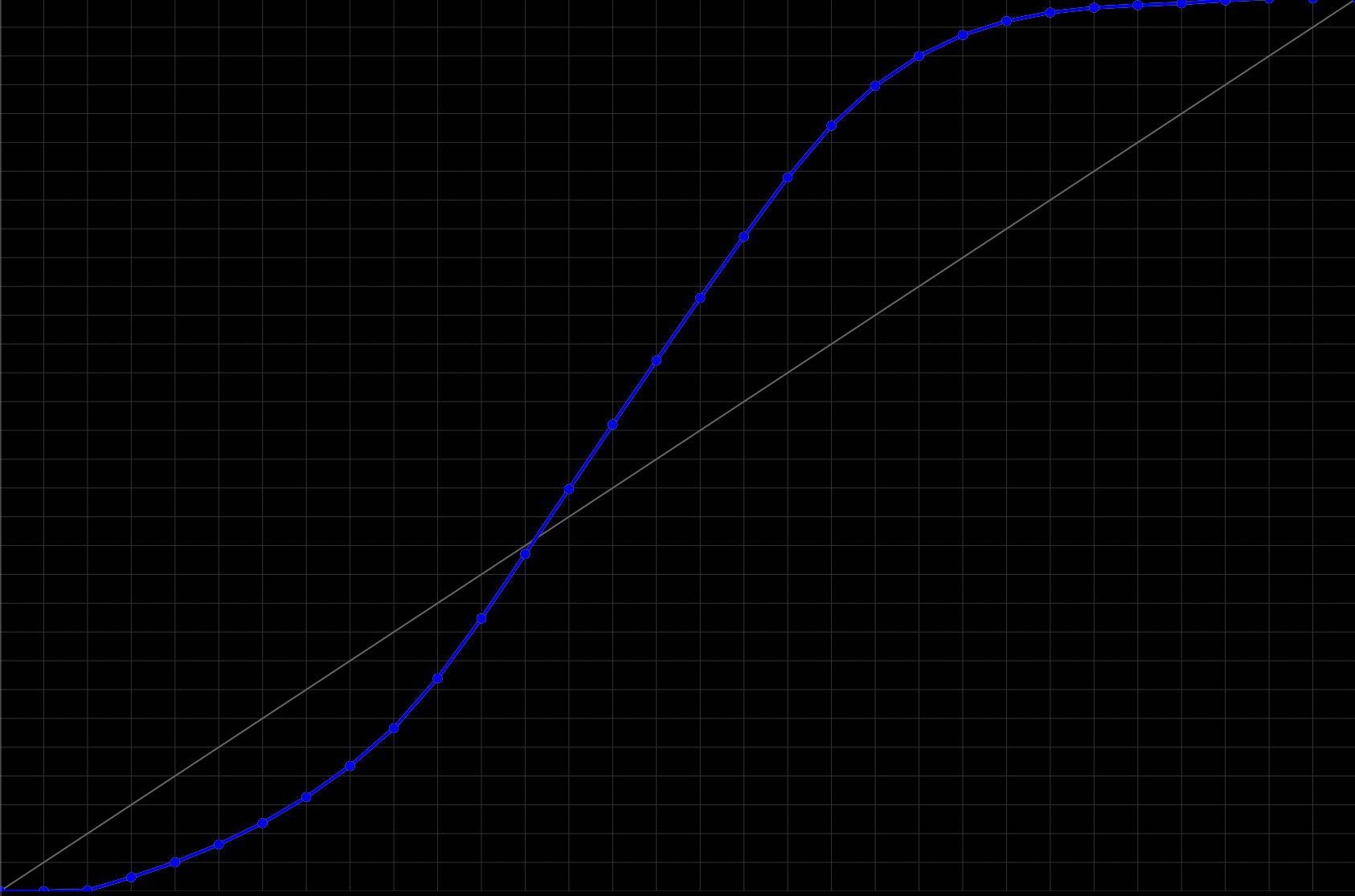

OleB Posted June 6, 2022 Share Posted June 6, 2022 Have checked, the data itself is not clipping. So everything is there. However the IRE value for the white patch was my fault. Middle grey is the forth patch, correct. What I did incorrectly is the exposure, it does not have to be green, it has to be grey. Which in fact is around 50 IRE in the Ninja V. If you do that, the procedure with the LUT would be working. However I do not find the colors to be very pleasing. My way with the custom data to video curve seems to bring me better results. So I have decided that I will stick with the method of monitoring PQ and import it with my presets. Look of both is absolutely identical then. Let us see if Sigma will bring a future firmware update to make this a little more streamlined. Link to comment Share on other sites More sharing options...

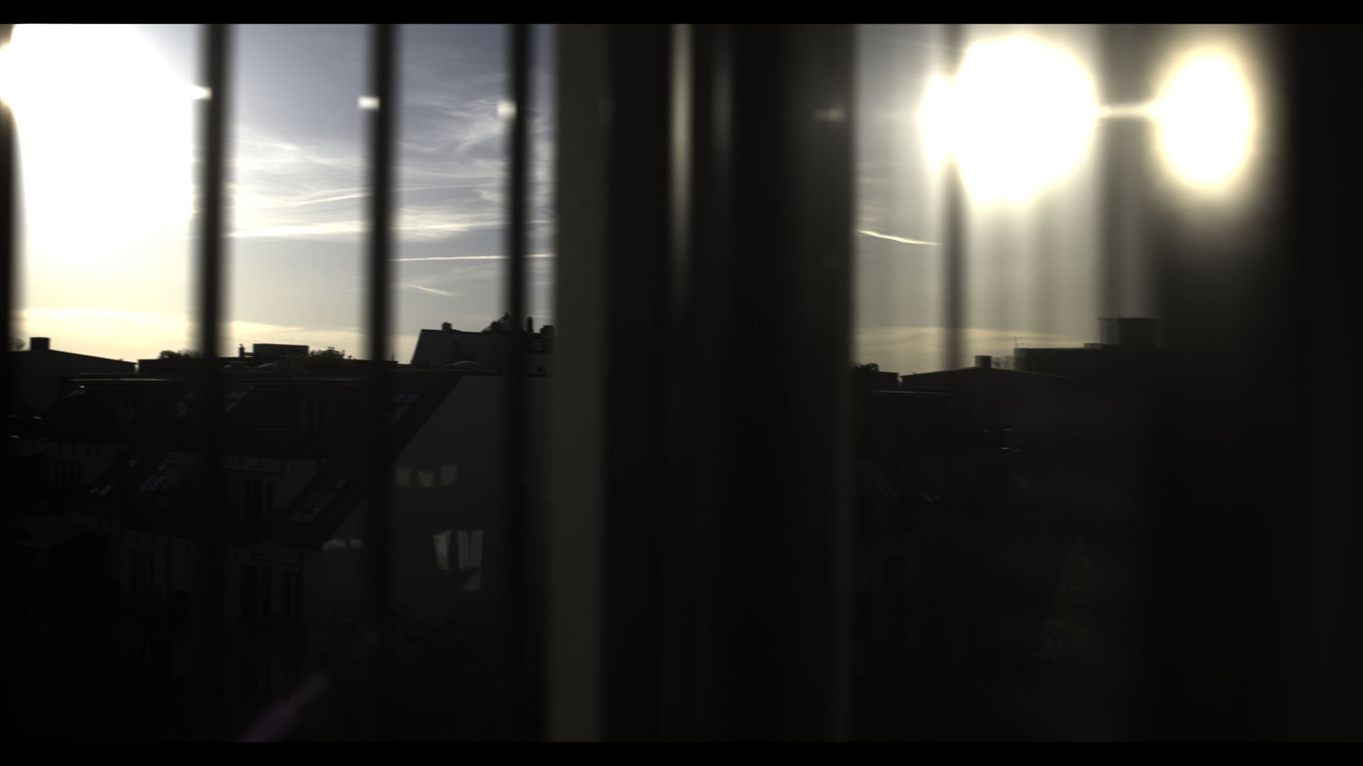

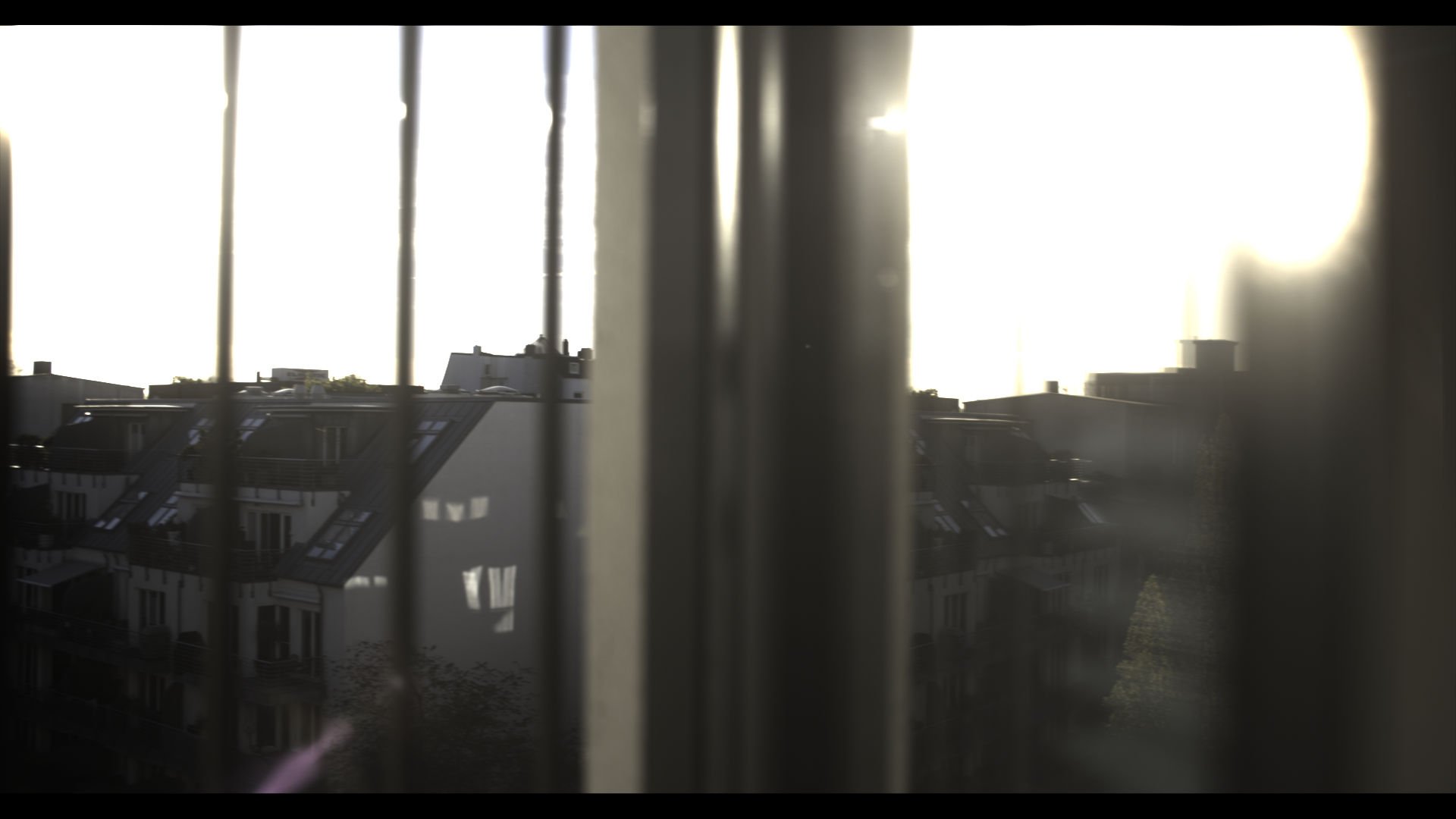

OleB Posted June 8, 2022 Share Posted June 8, 2022 This topic seems to be endless the more I put my brain into. Have read through the white paper of ProRes RAW and studied a few more webpages. Since the fp does not provide a Sigma RAW to Log conversion and no LUT which is fitting that Log back into Rec709, FCPX uses its standard settings. That means it is importing the file without any sort of adjustment (tone mapping) into the color space of the project. In my case usually Rec709. Because the Rec709 color space has way less stops of DR (about 6 if I am not mistaken) only the first 6 will be shown, rest will cause the picture to be looking overexposed as they do not fit in there in a linear way. Should be about 6 stops more available out of the fp totaling 12 stops of DR. This is how FCPX was designed, so that is something we cannot blame Apple for. The correct mapping should have been provided by Sigma. Seems what I did with my curves is basically a reverse engineered tone mapping. That curve fits the linear DR data of the ProRes RAW file back into Rec709. Additionally taking into consideration a middle grey and the false color steps of the fp in PQ mode. According to the white paper (we already knew that) RAW is HDR, so it absolutely makes sense to monitor the 10 stops we can see in this setting on the Ninja V to get an as close as possible preview of what the sensor captures. In regards to ISO, usually ISO is completely irrelevant for the exposure of a RAW file. Only iris opening and shutter angle have an impact. The ISO value in the metadata is just an information telling the NLE what (digital) amplification to apply. But that seems to be true for complete iso invariant sensors only. The fp however seems to apply some analog gain on some ISO settings making it only partly ISO invariant. This is what the Ninja V shows in the false color mode when you turn up the ISO settings. All in all we are missing that tone mapping stage from Sigma. If I knew how to create a LUT out of these settings there would be possibly the solution to take that LUT onto the Ninja V to grab the RAW data and show a near to final image in Rec709 as well...   Link to comment Share on other sites More sharing options...
Llaasseerr Posted June 9, 2022 Share Posted June 9, 2022 9 hours ago, OleB said: This topic seems to be endless the more I put my brain into. Have read through the white paper of ProRes RAW and studied a few more webpages. Since the fp does not provide a Sigma RAW to Log conversion and no LUT which is fitting that Log back into Rec709, FCPX uses its standard settings. That means it is importing the file without any sort of adjustment (tone mapping) into the color space of the project. In my case usually Rec709. Because the Rec709 color space has way less stops of DR (about 6 if I am not mistaken) only the first 6 will be shown, rest will cause the picture to be looking overexposed as they do not fit in there in a linear way. Should be about 6 stops more available out of the fp totaling 12 stops of DR. This is how FCPX was designed, so that is something we cannot blame Apple for. The correct mapping should have been provided by Sigma. Seems what I did with my curves is basically a reverse engineered tone mapping. That curve fits the linear DR data of the ProRes RAW file back into Rec709. Additionally taking into consideration a middle grey and the false color steps of the fp in PQ mode. According to the white paper (we already knew that) RAW is HDR, so it absolutely makes sense to monitor the 10 stops we can see in this setting on the Ninja V to get an as close as possible preview of what the sensor captures. In regards to ISO, usually ISO is completely irrelevant for the exposure of a RAW file. Only iris opening and shutter angle have an impact. The ISO value in the metadata is just an information telling the NLE what (digital) amplification to apply. But that seems to be true for complete iso invariant sensors only. The fp however seems to apply some analog gain on some ISO settings making it only partly ISO invariant. This is what the Ninja V shows in the false color mode when you turn up the ISO settings. All in all we are missing that tone mapping stage from Sigma. If I knew how to create a LUT out of these settings there would be possibly the solution to take that LUT onto the Ninja V to grab the RAW data and show a near to final image in Rec709 as well...   It's worth keeping in mind that ProRes Raw is essentially identical to DNG, but in this case the workflow is confusing because of the apparent unknowns around the Ninja V, and possibly FCPX which is limited in how much you can control the image. The only real variable between PRR and DNG is that you appear to be having exposure issues with PRR. If I get hold of the camera in the coming weeks I'll see if I can do a test myself. To be clear, every linear RAW format and every log format is an HDR format. All PQ does is offer a Rec709-like display-referred image, but where the highlights are sent into the brighter part of the high-nit display so they pop more. So it's not any different to a "log to rec709" LUT on an SDR display, except the highlight rolloff is not as aggressive. If you look at the K1S1 Arri LogC to Rec709 1D s-curve, you can see how aggressively the entire linear raw range of the Alev III sensor (encoded as LogC as an intermediary) is rolled off on the shoulder. If it was LogC to PQ, it would be a less aggressive rolloff with a more steep slope due to the additional headroom of the HDR display.  Link to comment Share on other sites More sharing options...
Llaasseerr Posted June 9, 2022 Share Posted June 9, 2022 I should say that even thought DNG and PRR are essentially the same thing except for compression and highlight recovery, the display of the raw images while shooting is what differs. Also, based on your tests, maybe there's some funny business with the ISO interpretation on the Ninja, but nothing that can't be accounted for. I'd say the only advantage of using PQ on the Ninja V is that it's a quick and easy way to bring the FP raw image into viewable range if you want to check highlights. Or if you wanted to use the same PQ display in FCPX. But if my V-log theory turns out to be true, where Atomos made the executive decision to encode the raw as V-log for display, then a display LUT can be added on top of that on the Ninja so that a more defined color pipeline can be set up so that the image appears consistent to the look design when monitoring and later when bought into the NLE. That means there would be two levels of non-baked display transforms on the Ninja: raw to V-log, and then a user-applied V-log to display LUT. Â Link to comment Share on other sites More sharing options...
OleB Posted June 9, 2022 Share Posted June 9, 2022 1 hour ago, Llaasseerr said: That means there would be two levels of non-baked display transforms on the Ninja: raw to V-log, and then a user-applied V-log to display LUT. Yes, that should do it. Within my tests with the V-log LUT the biggest pain point was that the highlights cannot be monitored unless you select ISO 800 and upwards. Despite that it looked promising. Interestingly the very same issue with the PRR files is happening for all cameras which do not have a manufacturer LUT and log conversion available. Like Z Cam for instance. Atomos has a video on YouTube how to deal with the Z Cam PRR footage and their official way is the same I have used, but with the color wheels for exposure adjustments. Final Cut is not applying any sort of highlight rolloff, they leave it to the manufacturer of the camera to provide for the camera, or for the user to create it themselves. 2 hours ago, Llaasseerr said: It's worth keeping in mind that ProRes Raw is essentially identical to DNG From what I have seen I think they are not in terms of how they handle ISO. cDNG seems to use as well digital applied gain. That is why in the camera all looks good in the newly created internal false colors, but in ISO 800 you can pull back lots of highlights over middle grey. That can only be the case if the camera is still using ISO 100 and after that is underexposing 3 stops to reach ISO 800 and adjust the preview accordingly. PRR in that respect seems to be 'more' RAW. It only takes the ISO analog gain levels and that ISO setting of the camera per se is only a metadata entry. Remember that article you have shared weeks ago from DPreview? The fp seems to have partly ISO variant settings and is pushing and pulling them to reach 'real' ISO values. Would fit the behavior I have noticed perfectly. Anyway, looking forward to your own results. Agree it is quite complicated to follow up without the camera and possibly the Atomos in hands. Link to comment Share on other sites More sharing options...

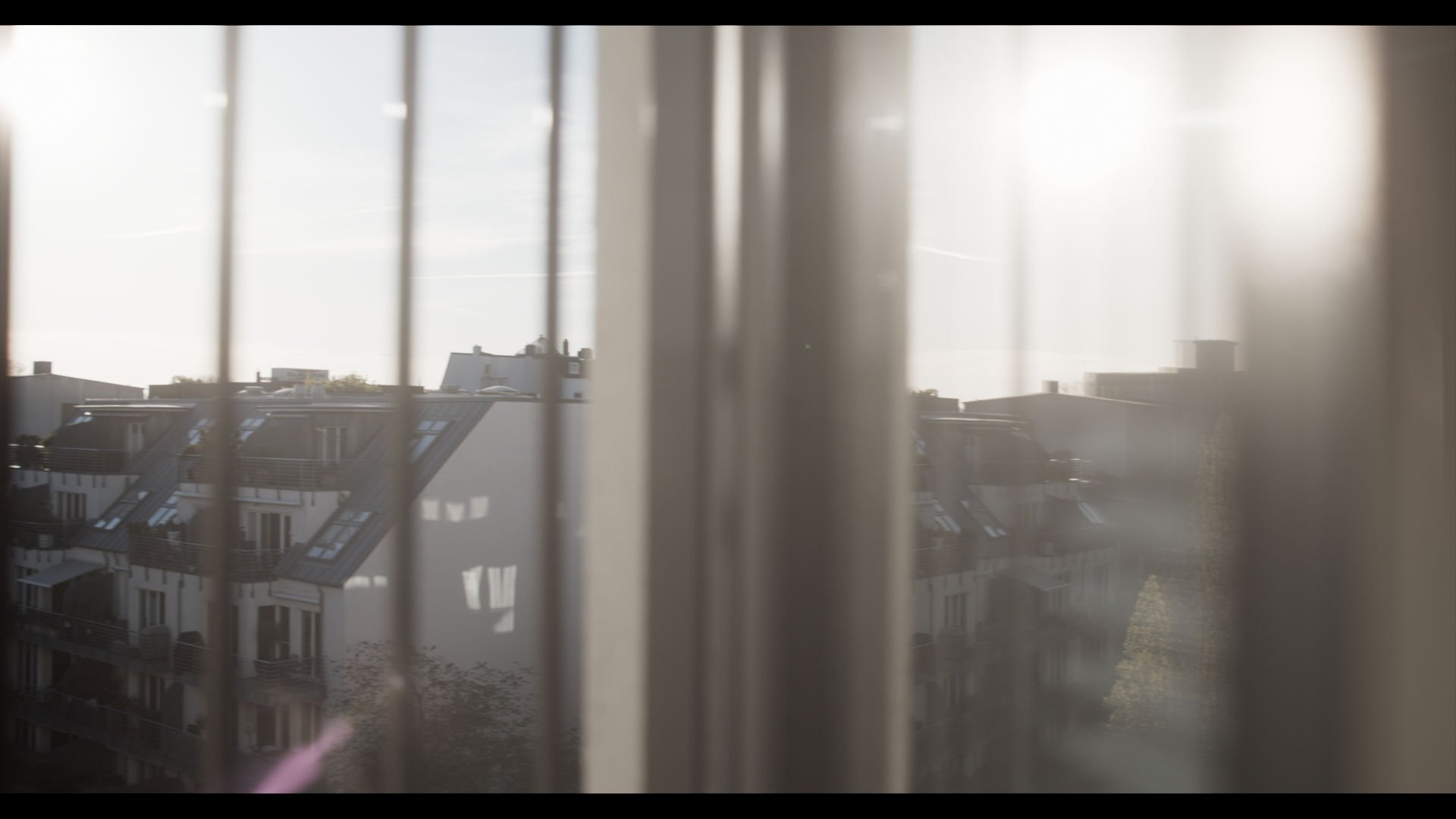

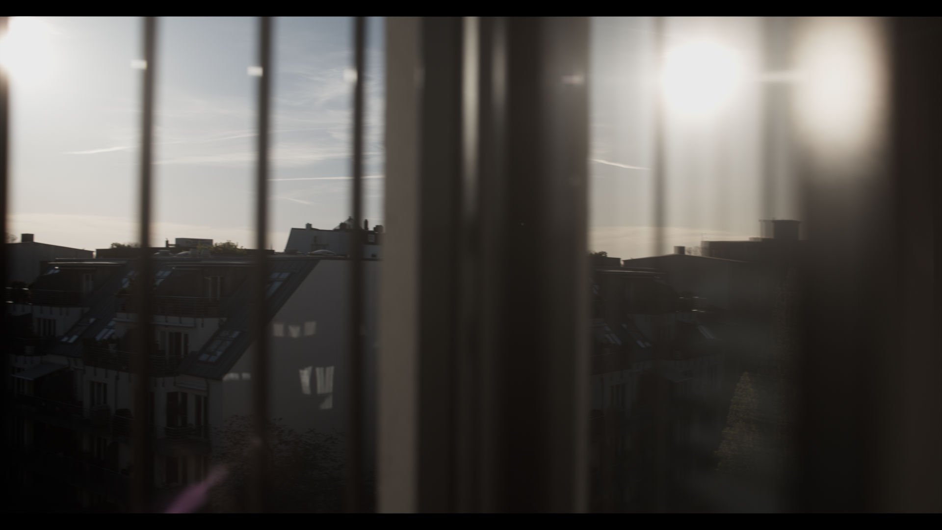

OleB Posted June 11, 2022 Share Posted June 11, 2022 For those of you who would like to play around a little with my method. I have uploaded my sample PRR file with the sun as ultimate highlight and the preset I have created for exposure correction, highlight rolloff etc. into the following folder. 🙂 https://www.dropbox.com/sh/cgm80q9w682oc19/AADWHieOS-Wka9JuD-GnXerca?dl=0 All you need is FCPX (trial is available for free). Am very satisfied with the results. Link to comment Share on other sites More sharing options...
Llaasseerr Posted June 11, 2022 Share Posted June 11, 2022 8 hours ago, OleB said: For those of you who would like to play around a little with my method. I have uploaded my sample PRR file with the sun as ultimate highlight and the preset I have created for exposure correction, highlight rolloff etc. into the following folder. 🙂 https://www.dropbox.com/sh/cgm80q9w682oc19/AADWHieOS-Wka9JuD-GnXerca?dl=0 All you need is FCPX (trial is available for free). Am very satisfied with the results. Thanks for the clip, by way of comparison I rendered it within a basic color managed setup. In this case I decided to ingest the PRR file in Play Pro to V-log/Vgamut based on the included metadata tags. This is assuming that maybe the Ninja V image is just V-log (unconfirmed), so that would create monitoring consistency with the Ninja V. Since I took this into an ACES-managed imaging pipeline, it would not have really mattered if I exported as Alexa LogC, since I would just use the appropriate input transform for the log/gamut encoding into the common ACES space. First I have the ACES default rendering for sRGB (good for web viewing). This is just a film print-like transform that is parametrically generated as opposed to being fixed like a LUT, so it's able to account for the output device. Basically, it's similar to an Arri to Rec709 LUT except it's adjustable on the fly for the output device. If the Ninja V is really showing a V-log image, then you could apply a "V-log to ACES to Rec709" LUT to get the same appearance while shooting.  Next I pulled down the exposure by -2 stops so you can see how the output transform handles the rolloff when there are more distinct transitions visible. The underlying exposure transform is on the linear floating point file, and the final look is just a view transform:  Now I disabled the output transform so you can see the linear file. This is probably the sort of thing people see in FCPX with no transform applied when they first import their PRR footage, with all the info clipped:  This is the same image with -2 stops exposure change so you can see that the highlight detail is in fact there, but it was not in viewing range and with no rolloff to look the way we want: hyalinejim and OleB 2 Link to comment Share on other sites More sharing options...
