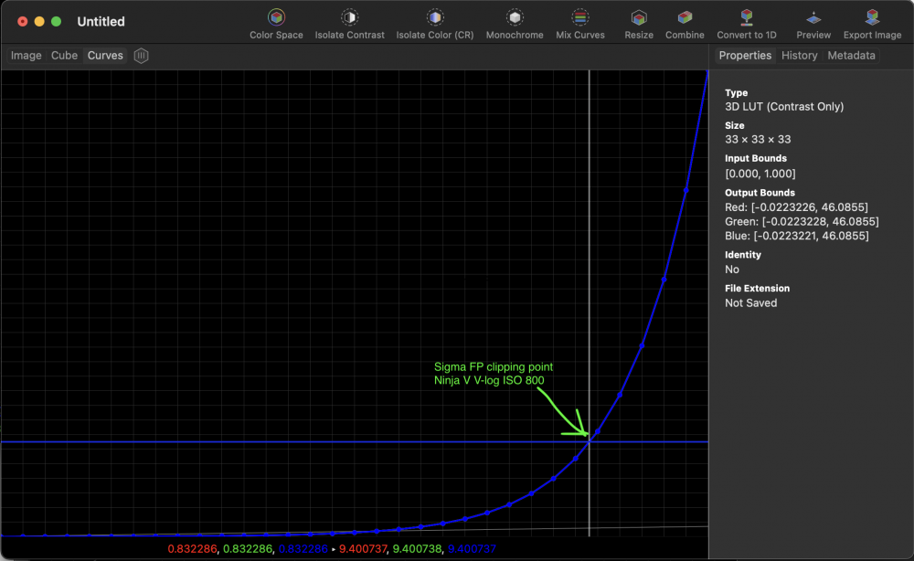

Llaasseerr Posted June 14, 2022 Share Posted June 14, 2022 7 hours ago, OleB said: Have investigated this further. Look what I have found in regards to the fp behavior in RAW on the Atomos. Monitoring of RAW input in: - Native – Linear to VLog for use with 3D LUTs – can use any existing VLog LOOK LUTs - Rec709 – to view RAW input in SDR up to 6.7 stops of dynamic range - HLG – to view RAW in HLG with up 10.5 stops of dynamic range - PQ – to view RAW in PQ/HDR10 with up to 10.5 stops of dynamic range, for scenes with extended spectral highlights. Am about 99% sure that the camera is showing Vlog when switched to native.  OK there you go. So yes it's confirmed that Atomos decided "Native" = Vlog. After you said it, I googled it and found the AtomOS release notes update PDF that you're quoting from. This certainly reduces a lot of uncertainty. It's a shame the Atomos rep was not able to clarify this when I emailed them a while ago. The Vlog curve spec defines 8 stops above middle grey, so the max linear value is 46.0855. (0.18*2*2*2*2*2*2*2*2). The fp sensor clips way before the max value that Vlog was designed to hold so it should not be an issue. Based on the test clip you recently uploaded with the sun clipping out of the window, it's clipping at about 0.833 in Vlog so that would be like 83 IRE. In scene reflectance terms once converted from Vlog to linear in Nuke, that's 9.36. So it's clipping more than 2 stops below the Vlog max value. This screengrab illustrates where that is in relation to the entire scene reflectance range defined by the Vlog curve. Specifically this shows a Vlog to linear transform, so it's the inverse of a Vlog curve. At the bottom, the input numbers represent the equivalent of an "IRE value" (0.83) and the output numbers represent the scene linear value (about 9.4, matches Nuke). So as you can see, there's a ton of headroom remaining that will never get used.  7 hours ago, OleB said: As far as I understand from the Vlog white paper 90% reflection is located at about 60 IRE, on ISO 100 the fp clips at about 62 IRE. The higher you go with the ISO (up to ISO 800). The more headroom on top is available.  That means on the same Vlog to linear transform the input is about 0.59 and the output is 0.9. Here's a screengrab showing you how much extra headroom you get for capturing highlights above that. You basically get all of the curve to the right of the green arrow I drew.  So while it's not ideal that Sigma don't have their own log curve, Vlog is okay as a monitoring option on the Ninja V. 8 hours ago, OleB said: However I am not too sure if this is at least for me a good way of working since I do not know if the next step would be now to figure out the native ISO of the camera for maximum DR in Vlog? It doesn't matter what ISO you use, you will never use up all of Vlog. This is assuming there's no funny business going on where the Atomos is somehow clipping the highlights as they come in from the camera, but I doubt that. 8 hours ago, OleB said: For now I prefer the manual colorspace matching in FCPX directly from the untouched linear RAW, which gives me great results. And with the PQ view in the monitor I can get a really good idea on how the picture will look like. Just to clarify, it doesn't matter which monitoring option you choose on the Ninja V, the underlying file is exactly the same. The difference between monitoring in PQ or V-log is that Vlog requires you add your own LUT, while PQ out of box creates a "display" image that takes advantage of the extra nits of the Ninja V but it's just a consumer HDR display standard for TVs. So if you want to view the same image while shooting as in your timeline, you would match the display settings in both the Ninja V and FCPX, which is all you do in any software/hardware combo anyway. All that's been figured out is that the "Native" input is a known log format (Vlog), so that means it's easy to figure out how to load the look from your editing/grading software into the Ninja V.     OleB and Noli 1 1 Link to comment Share on other sites More sharing options...
OleB Posted June 15, 2022 Share Posted June 15, 2022 Thank you for the extensive write-up Llaasseerr. Agree, that with the V-log LUT loaded on the Ninja V you have something to work with. If you select the same in FCPX the result is very close to what has been shown on the monitor. Now the only thing I do not understand ist that in native (V-log) mode the clipping points of the sensor are different with the various ISO settings. I would have expected that the DR is the same for every ISO setting...Let me give you some values to show you what I mean. ISO 100 - clips at about 65 IRE ISO 200 - clips at about 75 IRE ISO 400 - clips at about 82 IRE ISO 800 - clips at about 90 IRE ISO 1600 - clips at about 90 IRE ISO 3200 - clips at about 85 IRE ISO 6400 - clips at about 90 IRE rest stays at 90 IRE  The noise floor / black level stays the same for every ISO setting. About 8 IRE. What might be behind this? When reading these figures I would assume that for max DR I should use ISO 800... When inspecting the scene with the LUT thrown on you are facing a situation where the absolute whites on ISO 100 are not reaching red, and cannot go higher than yellow. This is confusing me, because I am not understanding the intention behind this, if any. If you can shed some light on this, would love to hear 🙂  Link to comment Share on other sites More sharing options...
Llaasseerr Posted June 15, 2022 Share Posted June 15, 2022 7 hours ago, OleB said: Thank you for the extensive write-up Llaasseerr. Agree, that with the V-log LUT loaded on the Ninja V you have something to work with. If you select the same in FCPX the result is very close to what has been shown on the monitor. Now the only thing I do not understand ist that in native (V-log) mode the clipping points of the sensor are different with the various ISO settings. I would have expected that the DR is the same for every ISO setting...Let me give you some values to show you what I mean. ISO 100 - clips at about 65 IRE ISO 200 - clips at about 75 IRE ISO 400 - clips at about 82 IRE ISO 800 - clips at about 90 IRE ISO 1600 - clips at about 90 IRE ISO 3200 - clips at about 85 IRE ISO 6400 - clips at about 90 IRE rest stays at 90 IRE  The noise floor / black level stays the same for every ISO setting. About 8 IRE. What might be behind this? When reading these figures I would assume that for max DR I should use ISO 800...   This clipping point is in line with the characteristics of the PRR test clips you uploaded before, and broadly speaking, also the behaviour of the DNGs, so I don't see anything strange here. We established that up to ISO 800 was an amplification of the base ISO 100 signal so the clipping point is raised accordingly. As the signal increases it should also be raising the noise floor obviously, but we noticed that the noise floor stays pretty low which is a nice win. For whatever reason, this taps out above ISO 800, so there are diminishing returns as far as overall dynamic range. When a camera is baking in the ISO change, the clipping point would ideally continue to increase. Maybe Sigma prioritized a clean noise floor instead of highlights for the higher ISO ranges (>800). So using ISO 800 is a decent option. Regarding ISO 3200, the higher base ISO, it has a lower clipping point but my observation is that it has a proportionally lower noise floor. So my recommendation for absolute max DR was to shoot 3200 at least -1 stop underexposed since you could raise the noise floor and it would be the same as ISO 800/1600, but with additional highlight headroom. If you think about it, this is in line with the expected behavior with higher base ISOs: lower noise floor and slightly lower highlight clipping point. I understand this is a bit of a headache to track for a marginal gain, so shooting ISO 800 is a good rule of thumb to get max DR to keep things simple.  7 hours ago, OleB said: When inspecting the scene with the LUT thrown on you are facing a situation where the absolute whites on ISO 100 are not reaching red, and cannot go higher than yellow.  Well again, the IRE value is LUT or view gamma-dependent, but your numbers make sense. The base ISO 100 has a lower clipping point than ISO 800 which is baking in an amplification of the signal, but somehow also keeping a similar noise floor. For example with this ISO 800 test clip, when importing as V-log into ACES and viewed through the standard ACES output display transform the clipping point is in the high 90's so it stands to reason that ISO 100 would clip lower.    OleB and Noli 2 Link to comment Share on other sites More sharing options...

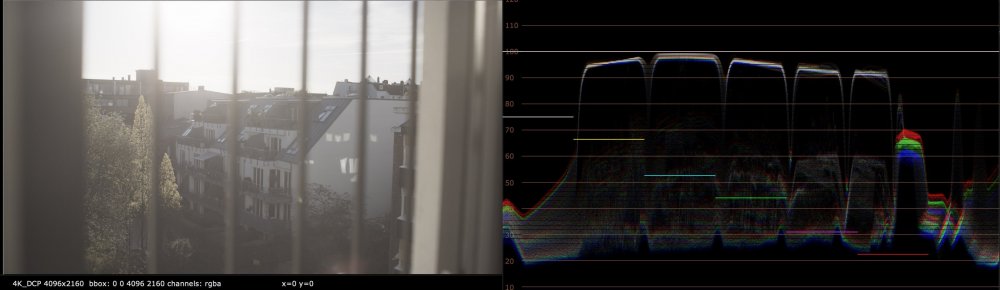

Llaasseerr Posted June 27, 2022 Share Posted June 27, 2022 @OleBÂ I atted you for my last post but it wasn't highlighted, so you may not have seen it. I was having issues exposing, but I realized I made an error with my ND filter. All good now. I was able to expose 3200 by setting the light meter for 640. Thanks for your detective work. Seems to work fairly well with getting middle grey at close to 42 IRE on the Vlog display on the Ninja, then I can flick on a viewing LUT. I could also do it directly through the LUT. I just need to confirm in Resolve where middle grey falls on the waveform. OleB 1 Link to comment Share on other sites More sharing options...

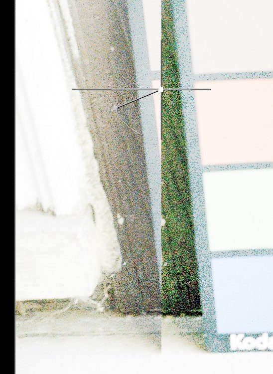

Andrew K White Posted June 29, 2022 Share Posted June 29, 2022 @Llaasseerr Hi, I've read this discussion from the beginning trying to grasp my head around coloring with the FP. I'm curious about your statement that you think the false colors on the camera can show the clipping levels for the sensor itself, since that isn't my experience when I view them. For example, at ISO 800 the false colors on the camera show clipping (whereas for the same scene at ISO 100 the false colors do not show clipping), and I'm able to bring the highlights into viewable range in post after recording at ISO 800. Link to comment Share on other sites More sharing options...

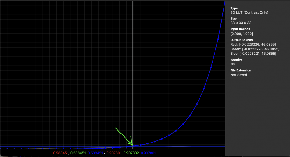

Llaasseerr Posted June 29, 2022 Share Posted June 29, 2022 56 minutes ago, OleB said: I came to this because if you select something lower than ISO 320 you will reach sensor clipping before 100 IRE in the LUT. Do not know if this is intentional or I am misunderstanding something though... There's no rule that a LUT has to necessarily show sensor clipping at 100 IRE, especially at a low ISO. If you look at the linear clipping value at low ISO especially on the Ninja V which does not use highlight reconstruction, it's a very low value and gives the impression that the fp is bad with highlight detail. So if you transform that low value to Vlog then apply a Vlog to Rec709 curve, I can't imagine it would get anywhere near 100 IRE, but it would also not be indicative of what is the native ISO. Depending on how aggressive the highlight rolloff is on a log to 709 LUT, it can be hard for anything to get to 100 IRE so viewing in log might be a better way to measure max IRE from the sensor. Â OleB 1 Link to comment Share on other sites More sharing options...
OleB Posted June 30, 2022 Share Posted June 30, 2022 Ok thanks. That seems logical.  However we now have established that ISO100-800 is the same in regards to sensor clipping.  If you check the fp dual iso manual. The most balanced amount of stops above and below middle grey is with ISO 800. comparing this chart to the one from ARRI Alexa is very similar with the Alexa having more steps. But ARRI gives 800 as native value. As from my understanding than both cameras could have an EI of 800 as base and decreasing ISO relocates the stops more to the dark side. With the Alexa you can do the opposite as well, while with the fp you will not get more steps available for the highlights than with ISO800.    Link to comment Share on other sites More sharing options...

Llaasseerr Posted July 6, 2022 Share Posted July 6, 2022 On 6/29/2022 at 4:51 PM, Andrew K White said: @Llaasseerr Hi, I've read this discussion from the beginning trying to grasp my head around coloring with the FP. I'm curious about your statement that you think the false colors on the camera can show the clipping levels for the sensor itself, since that isn't my experience when I view them. For example, at ISO 800 the false colors on the camera show clipping (whereas for the same scene at ISO 100 the false colors do not show clipping), and I'm able to bring the highlights into viewable range in post after recording at ISO 800. Maybe what you are referring to is that with the Ninja V, Atomos decided to encode the linear raw image as Panasonic V-log, which does bring the highlights into a viewable range as a log image and would allow false color monitoring if the false color tool is expecting a Vlog input. So basically they are making up for one of the camera's deficiencies. I need to check more carefully but I'm pretty sure the internal image as displayed on the camera is clipping the highlights, at least in "OFF" color mode which is what I set it to. Because all it's doing is applying a Rec709 curve with no highlight shaping to a linear raw image and that causes anything above a certain level to get clipped. I hope the false color tool in the v4 firmware can be used to accurately check middle grey - but not highlights. This is assuming that the false color tool does read values directly from the sensor, which someone else mentioned. Link to comment Share on other sites More sharing options...
