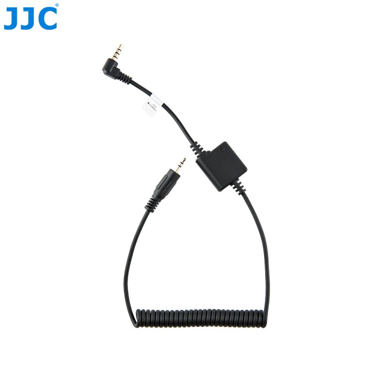

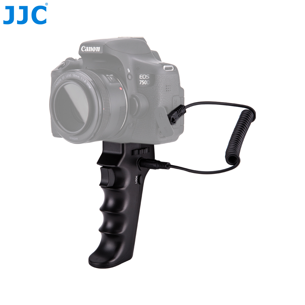

Anaconda_ Posted September 8, 2022 Share Posted September 8, 2022 Does anyone know of a pistol grip with working start / stop for the FP? I feel like it'd be a great camera to use that way, with the LVF-11. Link to comment Share on other sites More sharing options...

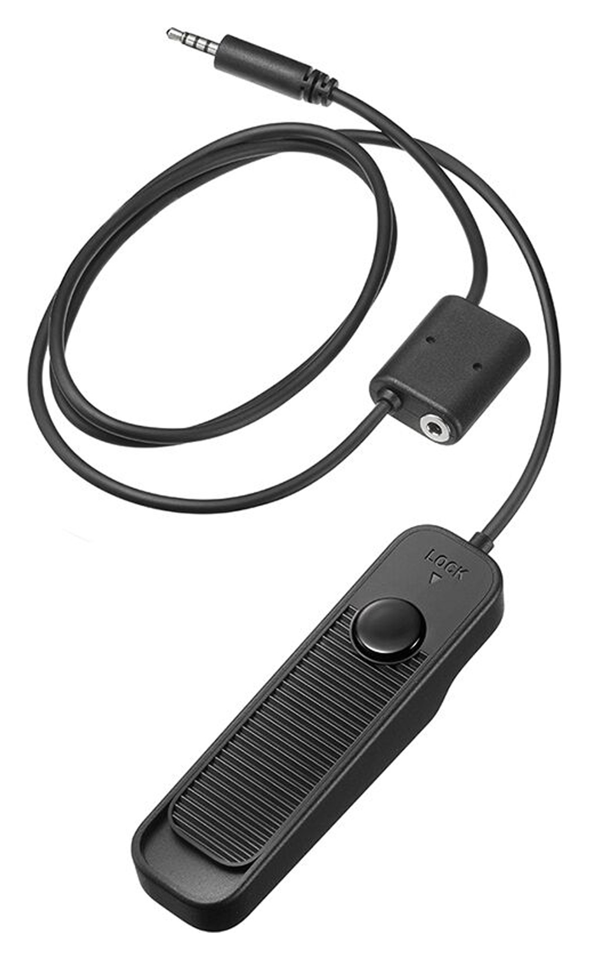

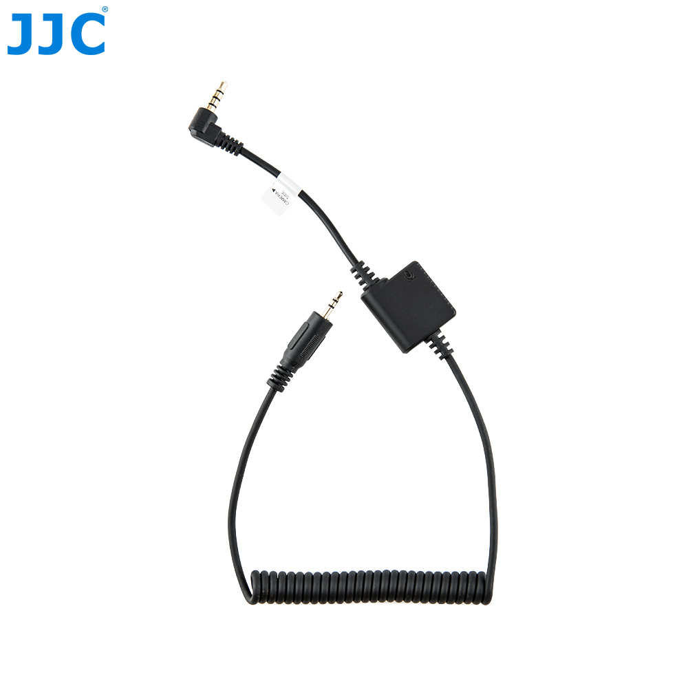

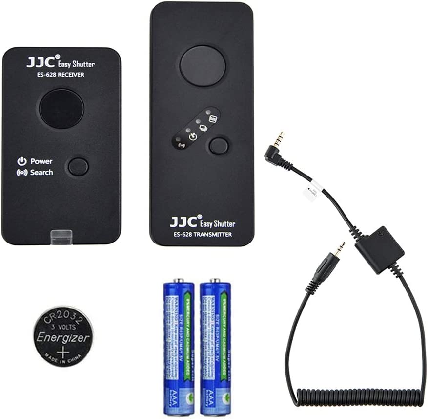

Super Members BTM_Pix Posted September 8, 2022 Super Members Share Posted September 8, 2022 33 minutes ago, Anaconda_ said: Does anyone know of a pistol grip with working start / stop for the FP? I feel like it'd be a great camera to use that way, with the LVF-11. Sigma's official trigger input cable is called the CR-41 and connects to the mic port with a split input to still allow to connect a mic. Its about €50 and could be used by grafting it onto a pistol grip. However, JJC do a compatible version that comes out to a cable rather than a switch and its about €18. JJC also do a pistol grip for around €22 that you can then plug that cable into to complete the process. The good thing about the pistol grip is that you can then use other compatible cables for different cameras so it isn't tied to just one brand. Anaconda_ 1 Link to comment Share on other sites More sharing options...
Super Members BTM_Pix Posted September 8, 2022 Super Members Share Posted September 8, 2022 Incidentally, JJC also do a bundle kit with the same cable to provide a wireless solution for the FP for about €34 so it might be worth paying the extra €16 to get that facility as well. Leon Postma 1 Link to comment Share on other sites More sharing options...
Anaconda_ Posted September 10, 2022 Share Posted September 10, 2022 Awesome, thank you! Link to comment Share on other sites More sharing options...
