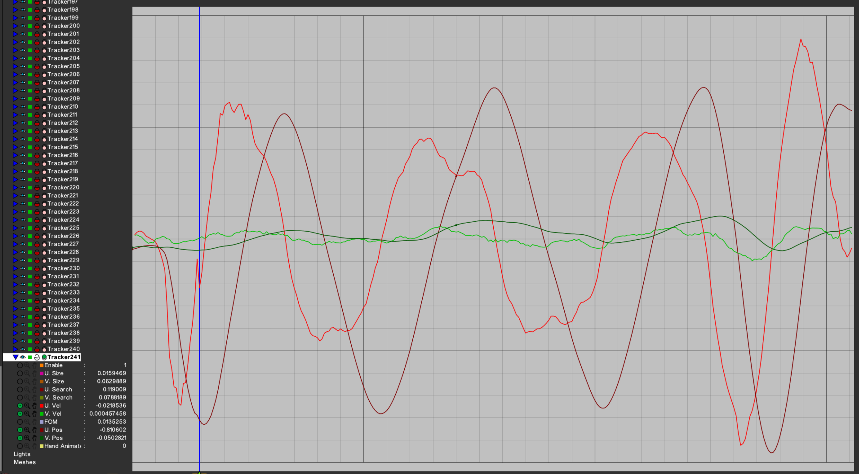

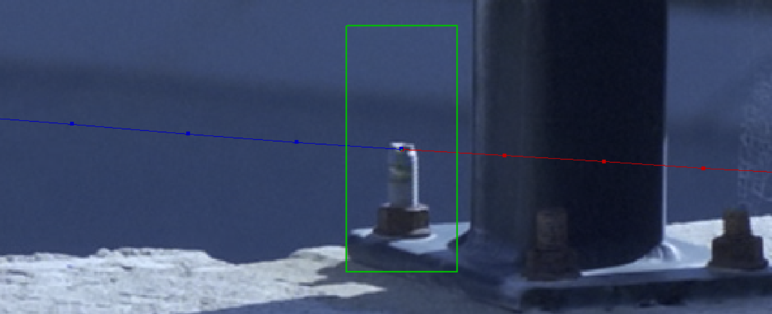

Towd Posted July 10, 2020 Share Posted July 10, 2020 Okay, so I looked at the video you posted and ran it through a 3D tracking/camera solving app I own called "SynthEyes". Here is the test object I tracked: And this is a graph of it's 2D motion. From what I'm seeing, the horizontal motion seems pretty smooth. The bright red is velocity changes in X and the dark red (brown) is the position changes. Even the velocity changes seem pretty smooth. You mention having the IBIS turned on. I think I'd definitely turn that off because who knows what it is adding to the test. I noticed specifically on the frame where the blue vertical line is (where I had the play head) there is a big bump in velocity. That was probably the floating sensor adjusting to the fact that you were changing the direction of you pan from left to right around that time and it stuttered a bit-- confused on what to lock to. I also resampled the footage down into an 1080p MXF video for playback on my 1080p 120hz monitor and to be honest it looked really smooth. One thing I noticed when trying to play back the original file was a lot of stuttering because my PC couldn't decode the 10 bit UHD in real time. That would definitely lead to cadence issues if you are having a similar issue. It's really important that you're not dropping frames during playback. Before we had realtime playback of video, animators used to use flipbook software to load all their frames into RAM to ensure they were not dropping frames. You might want to try that to ensure you are not dropping frames during playback if you are unsure. There is an open source one I use occasionally called DJV that is pretty good. It wont playback 30 minutes of UHD video because you have to load everything into ram, but it might work in a pinch for short clips. Link: https://darbyjohnston.github.io/DJV/ Anyway, I'm still interested in more tests, but from my end, I think the motion on the GH5 looks pretty good and smooth. Link to comment Share on other sites More sharing options...

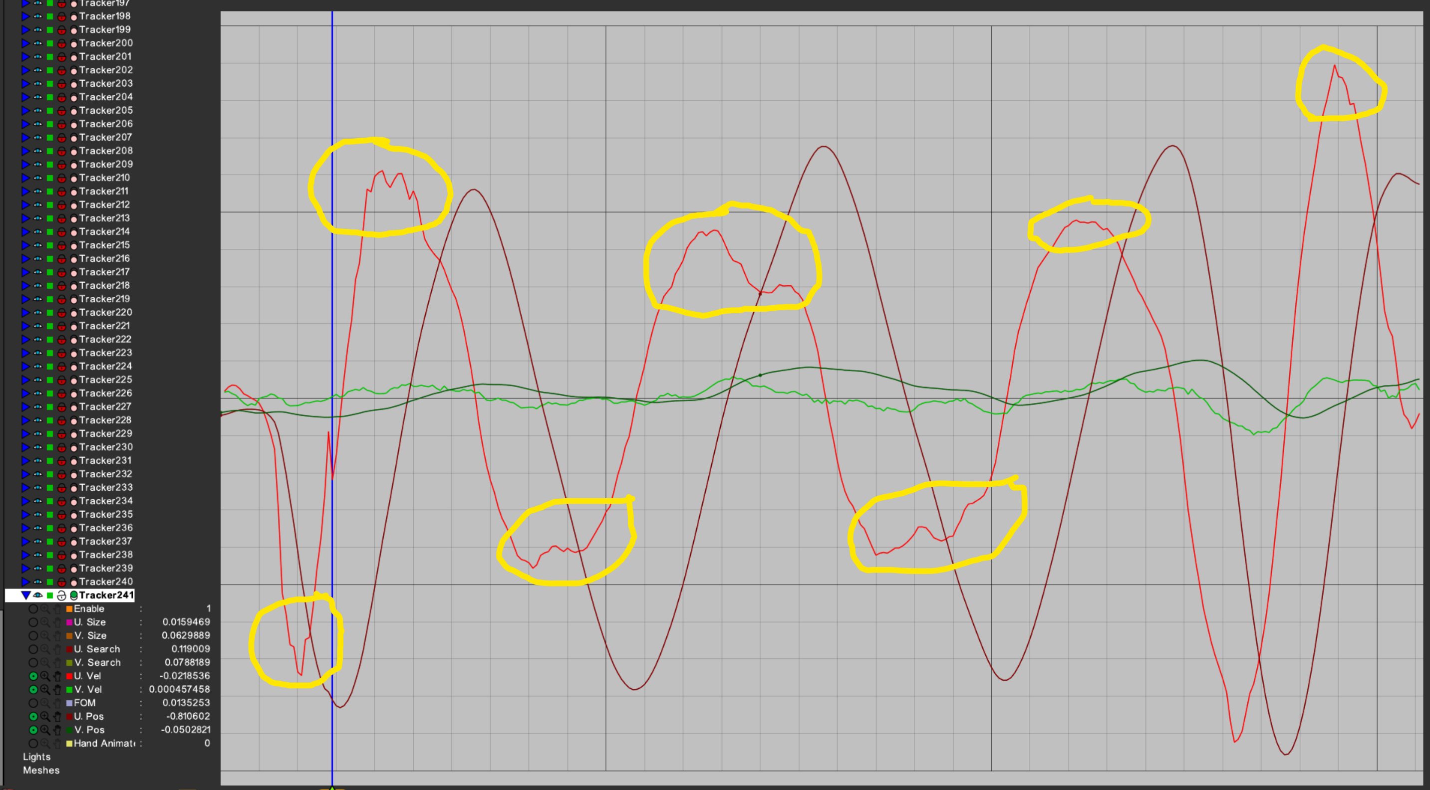

Towd Posted July 10, 2020 Share Posted July 10, 2020 Thinking about it some more, I could see where these marked velocity changes in the middle of the pan could be possibly seen a motion cadence problems and they should correspond to what Kye was graphing in his plots-- that is the change in X on each frame. But to my eye they are fairly inconsistent in smoothness on each pan. Some pans were really smooth and some have a bit of random jumpiness which leads me to believe they are probably random noise introduced by the IBIS, or subtle irregularities in Kye's panning. Link to comment Share on other sites More sharing options...

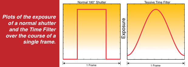

Super Members BTM_Pix Posted July 11, 2020 Super Members Share Posted July 11, 2020 While you are down this rabbit hole, you might want to take a look at the RED Motion Mount that they did for the EPIC. http://docs.red.com/955-0013/REDMOTIONMOUNTOperationGuide/Content/1_MM_Intro/1_Intro.htm As well as doing vari ND, it had a few tricks including simulating soft shutter and square shutter. There are links within that page to other explanatory documents about the process. What may be of use to you are the videos of it in action such as this one as its a unique reference really to how the look of the same camera can be changed with these simulations. kye and Towd 1 1 Link to comment Share on other sites More sharing options...
kye Posted July 11, 2020 Author Share Posted July 11, 2020 @BTM_Pix that motion mount is AWESOME! It also, unfortunately, probably means that there's patents galore in there to stop other camera companies from implementing such a thing. eND that does global shutter with gradual onset of exposure is such a clever use of the tech. What is interesting is how much it obscures the edges when in soft shutter mode. Square: Soft: This would really make perception of jitter very difficult as there's no harsh edges for the eye to lock onto, effectively masking jitter from the camera. And integrating ND into it as well is great. One day maybe we'll have an eND in every camera that can do global shutter, soft shutter, and combined with ISO will give us full automatic control of exposure from starlight to direct sunlight, where we simply specify shutter angle and it takes care of the rest. The future's so bright, I have to wear eNDs. Link to comment Share on other sites More sharing options...
