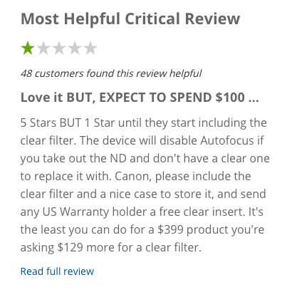

Super Members BTM_Pix Posted July 12, 2020 Super Members Share Posted July 12, 2020 46 minutes ago, ntblowz said: https://www.bhphotovideo.com/c/product/1434115-REG/canon_3444c001_drop_in_clear_filter_a.html Seriously just a cover will do, dont need clear filter in the rear.. wonder if 3rd party gonna make one? I understand it disables the AF if you don't have either filter in. I'm guessing its microswitches inside the host adapter that are pressed when you slide them in so the camera knows you have inserted one or the other. So if its just physical then someone could make an empty 3D printable version of the holder to trick it. Link to comment Share on other sites More sharing options...
ntblowz Posted July 12, 2020 Share Posted July 12, 2020 6 minutes ago, BTM_Pix said: I understand it disables the AF if you don't have either filter in. I'm guessing its microswitches inside the host adapter that are pressed when you slide them in so the camera knows you have inserted one or the other. So if its just physical then someone could make an empty 3D printable version of the holder to trick it. it doesn't disable AF when there is no filter in, i use it a few times with open hole when it is too dark.. but later found dust on the senor ugh. current budget solution is have tape with me to seal it lol. BTM_Pix 1 Link to comment Share on other sites More sharing options...
Super Members BTM_Pix Posted July 12, 2020 Super Members Share Posted July 12, 2020 2 minutes ago, ntblowz said: it doesn't disable AF when there is no filter in, i use it a few times with open hole when it is too dark.. but later found dust on the senor ugh. current budget solution is have tape with me to seal it lol. Thats good to know. The AF bit, not the dust bit. Not sure why BH don't address that on the "most helpful" bad review of it on their site ! Link to comment Share on other sites More sharing options...

ntblowz Posted July 12, 2020 Share Posted July 12, 2020 1 hour ago, BTM_Pix said: Thats good to know. The AF bit, not the dust bit. Not sure why BH don't address that on the "most helpful" bad review of it on their site ! Yeah that review is completely false! I just tested again with no filter on the adapter and AF is working fine. BTM_Pix 1 Link to comment Share on other sites More sharing options...
Super Members BTM_Pix Posted July 12, 2020 Super Members Share Posted July 12, 2020 12 minutes ago, ntblowz said: Yeah that review is completely false! I just tested again with no filter on the adapter and AF is working fine. Should be easy for someone to make a non tape based solution then to plug the hole. Although.... Maybe someone enterprising could incorporate an exhaust fan into that slot for the R5 users 😉 ntblowz 1 Link to comment Share on other sites More sharing options...
Trek of Joy Posted July 13, 2020 Share Posted July 13, 2020 16 hours ago, ntblowz said: Yeah that review is completely false! I just tested again with no filter on the adapter and AF is working fine. Good to know - no changes in either photo or video modes? I've held off getting the ND adapter because of the cost of the clear glass filter. So I just went with the standard EF-RF adapter, FYI got it cheap off the Canon refurb site in case anyone wants one. I'm fine with throwing some gaff tape on there, but I'm not shelling out that kind of cash for a needless piece of glass. Keeping an eye out for a used one... Chris Link to comment Share on other sites More sharing options...
