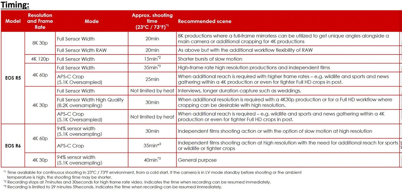

Yurolov Posted July 15, 2020 Share Posted July 15, 2020 1 minute ago, Video Hummus said: yes where does it say this? and what are the times for the overheating? Same as for 30p? Link to comment Share on other sites More sharing options...
Video Hummus Posted July 15, 2020 Share Posted July 15, 2020 @Yurolov Andrew has already posted about it on the main page. All oversampled modes except the APS-C crop have a recording limit. The only full sensor FF mode that doesn’t over heat is pixel binned. Which in my opinion makes the R5 a better buy over the R6. Link to comment Share on other sites More sharing options...
Silenkiller Posted July 15, 2020 Share Posted July 15, 2020 1 hour ago, Video Hummus said: @Yurolov Andrew has already posted about it on the main page. All oversampled modes except the APS-C crop have a recording limit. The only full sensor FF mode that doesn’t over heat is pixel binned. Which in my opinion makes the R5 a better buy over the R6. I want to see someone record that pixel binned 4k at 95 degrees to see what happens Link to comment Share on other sites More sharing options...

Yurolov Posted July 15, 2020 Share Posted July 15, 2020 10 hours ago, Video Hummus said: @Yurolov Andrew has already posted about it on the main page. All oversampled modes except the APS-C crop have a recording limit. The only full sensor FF mode that doesn’t over heat is pixel binned. Which in my opinion makes the R5 a better buy over the R6. I must be crazy but I don't see any mention of 24 or 25 in the chart? How do we know that the only FF sensor mode that doesn't overheat is the pixel binned mode? I can't read that anywhere either. They sure make it difficult to find the info. Link to comment Share on other sites More sharing options...
Video Hummus Posted July 15, 2020 Share Posted July 15, 2020 2 minutes ago, Yurolov said: I must be crazy but I don't see any mention of 24 or 25 in the chart? How do we know that the only FF sensor mode that doesn't overheat is the pixel binned mode? I can't read that anywhere either. They sure make it difficult to find the info. We are assuming, based on the chart, that the 4K30p includes 24/25 fps. Logic would assume so, the canon cripple hammer works in mysterious ways however. Link to comment Share on other sites More sharing options...
Yurolov Posted July 15, 2020 Share Posted July 15, 2020 5 minutes ago, Video Hummus said: We are assuming, based on the chart, that the 4K30p includes 24/25 fps. Logic would assume so, the canon cripple hammer works in mysterious ways however. I doubt Andrew would be so vociferous just based on an assumption, seeing as short films, music videos etc are all done at 24/25p. There must be some more info out there that I haven't seen. Link to comment Share on other sites More sharing options...
