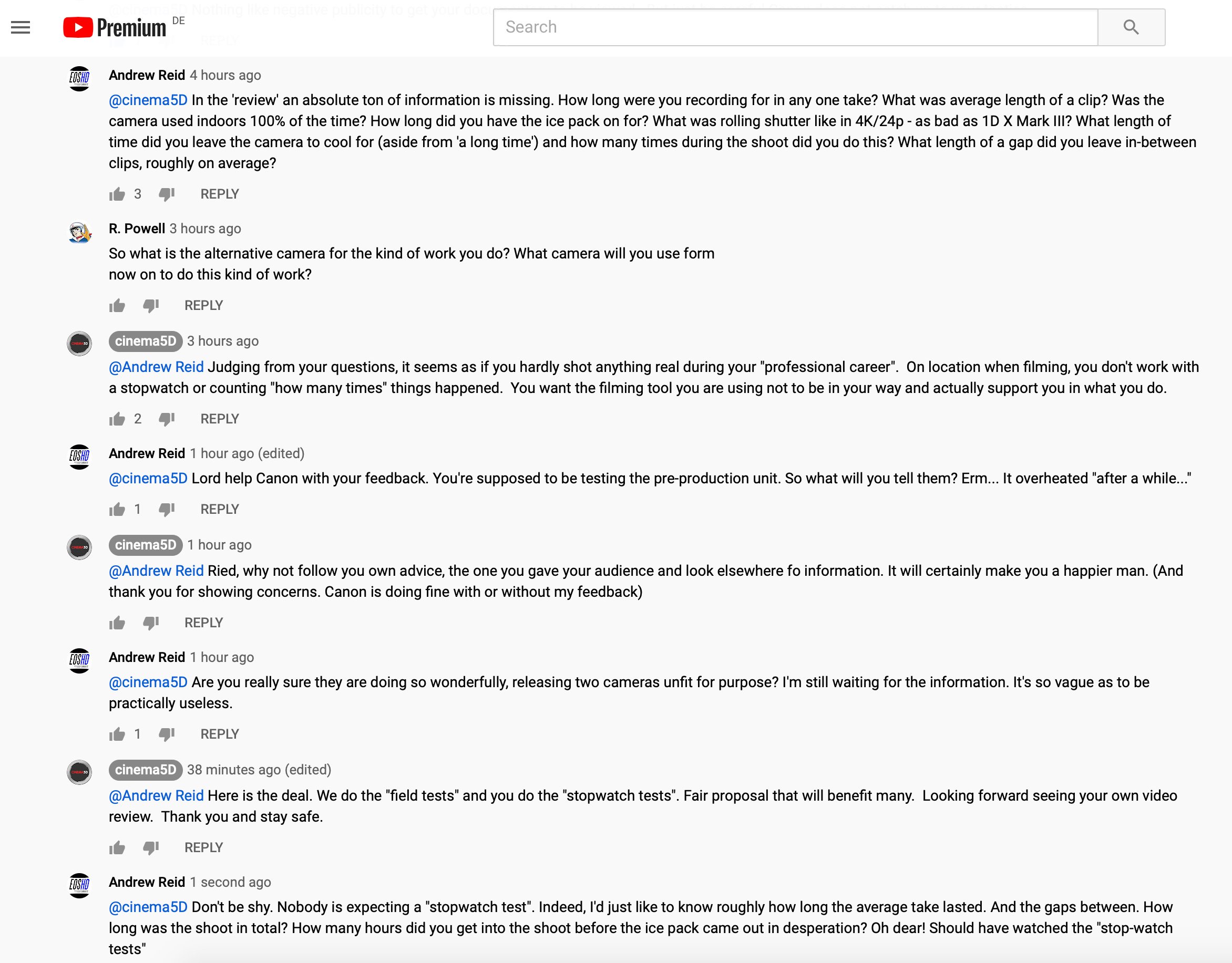

Administrators Andrew Reid Posted July 24, 2020 Administrators Share Posted July 24, 2020 5 hours ago, herein2020 said: For me that camera is DOA if that is how it performs in the real world. My GH5 has NEVER overheated and it regularly shoots after sitting in a 120 degree car, in hot direct Florida sunlight and nearly always at 4K60FPS. There is so much info missing from the C5D 'review' but it isn't looking good. How long was his average take How long was the average break and how many, through the entire shoot How long was his longest take How long was the average gap inbetween clips When the ice pack came out, how many hours was he into the shoot How many hours was the total shoot?? Was the camera switched on all the time, even when not recording If so for how long How much was indoors, how much outside? Was it sunny? What was the temp indoor? There is less technical and detailed info in the review than in the average episode of The Simpsons SteveV4D 1 Link to comment Share on other sites More sharing options...
Yurolov Posted July 24, 2020 Share Posted July 24, 2020 1 hour ago, Andrew Reid said: There is so much info missing from the C5D 'review' but it isn't looking good. How long was his average take How long was the average break and how many, through the entire shoot How long was his longest take How long was the average gap inbetween clips When the ice pack came out, how many hours was he into the shoot How many hours was the total shoot?? Was the camera switched on all the time, even when not recording If so for how long How much was indoors, how much outside? Was it sunny? What was the temp indoor? There is less technical and detailed info in the review than in the average episode of The Simpsons It is a disaster of a review. Purely anecdotal evidence with no actual numbers. I think the most we can take out is it can't be used on professional jobs at all in high temperatures (summer in Japan). I am first one to put up my hand and say I thought it was a great camera coming out, but this is unmitigated disaster. Canon are done as far as I am concerned. Link to comment Share on other sites More sharing options...

Administrators Andrew Reid Posted July 25, 2020 Administrators Share Posted July 25, 2020 2 hours ago, Yurolov said: It is a disaster of a review. Purely anecdotal evidence with no actual numbers. I think the most we can take out is it can't be used on professional jobs at all in high temperatures (summer in Japan). I am first one to put up my hand and say I thought it was a great camera coming out, but this is unmitigated disaster. Canon are done as far as I am concerned. I tried to tease the basics out of him but he was having none of it. Just the usual Cinema5D c**ty line of "you're just a tester, leave the actual filmmaking work to us"! Yurolov, Video Hummus and mechanicalEYE 3 Link to comment Share on other sites More sharing options...
Administrators Andrew Reid Posted July 25, 2020 Administrators Share Posted July 25, 2020 mechanicalEYE 1 Link to comment Share on other sites More sharing options...
mechanicalEYE Posted July 25, 2020 Share Posted July 25, 2020 7 minutes ago, Andrew Reid said: LOL Safe bet that Behiri's response to this would be: Chris and Jordan are just testers, what do they know about real film making? Link to comment Share on other sites More sharing options...
Administrators Andrew Reid Posted July 25, 2020 Administrators Share Posted July 25, 2020 Behiri's motto seems to be Professional filmmaking is what you do, not what it looks like! Link to comment Share on other sites More sharing options...
