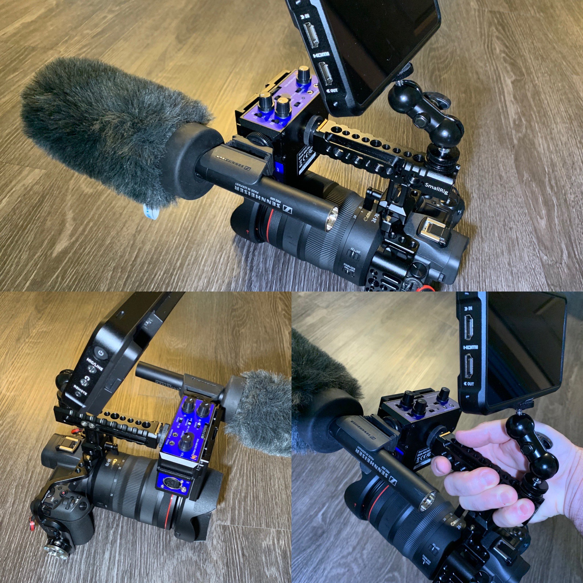

Trek of Joy Posted July 17, 2020 Share Posted July 17, 2020 This is the best I could come up with as a handle only setup using my parts and not adding a side grip for two handed stuff, though I usually have the monitor attached to the front of the handle, a G3 wireless receiver on the back plugged into the camera, along with a grip on the right side. Its actually pretty well balanced as pictured and cables don't get in the way. A smaller mic and XLR solution like the Saramonic would make things more compact. Smallrig makes a side handle with a shoe, typically I put the audio adapter with the mic on top of it on the right side. If I weren't shooting on a gimbal all the time I'd do a setup like bjohn's and make it a little more permanent. ENG cameras used to be much larger, I shot on a Betacam with my first job, it balanced really nice on the shoulder and handheld stuff looked good because the large top handle made it easy to find that balance point, but its a different visual as you couldn't do things like simulated jib shots or shoot at waist level as easily because it was a little unwieldily - basically it was on the sticks, the shoulder or around the knees, other stuff required some contortionist stuff to get into position. That's a main achilles heel of small or mirrorless cameras if you need audio and onboard monitoring, once you add a monitor and XLR audio you start to get a little franken-rig thing going. Chris kye 1 Quote Link to comment Share on other sites More sharing options...

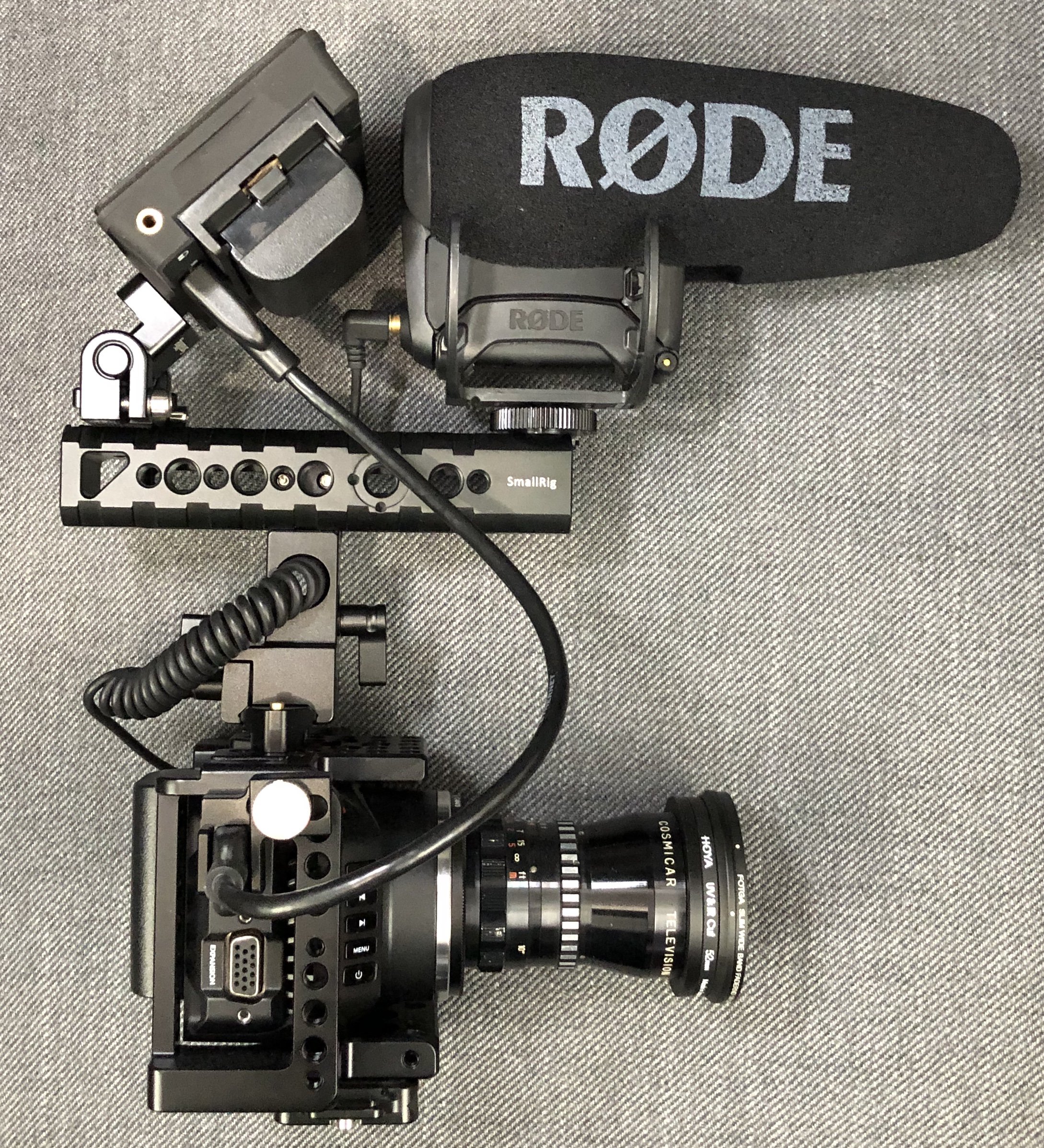

kye Posted July 24, 2020 Author Share Posted July 24, 2020 Played around and got this configuration which seems to meet all the criteria... It's a bit top heavy, but it's balanced (it literally stands up on the QR plate when placed on a flat surface). You can get to the handle, at least from the left, without touching anything but the handle, and the big hole in the vertical support even lines up very nicely with the coiled cable for the mic making a convenient cable tidy! It's not exactly compact or elegant though! Trek of Joy 1 Quote Link to comment Share on other sites More sharing options...
bjohn Posted July 24, 2020 Share Posted July 24, 2020 Looks good. I'll be curious to see if the fan noise from the Micro is a problem in your audio recordings. Even with my Sennheiser 8060 shotgun I could hear the fan if I had the mic on camera or anywhere near it, at least if I was in a reverberant room (wooden floors). Of course if you record 10-15 seconds of room tone at the beginning you can eliminate the fan sound with Izotope RX, Acon Acoustica, or any other good audio noise reduction program. kye 1 Quote Link to comment Share on other sites More sharing options...
kye Posted July 24, 2020 Author Share Posted July 24, 2020 I don't have any real shoots planned for this setup, but was just part of getting to know the camera and prepared in case. Quote Link to comment Share on other sites More sharing options...
