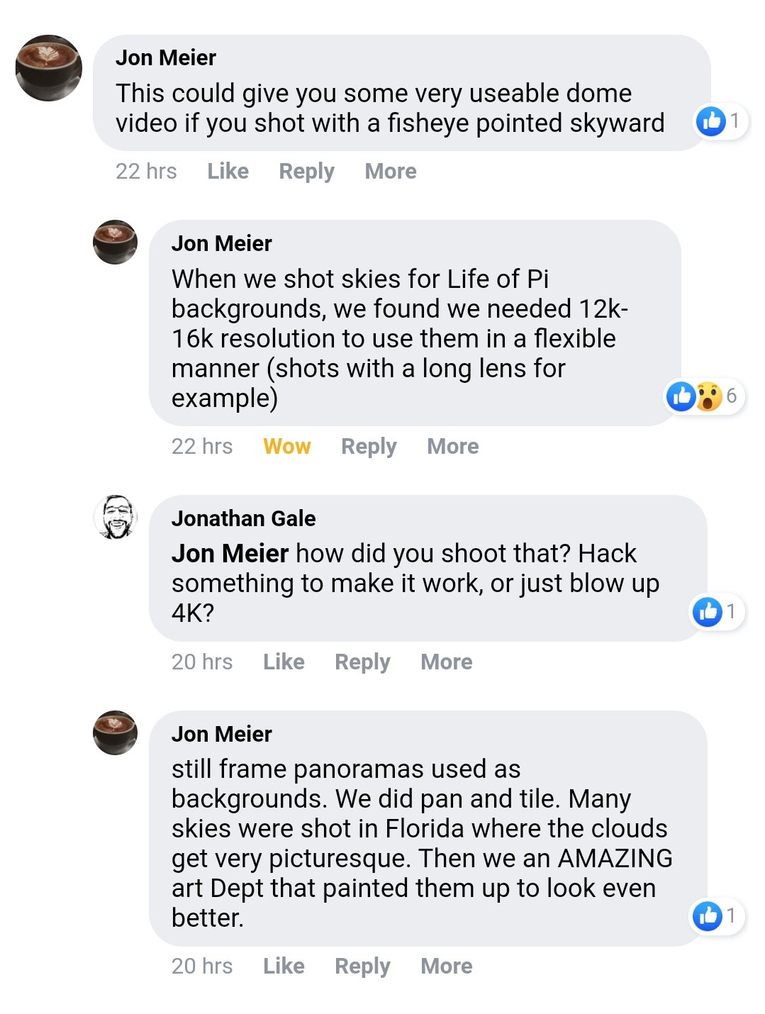

ntblowz Posted July 17, 2020 Share Posted July 17, 2020 From people who worked on Life of Pi they need 12-16k resolution for background Link to comment Share on other sites More sharing options...

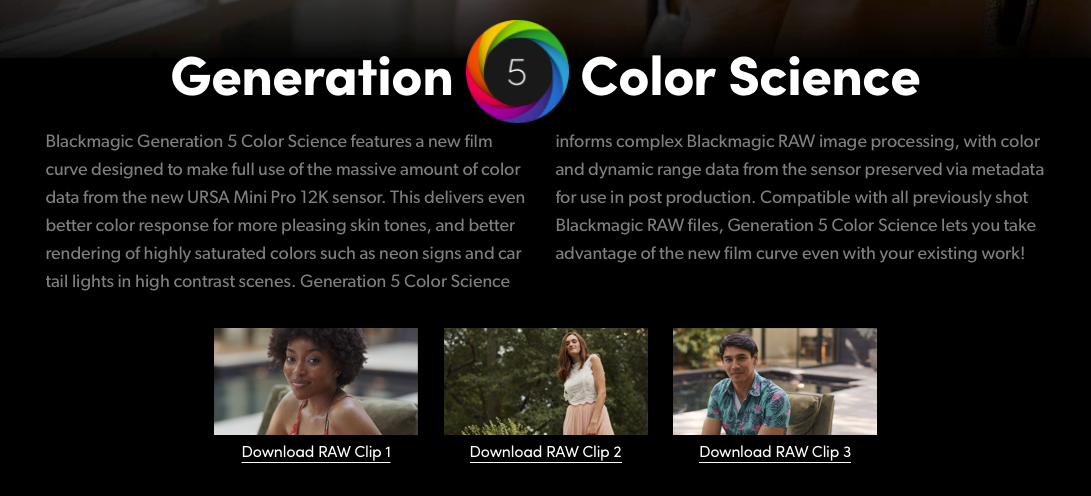

kye Posted July 18, 2020 Share Posted July 18, 2020 3 hours ago, thebrothersthre3 said: Lets wait and see when some footage becomes downloadable. Footage is available here: https://www.blackmagicdesign.com/uk/products/blackmagicursaminipro Scroll down to the Colour Science heading and there's three clips. tupp 1 Link to comment Share on other sites More sharing options...
