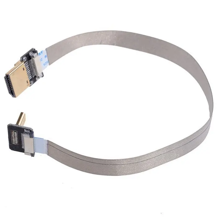

tupp Posted July 23, 2020 Share Posted July 23, 2020 Or, instead of a cage with a locking pin, just go with a less expensive, delicate HDMI gimbal cable with a right-angle micro-HDMI connector: You could can strain-relieve such flimsy, flat cables with gaffers tape or paper tape. Link to comment Share on other sites More sharing options...
