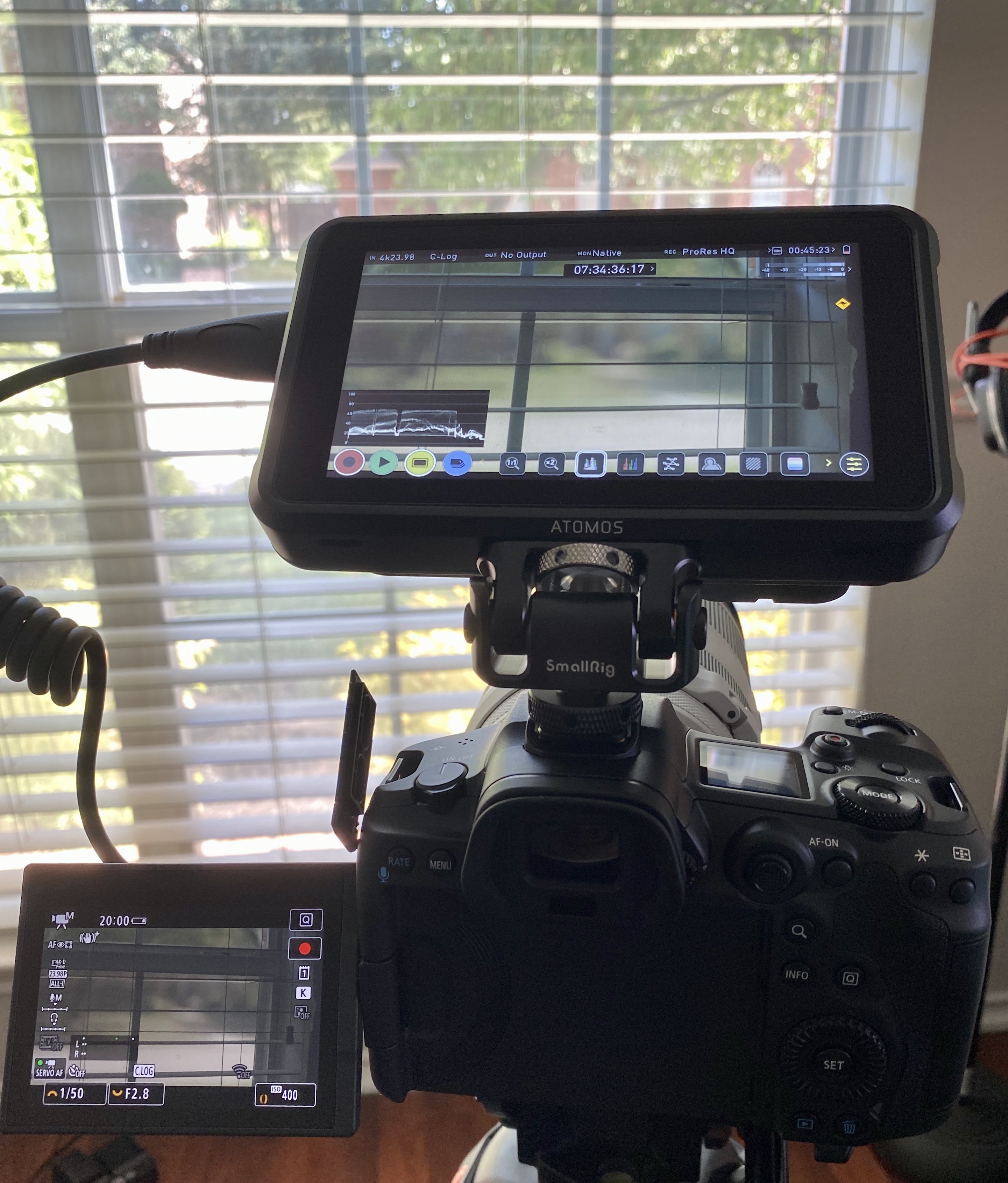

mechanicalEYE Posted August 12, 2020 Share Posted August 12, 2020 2 hours ago, Andrew Reid said: What about plugging HDMI cable in at the first moment the camera starts, using it via HDMI for 1 hour for 4K HQ, then put a card in. I'll add it to the list of things to try. Have the Ninja V sat here doing nothing. So today it is currently 102 degrees here. I took the R5 and Ninja outside to record 4K HQ. Camera was out there for about 45 minutes. The backside of the camera was very hot, I'm sweating my ass off as it is hot ASF!!!! but camera did not show the overheat warning. I then stepped inside with the camera still rolling. Grabbed my CFexpress card, when I opened the card door the camera temporarily shut down, when I inserted the card and closed the door the camera went right back into action recording on the ninja. The time shown on the counter said the 20 minutes. This is while the camera is very hot to touch. It's been about 10 minutes since I shut down and the camera is still very hot to the touch. Still says 20 minutes of record time as I type this. Link to comment Share on other sites More sharing options...

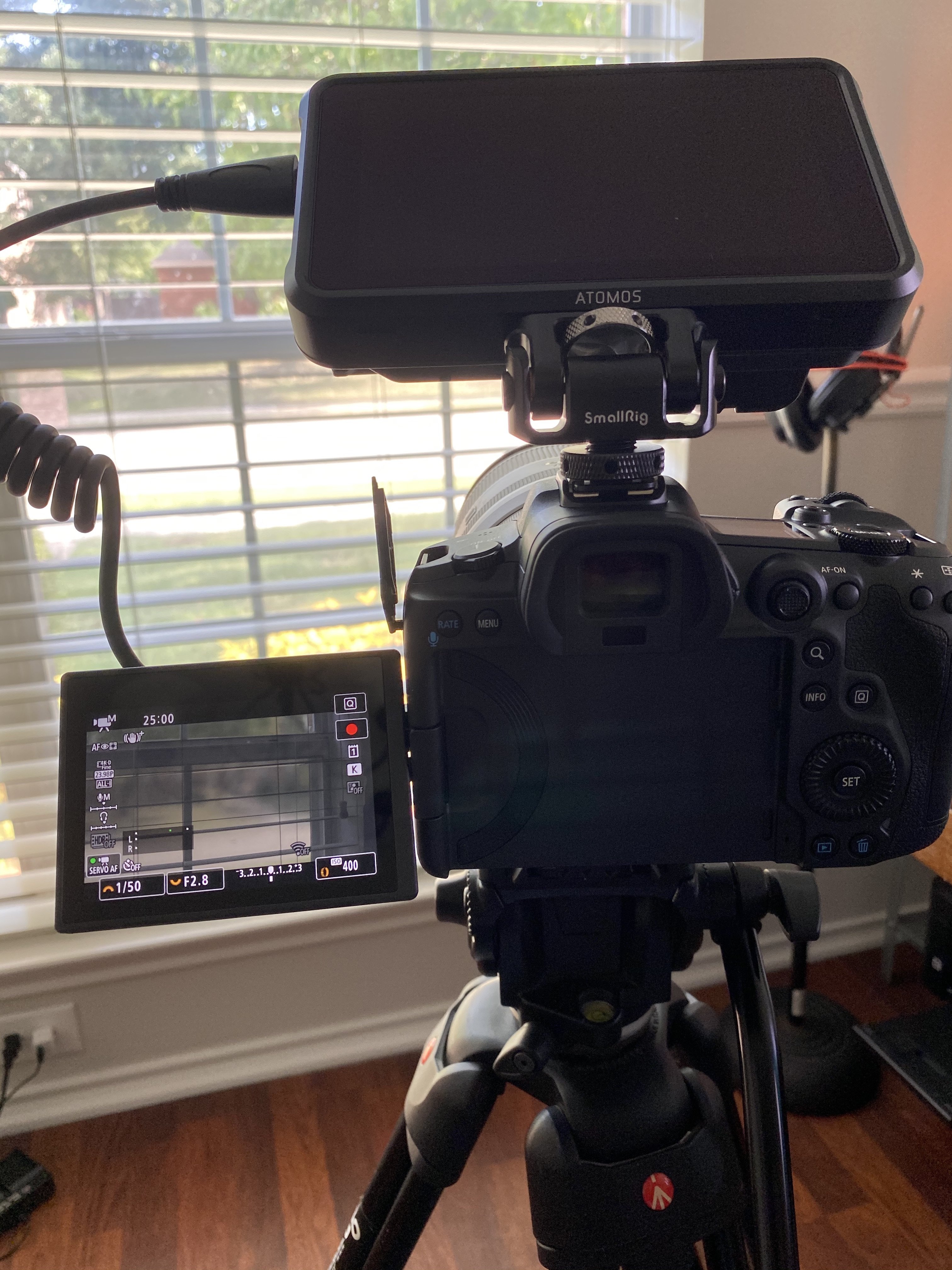

mechanicalEYE Posted August 12, 2020 Share Posted August 12, 2020 Now it's back at 25 minutes... Has only been off for about 12 minutes and is warm to touch. Link to comment Share on other sites More sharing options...

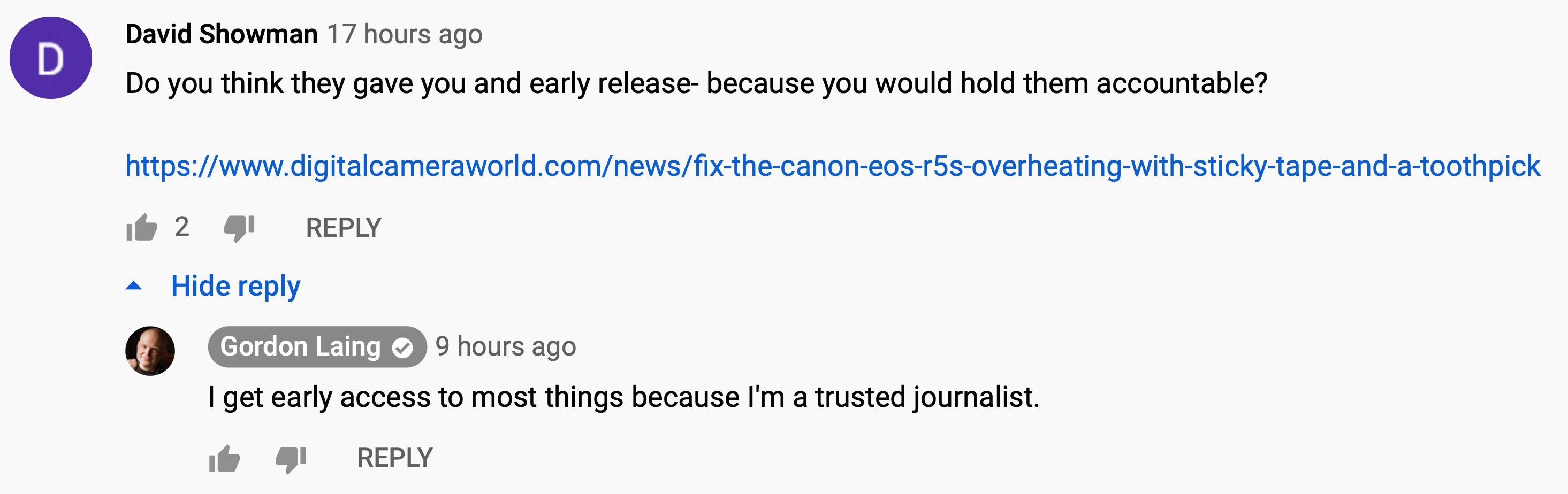

hoodlum Posted August 27, 2020 Share Posted August 27, 2020 So it looks like we will see an R6 firmware update as well. This was posted by Gordon today. Link to comment Share on other sites More sharing options...
Administrators Andrew Reid Posted August 27, 2020 Author Administrators Share Posted August 27, 2020 Link to comment Share on other sites More sharing options...
Wild Ranger Posted August 27, 2020 Share Posted August 27, 2020 I trust Sareesh, he's quite knowledgable and at least he's a DP who works with the gear he shows. It is interesting to see how the camera will work now with this new update. The timer seems to still be present but it seems that it doesn't "bother" so much when recording, obviously it would be better not to have it present. PannySVHS 1 Link to comment Share on other sites More sharing options...
Administrators Andrew Reid Posted August 27, 2020 Author Administrators Share Posted August 27, 2020 "Thank you for reinstalling Canon's position in industry overnight" "8K RAW beast" "ONLY waited 30 minutes for it to cool down" "The best mirrorless camera for hybrid and filmmaking" andrgl and PannySVHS 2 Link to comment Share on other sites More sharing options...
