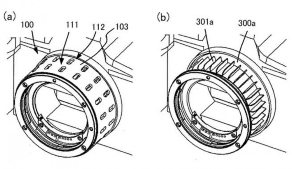

Administrators Andrew Reid Posted July 27, 2020 Author Administrators Share Posted July 27, 2020 In a Canon patent an EF lens adapter cooler with active fan and radiator was suggested. It was probably not released alongside the camera, in my opinion because it would reduce sales of native RF lenses. The shape of the camera in the patent clearly resembles the EOS R5. It remains to be seen if we'll see this adapter on sale, ever. Venting heat through the lens mount from the sensor probably doesn't do much for the LSI anyway, as that's on the other side. Unless the heat problem is actually with the sensor? Link to comment Share on other sites More sharing options...
