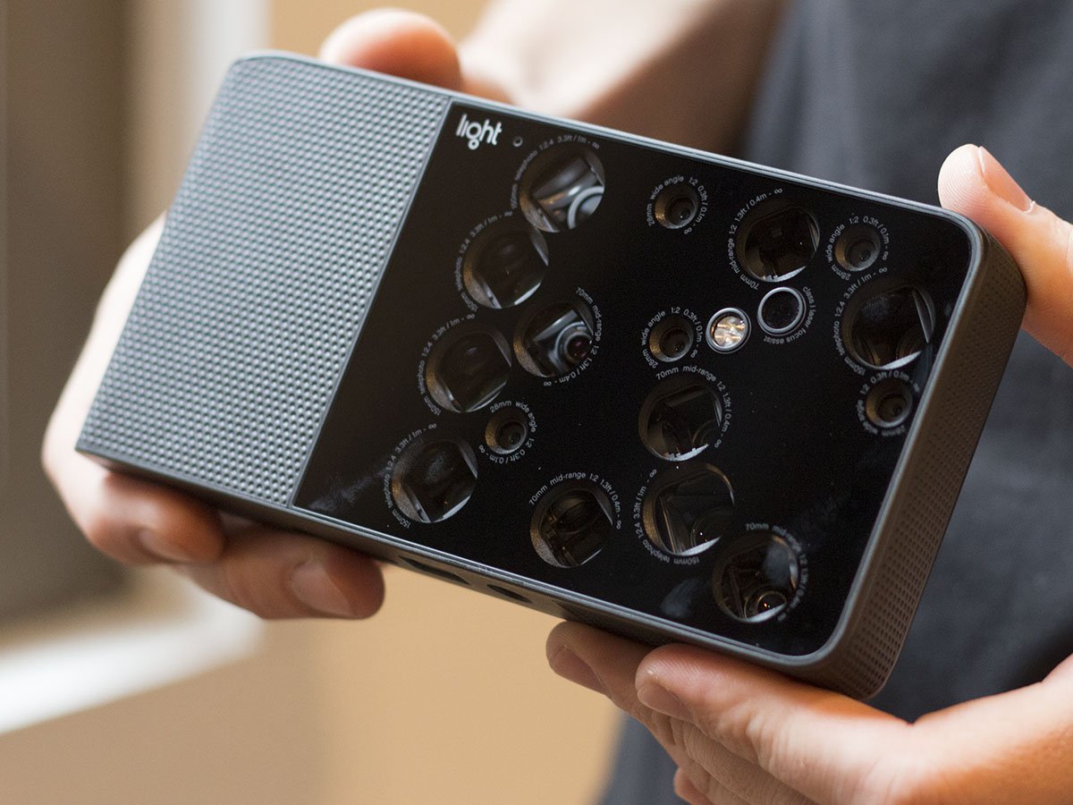

Administrators Andrew Reid Posted August 3, 2020 Administrators Share Posted August 3, 2020 The 3-4 cam arrays on smartphones show the strength of the future for camera arrays. As long as they don't take it a step too far!... Link to comment Share on other sites More sharing options...
Super Members BTM_Pix Posted August 3, 2020 Super Members Share Posted August 3, 2020 6 minutes ago, Andrew Reid said: The 3-4 cam arrays on smartphones show the strength of the future for camera arrays. As long as they don't take it a step too far!... That thing reminds me of the propensity that old Mods had for maximising forward illumination and rear view coverage for their Lambrettas. Link to comment Share on other sites More sharing options...
