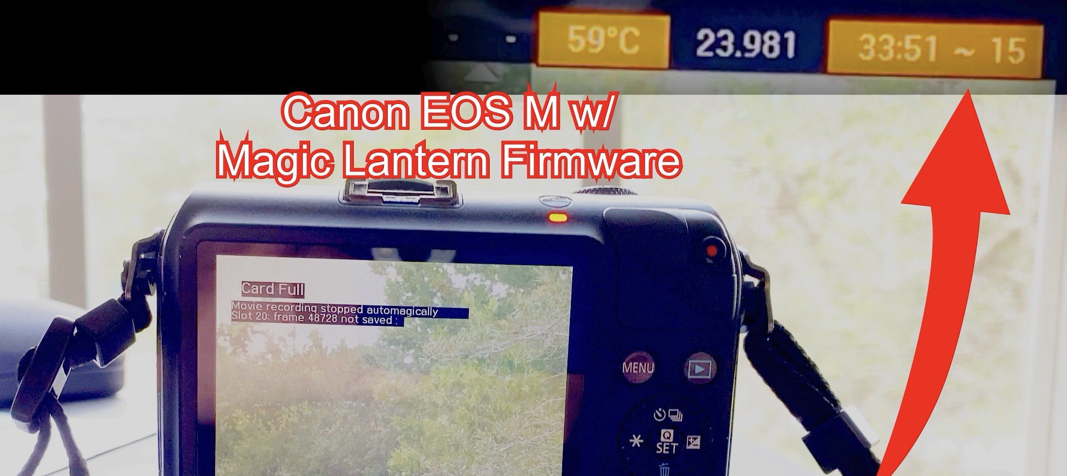

SoFloCineFile Posted August 12, 2020 Author Share Posted August 12, 2020 I can confirm that the Magic Lantern build I am using does bypass the factory record limit on the Canon EOS M! I was able to record continuous 2.5k Raw (2512 x 1190, 16:9 format) for 33:51 minutes, reaching the capacity limit of my 128 SanDisk Extreme Pro (170MB/s). See snapshots below: Thomas Hill 1 Link to comment Share on other sites More sharing options...

SoFloCineFile Posted August 13, 2020 Author Share Posted August 13, 2020 Also, just want to give a disclaimer that I made a mistake earlier when I said that the 33 min video test recording mentioned above was 16 by 9 format. I opened the recording up in MLV and its actually 21 by 10...however, that's still a fuller look than 2:35 or 2:39, so it's awesome imo to be able shoot continuously in this mode, as well as 2.7k and 2.8k raw continous in the cropped aspect ratios. Before this latest build, I was only able to get continuous in the 1080 rewire and anamorphic pixel binned modes, where the image needed to be stretched in post and didn't look like true 2.5k. My next goal is to do a short film and try to film it entirely in 2.5k or above resolution. KnightsFan 1 Link to comment Share on other sites More sharing options...
