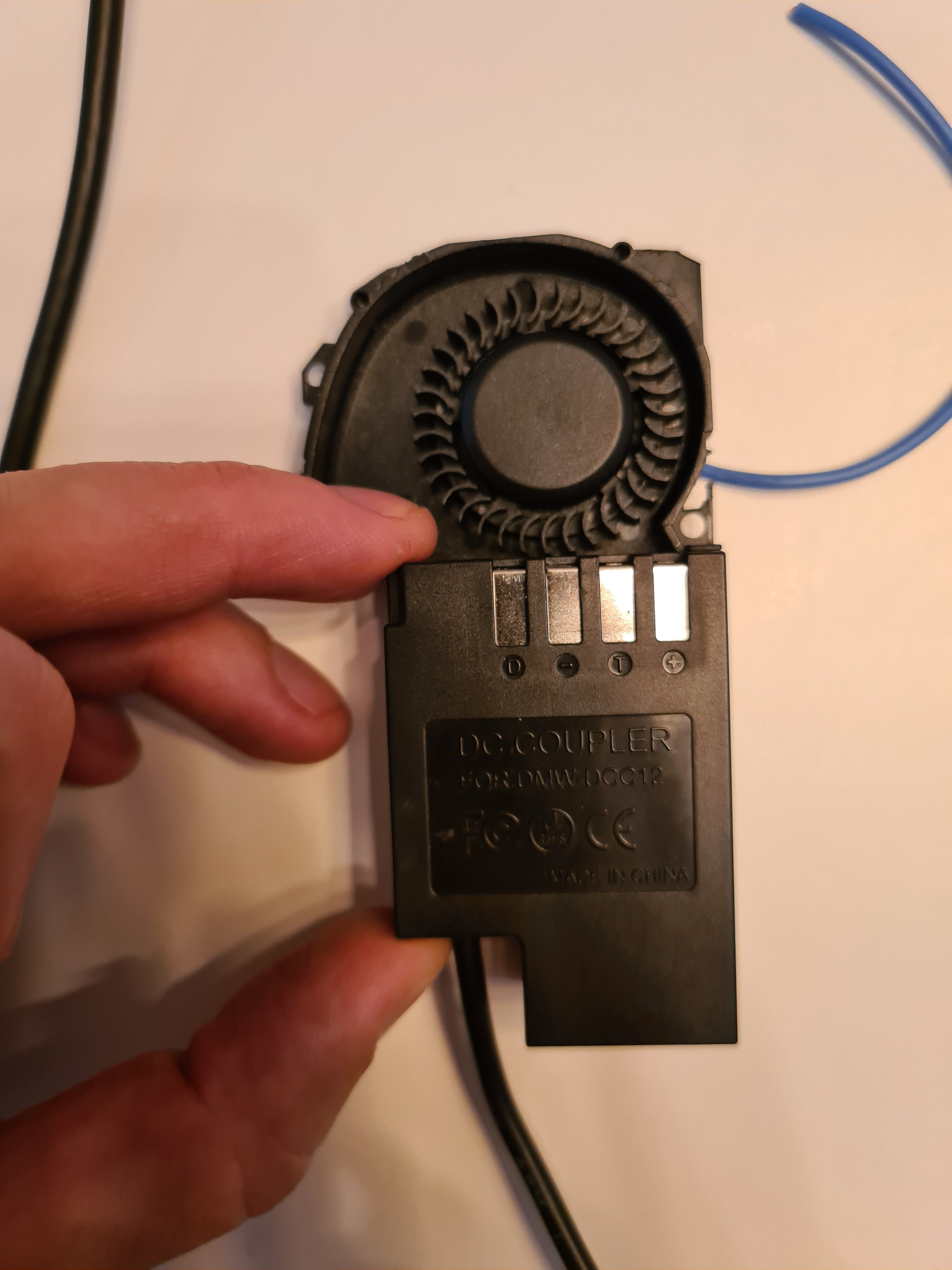

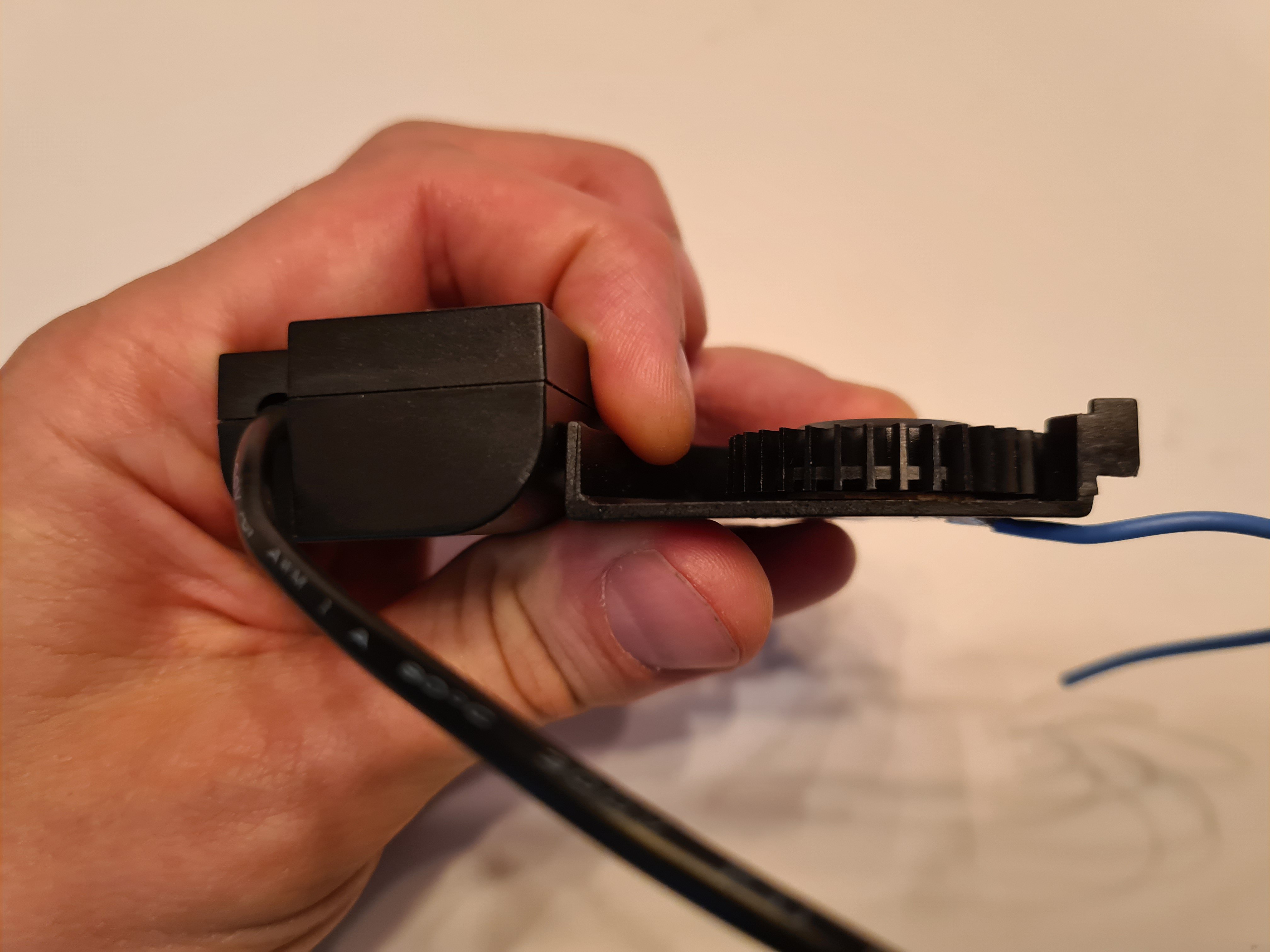

UncleBobsPhotography Posted August 14, 2020 Share Posted August 14, 2020 Assuming the R5 does in fact overheat and that additional cooling is beneficial, I just thought of a fan-placement I haven't seen before (perhaps with good reason). I usually use a dummy battery because I prefer to use LP-F batteries. A radial fan would actually fit inside the dummy battery. Cutting down on the left size of the exhaust might degrade the performance somewhat, but it should still work.. It is also half the height of the dummy battery (picture 2), which makes it possible to make half the height for exhaust and half for intake. The dummy battery already has 7.4v, hooking up a 12 V fan gives a nice breeze without much noise. It might be too noisy for the internal microphones, but is silent >10 cm away. This is not the hottest place on the camera, but any cooling is better than no cooling and the advantage of this over other cooling methods is that it would have zero impact on the ergonomics of the camera for anyone who is already using a dummy battery. To make this work, the dummy battery should have the casing removed in the direction it's supplying the main cooling. Alternatively it could be open on both wide sides but have barrier in the middle to separate the intake and the exhaust, giving it the shape on an H pillar. Sorry for the oversized images, I couldn't figure out how to resize it. Emanuel 1 Link to comment Share on other sites More sharing options...

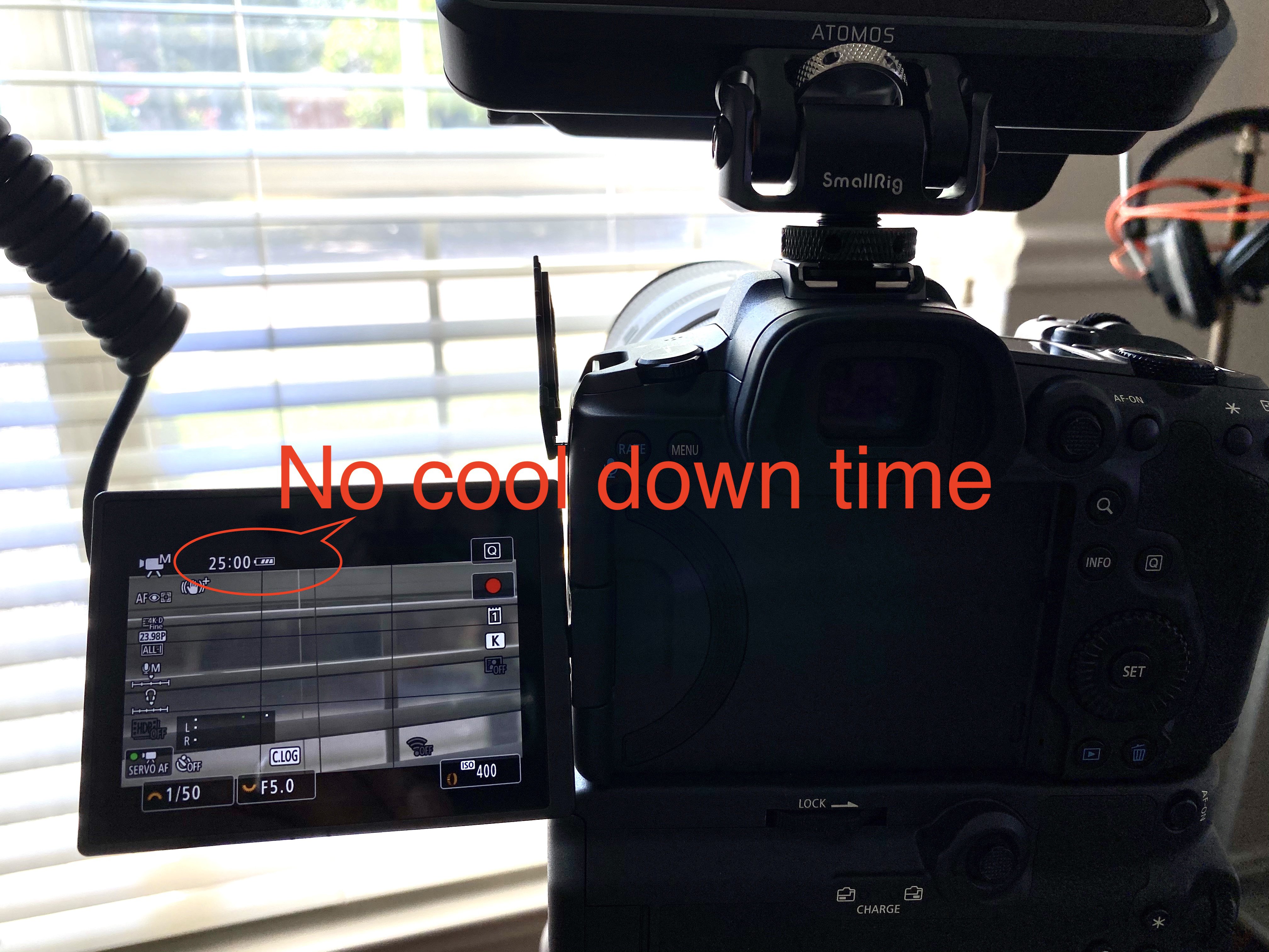

mechanicalEYE Posted August 15, 2020 Share Posted August 15, 2020 Todays test: Recorded 4K HQ externally with Ninja V - Canon LP Battery in camera for 1 hour continuous with no card in camera. ( at 1 hr the cameras very HOT to the touch ) all this in direct sun light, and very hot. No overheat warning. At the hour mark, I take the camera indoors but continue the recording externally. I immediately insert the CFexpress card while still externally recording. The camera temporarily shuts down but immediately comes back on when the card door is shut, it continues to record externally. still no overheat warning. I shut down the external recording, camera reads 25 minutes available in 4k HQ internally... as well as full times available in all other modes. Switch modes then take two photos back to back. The first photo shows 65C in the exif data for camera temp The second photo shows 64C in the exif data for camera temp... these photos were a second apart. ntblowz and Emanuel 1 1 Link to comment Share on other sites More sharing options...
