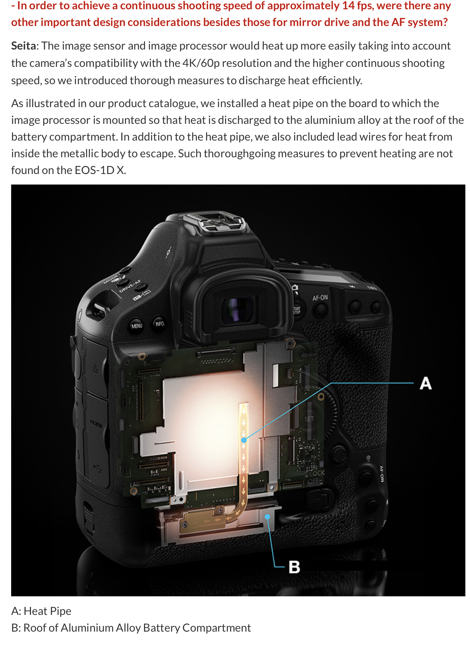

jessedacri Posted August 11, 2020 Share Posted August 11, 2020 9 hours ago, Andrew Reid said: So going back to the actual internal design of the EOS R5... The questions Canon need to answer are: 1. Why is a circuit board sitting between the main CPU and back casing, blocking the heat from spreading away into the chassis 2. Of course, why is there no thermal conductive material on the CPU? 3. And why does the RAM thermal pad overlap onto the CPU, but not entirely cover it? (It seems to spread the heat from the RAM onto the CPU which is never a good idea). 4. Why does ice not cool the camera and speed up recovery time? The firmware recovery countdown timer is so slow to go back up and always the same. And indeed they will be asked via my contact at Canon UK. And I won't let up until they answer. If they don't answer, they have something to hide obviously. Please also ask them why they decided it was necessary in the 1DX II to put a heatpipe/heatsink in but they are doing less than the bare minimum in the R5 where the camera is marketed with professional video features, in a market segment with competition delivering reliable professional video features (S1H and A7sIII). This quote from canon themselves is damning - why did they not feel the same need they did then, instead opting to release two pages of overheating documentation and ship a crippled product with clear-as-day poorly designed hardware? andrgl 1 Link to comment Share on other sites More sharing options...

Marcio Kabke Pinheiro Posted August 11, 2020 Share Posted August 11, 2020 2 hours ago, jessedacri said: Please also ask them why they decided it was necessary in the 1DX II to put a heatpipe/heatsink in but they are doing less than the bare minimum in the R5 where the camera is marketed with professional video features, in a market segment with competition delivering reliable professional video features (S1H and A7sIII). This quote from canon themselves is damning - why did they not feel the same need they did then, instead opting to release two pages of overheating documentation and ship a crippled product with clear-as-day poorly designed hardware? The "fun" part is that THIS heat pipe could be implemented in the R5 - I has never saw the picture above, never would thought that a heatpipe this small could work. A similar approach could work in the R5 - a thin metallic shield in contact with the chips with thermal pads, and this heatpipe conducting the heat to the bottom plate (it just have to avoid the connector for the board that sits above the mainboard). Than you make the bottom plate with two "floors" (like the heat spreader on the Sigma FP1), with a gap in the middle to help in ventilation and to prevent the bottom to be very hot to touch. Still in the engineering regard...the drawing of the internal heat spreader of the A7SIII looks VERY similar to the on in the R5. Maybe it is a common way to make cameras? Link to comment Share on other sites More sharing options...
Administrators Andrew Reid Posted August 11, 2020 Author Administrators Share Posted August 11, 2020 The main problem is the PCB circuit board on top of the CPU, sandwiched between that and the back casing. It is utterly lunatic design or (more likely) on purpose. The main CPU should have a thermal pad on top and direct contact to the chassis. It is akin to Nvidia putting a second PCB on top of their graphics processor so it doesn't get into contact with the heat sink, and then telling gamers "sorry but your 2080 Ti only works for 20 mins of 4K Monster Hunter World then you have to go to 720p") I find it hard to believe any engineer would be happy with this layout. The simplicity of the physics, your average 10 year old would understand. Even I understand that if I don't put my Intel CPU in direct thermal contact with a heat sink in my PC, it gets too hot. So Canon can bleat on about using the magnesium alloy case as a heat sink all day long but they didn't implement it that way. The big question is why. jessedacri and RawZion 2 Link to comment Share on other sites More sharing options...
Marcio Kabke Pinheiro Posted August 11, 2020 Share Posted August 11, 2020 Just now, Andrew Reid said: The main problem is the PCB circuit board on top of the CPU, sandwiched between that and the back casing. It is utterly lunatic design or (more likely) on purpose. The main CPU should have a thermal pad on top and direct contact to the chassis. It is akin to Nvidia putting a second PCB on top of their graphics processor so it doesn't get into contact with the heat sink, and then telling gamers "sorry but your 2080 Ti only works for 20 mins of 4K Monster Hunter World then you have to go to 720p") I find it hard to believe any engineer would be happy with this layout. The simplicity of the physics, your average 10 year old would understand. Even I understand that if I don't put my Intel CPU in direct thermal contact with a heat sink in my PC, it gets too hot. So Canon can bleat on about using the magnesium alloy case as a heat sink all day long but they didn't implement it that way. The big question is why. Yeap, exactly my point. As I said, I have some electronics background, and a 2nd year student would never make that mistake. CPU and memory with a thermal pad to conduct the heat...to another board? And when you have a big heat spreader just behind the main board, but put the chips in the other side? It is on purpose, or they have the dumbest engineers in the world. Link to comment Share on other sites More sharing options...

TheBoogieKnight Posted August 11, 2020 Share Posted August 11, 2020 27 minutes ago, Márcio Kabke Pinheiro said: Yeap, exactly my point. As I said, I have some electronics background, and a 2nd year student would never make that mistake. CPU and memory with a thermal pad to conduct the heat...to another board? And when you have a big heat spreader just behind the main board, but put the chips in the other side? It is on purpose, or they have the dumbest engineers in the world. As I said a while back on here, this is by no means unheard of. You see the same garbage on $$$$$ laptops with inadequate cooling, or poorly applied poor thermal paste etc. etc. Same in the music industry. The great irony is that Canon made a point about all the heat generating components being strategically kept away form each other and literally the opposite is true! Link to comment Share on other sites More sharing options...
