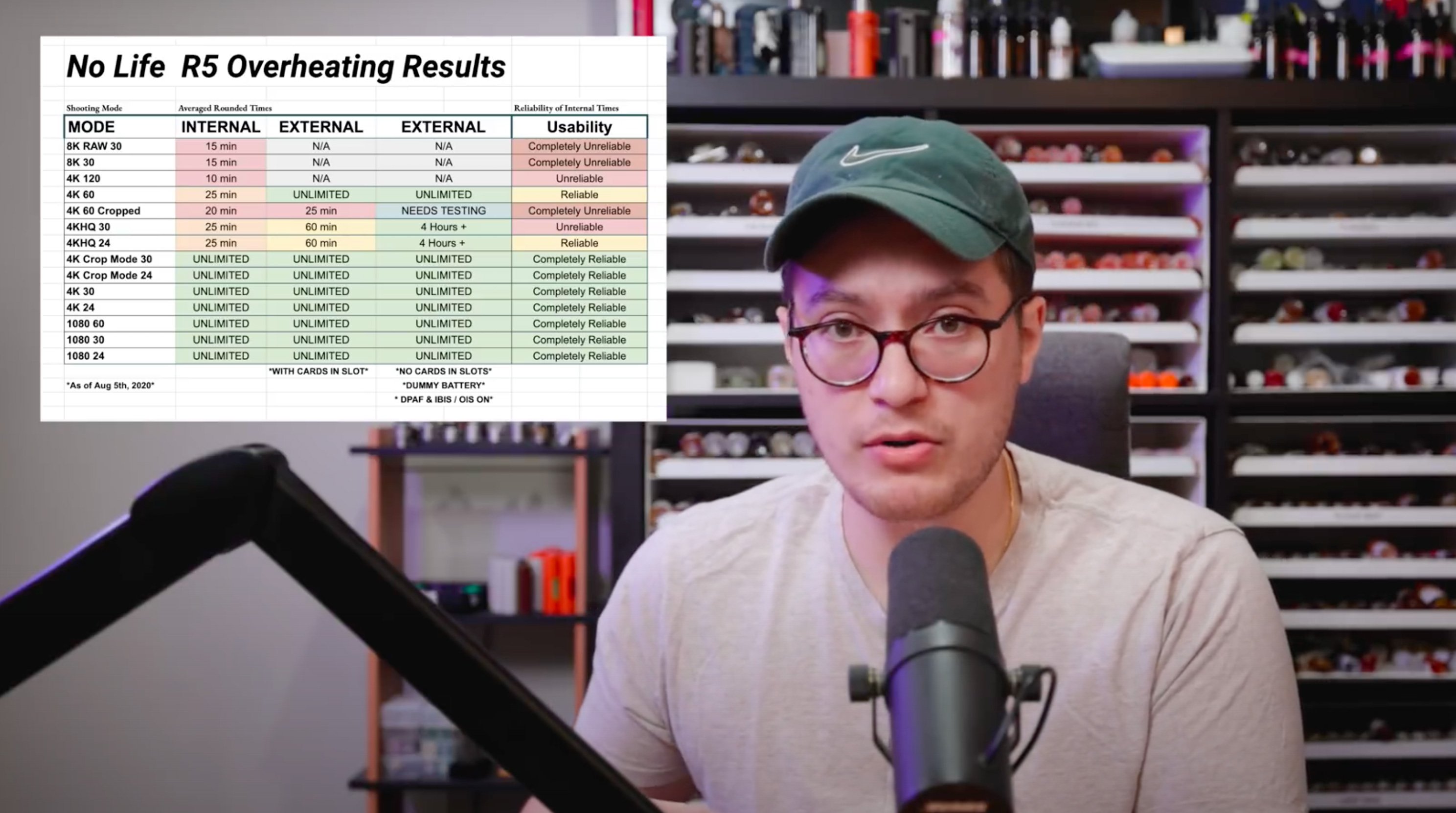

UncleBobsPhotography Posted August 14, 2020 Share Posted August 14, 2020 44 minutes ago, Stanly said: @Andrew Reid Sorry for re-posting, but you probably missed it – R5 does record 4K HQ via HDMI for 4 hours, not pixel binned. He got problems when he turned the screen on. I wonder how internal recording works with the screen off using an external monitor. To be honest, I'm just jealous my order isn't arriving any time soon so I can do my own testing. Link to comment Share on other sites More sharing options...

mechanicalEYE Posted August 14, 2020 Share Posted August 14, 2020 Yes, he got 4 hours but he definitely had to have the screen off. The dummy battery doesn't play much of a role beyond allowing recording past the LP battery life. I've tried all his his test, and the R5 screen seemed to be the difference in whether I got the overheat warning or not. 23 minutes ago, UncleBobsPhotography said: He got problems when he turned the screen on. I wonder how internal recording works with the screen off using an external monitor. To be honest, I'm just jealous my order isn't arriving any time soon so I can do my own testing. External recording... GREAT! Obviously prores makes things a bit better dealing with the codecs of the R5... My only issue here is, I WANT TO KEEP THE CAMERA SIZED AS IT IS out the box! Am I asking too much? LOL Thats o no go if Canon doesnt make absolute sense of these time limitations + recovery times. Link to comment Share on other sites More sharing options...

Administrators Andrew Reid Posted August 14, 2020 Author Administrators Share Posted August 14, 2020 Anyone spot the problem with the charts like this? Link to comment Share on other sites More sharing options...
no_connection Posted August 14, 2020 Share Posted August 14, 2020 48 minutes ago, UncleBobsPhotography said: This might be obvious, but this is rather easy to figure out. 2 ways: 1) Use a dummy battery and attach an amperemeter Yes it is both obvious and easy which is why I asked/wanted/wondered why noone had done it yet. Link to comment Share on other sites More sharing options...
Administrators Andrew Reid Posted August 14, 2020 Author Administrators Share Posted August 14, 2020 The recording time charts don't take into account the time spent in live-view or menus. So at some point during the first 40 minutes of the day, you will be looking at a 5 min limit in 4HQ instead... and then 0 mins. Unless you work like this: Shoot a 30 min continuous shot. Power down camera for 2 hours. Come back and shoot another 30 mins. Power down for 2 hours. Nobody works like this. Stronz and Emanuel 2 Link to comment Share on other sites More sharing options...
