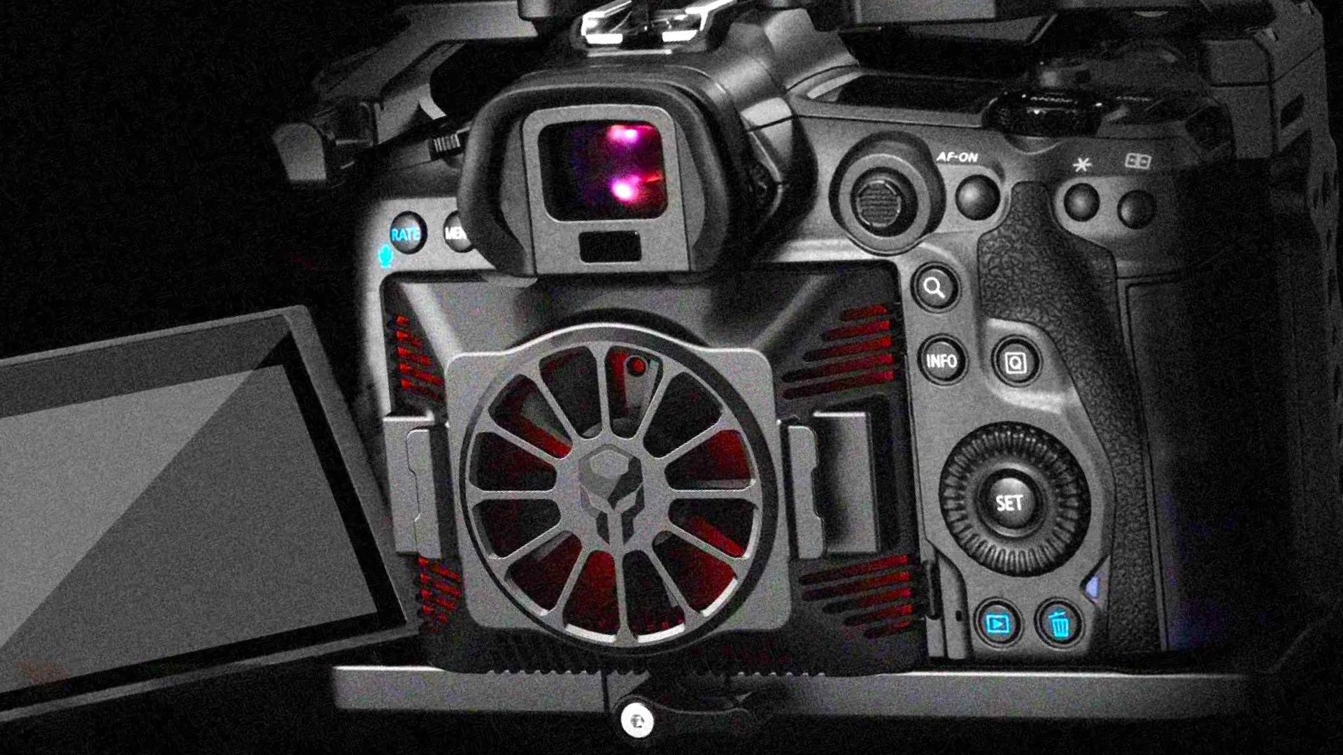

Cliff Totten Posted August 15, 2020 Share Posted August 15, 2020 Haha....I just thought of something.... This new Tilta R5 cage with fan cooler? This information makes it 100% USELESS! I really hope these Tilta guys have not gone into manufacturing yet!! Link to comment Share on other sites More sharing options...
Video Hummus Posted August 15, 2020 Share Posted August 15, 2020 5 minutes ago, Cliff Totten said: Haha....I just thought of something.... This new Tilta R5 cage with fan cooler? This information makes it 100% USELESS! I really hope these Tilta guys have not gone into manufacturing yet!! I heard it uses the highly technologically advanced Placebo affect to cool the camera! Cutting edge stuff! Geoff_L and Katrikura 2 Link to comment Share on other sites More sharing options...

Cliff Totten Posted August 15, 2020 Share Posted August 15, 2020 3 hours ago, Video Hummus said: I heard it uses the highly technologically advanced Placebo affect to cool the camera! Cutting edge stuff! I swear....I HOPE Cannot engineers had the DECENCY to call Tilta up and say: "Guys....before you lose a ton of money on manufacturing, we highly recommend that you NOT waste your time and money on this as we made sure that trying to cool the R5 won't work...." Then again, I can see Cannot engineers saying this too; "HAHA....look at these Tilta idiots TRYING to cool our R5. They have no CLUE they are just chasing a pot of gold at the end of a rainbow" Wow......just.....wow. Link to comment Share on other sites More sharing options...
