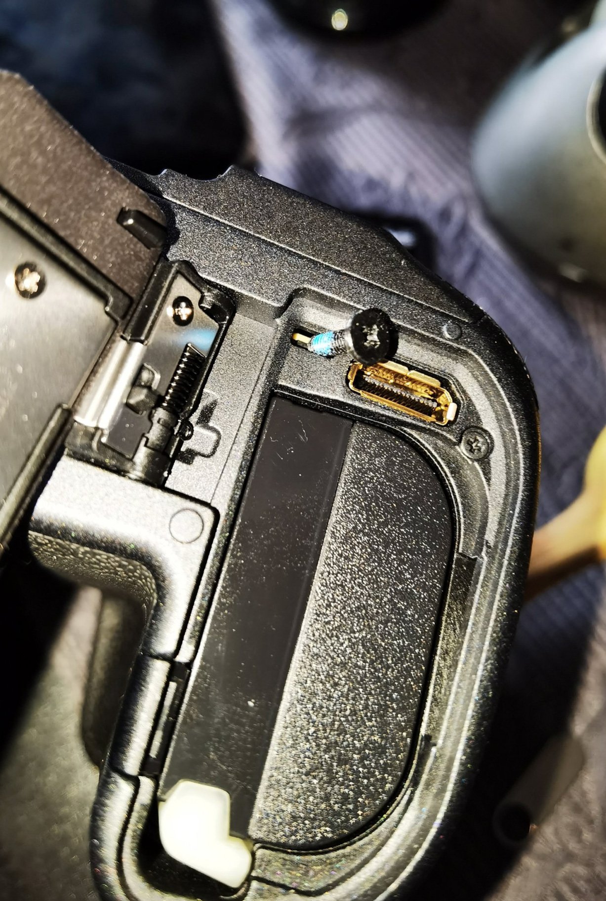

Administrators Andrew Reid Posted August 21, 2020 Author Administrators Share Posted August 21, 2020 4 hours ago, ajay said: Possible work-around from removing the button battery? Horshack on the DP thread thinks that you can trick the camera by overriding the battery door switch and pulling out the battery. This prevents the camera from going into a normal shut-down and it loses its settings. Something to try Andrew? https://www.dpreview.com/forums/post/64283375 Just tried this as well. It does forget the aperture because it didn't write it to NVRAM in time if you pull the battery quite quickly - I tried after about 10 seconds, with the battery door open and a small screw lodged in the pin to force the camera into ON state even with door open. It does not forget the timers That seems to work off a separate clock to the main date / time and is constantly ticking away like a quartz powered by the button cell. One solution I wish the Chinese guy had tried is to permanently remove the internal battery and see if the recovery timer is reset every time you reboot without it. It would be annoying to be kept asking to input date and time on every startup though. Juank, Mandalorian, Mustafa Ali and 1 other 4 Link to comment Share on other sites More sharing options...

Mandalorian Posted August 21, 2020 Share Posted August 21, 2020 41 minutes ago, Andrew Reid said: Just tried this as well. It does forget the aperture because it didn't write it to NVRAM in time if you pull the battery quite quickly - I tried after about 10 seconds, with the battery door open and a small screw lodged in the pin to force the camera into ON state even with door open. It does not forget the timers That seems to work off a separate clock to the main date / time and is constantly ticking away like a quartz powered by the button cell. One solution I wish the Chinese guy had tried is to permanently remove the internal battery and see if the recovery timer is reset every time you reboot without it. It would be annoying to be kept asking to input date and time on every startup though. Also, even if pulling out the battery backup works, it would be annoying to have to turn the camera off, and back on again, every 20 minutes to reset the cripple clock...and then on top of that have to re-enter the date and time/zone every time like it was a first time setup of the camera (not to mention it would forget all of your custom settings). Link to comment Share on other sites More sharing options...
