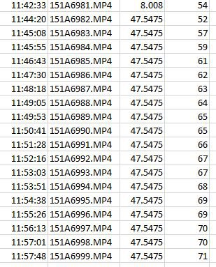

Electroholic Anonymous Posted August 26, 2020 Share Posted August 26, 2020 Indeed. Also, every time a second start of the video did not give a card slow error, so only the first attempt writing to a power dropped SD or CFexpress card gives this behaviour. Here are the prelimnary results of the 40 minute 8K IPB FAT32 test. From 15 to some 40 minutes in to the test. Things appear to stabilize around 72C. Let's see how it fares tonight. Link to comment Share on other sites More sharing options...
horshack Posted August 26, 2020 Share Posted August 26, 2020 19 minutes ago, Electroholic Anonymous said: Indeed. Also, every time a second start of the video did not give a card slow error, so only the first attempt writing to a power dropped SD or CFexpress card gives this behaviour. Here are the prelimnary results of the 40 minute 8K IPB FAT32 test. From 15 to some 40 minutes in to the test. Things appear to stabilize around 72C. Let's see how it fares tonight. Thanks. Things are getting pretty toasty at around 72C 😀 That also happens to be the temp that Hoka Key's test stopped after 69 minutes of 8K recording for the overnight-fridge test. Here's my graph of that test (on right - left is non-fridge test): Link to comment Share on other sites More sharing options...
