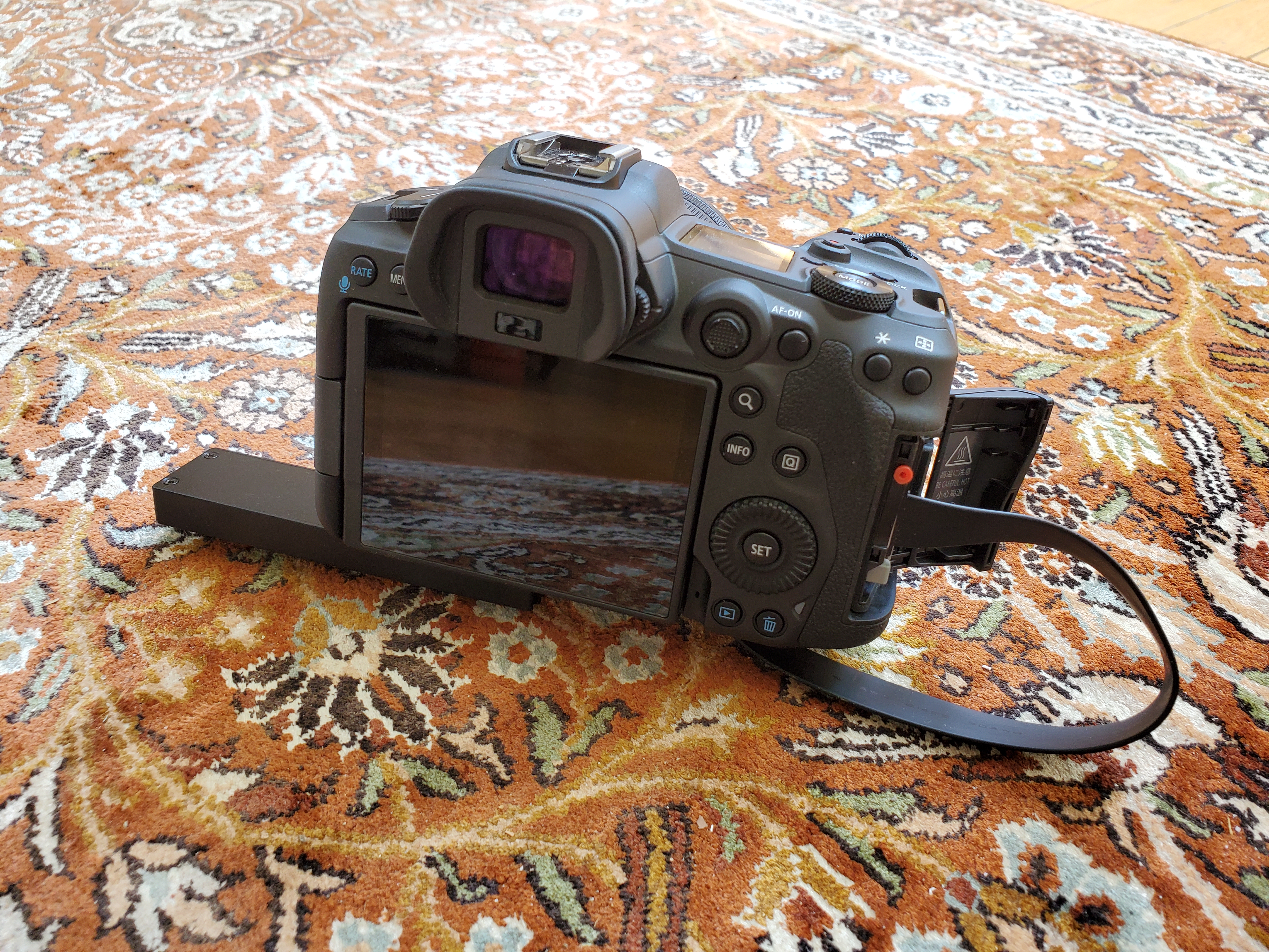

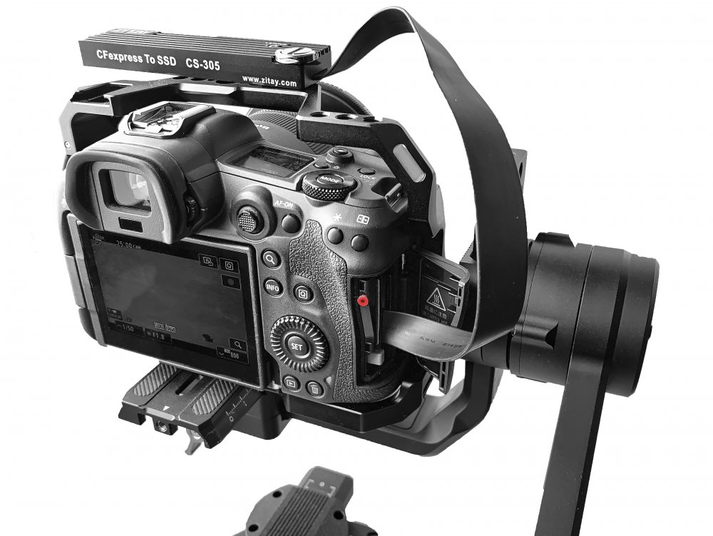

markr041 Posted June 10, 2021 Share Posted June 10, 2021 I have rigged the Zitay CFExpress to SSD on my R5 for handheld work with a 1 TB Samsung 980 Pro SSD. It works fine at the highest bitrates (8K RAW) and the CFExpress "card' plugs into any CFExpress reader and the transfer rate from the SSD is the same as if it were a CFExpress card (400 MBps). The combo is a significantly cheaper alternative to any 1 TB CFExpress card that has the capability of the 8K RAW bitrates (few do - Canon has a list). I did not find it awkward to use it in the field. But out in the sun I do not think this rig increased time to overheat. Thus, I do not think the CFExpres card is an important source of the heat issue. So, a cheaper alternative for high-capacity fast storage but not a heat saver. Link to comment Share on other sites More sharing options...

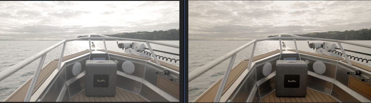

ntblowz Posted July 11, 2021 Share Posted July 11, 2021 Clog 3 definitely have better highlight, the left was ooc and right is tweak in lumetri (r5 clog3), on clog 1 that highlight is lost forever Django and techie 2 Link to comment Share on other sites More sharing options...
