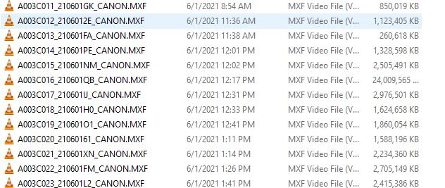

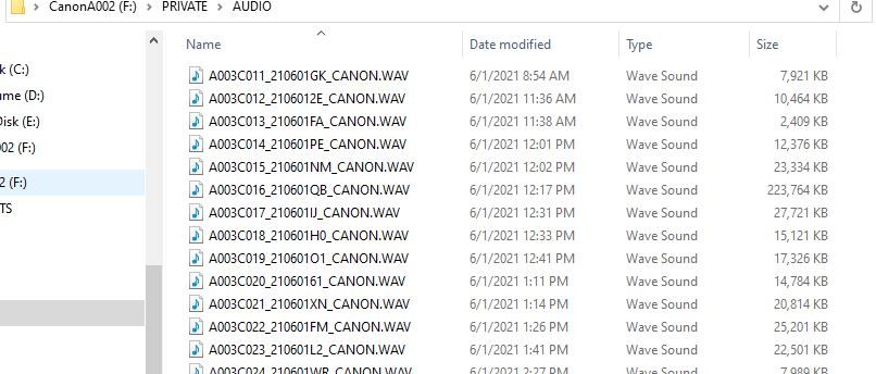

EphraimP Posted June 28, 2021 Share Posted June 28, 2021 And speaking of the lovely C70... Has anyone else had the issue of Slow&Fast motion, with or without sound, disabling external recording? I was DPing some shoots last week using the C70 professionally for the first time, using a Ninja V as a monitor and recoding backups on it. My 23.976 A-roll recorded just fine on both the camera card and the Ninja. Whenever I hit the button I'd preset to S&F, hitting record on the camera wouldn't trigger the Ninja to record, though I could still monitor everything. I switched to duel recording internal instead of relay, until I got low on card 1 space and had to switch back, but I haven't sorted throuhg all the footage yet to see if I was gettting dual internal copies each time I hit record while dual record was selected internally. Luckily, I didn't have any card malfuntions, so didn't really need the backups. It's nice for peace of mind, though, and I don't like shooting for somebody else without being able to do so. S&F with sound didn't seem to actually record sound, but that's a different issue. If there is a setting I'm missing to enable external recoridng in S&F, I'd sure love to know what it is. It is very helpful, for me at least, to record my backups on the Ninja and keep the C70 on relay record. Becuase a monitor is a MUST for outdoor shooting (90 percent of what I do) it's also really helpful when looking at the Ninja and catching fast-changing action to see the red tally signal around the recorder's screen to let me know I'm recording. If external recording is completely a no-go in S&F, that would be a huge bummer. It's so convenient to switch on the fly at the touch of a button, and I'm not looking forward to having to buy a bunch of V90 cards when I've got rwo 1TB SSD's for the Ninja. Yay Canon! Link to comment Share on other sites More sharing options...
ntblowz Posted June 29, 2021 Share Posted June 29, 2021 1 hour ago, EphraimP said: S&F with sound didn't seem to actually record sound, but that's a different issue. It record audio separately to another card at same time, the video part don't have sound. 1 hour ago, EphraimP said: Were you running the R5 then? Yeah, I provide the C70 and R5 but I use R5 so i m not too tired. I was shooting for 12hrs the day before on another job. S&F 4k120p works on 420 10bit on V30 cards, not sure how long it will record as I only tried for 30s, it doesn't work on 422 10bit as it stops after 1~2 seconds. Link to comment Share on other sites More sharing options...
EphraimP Posted June 29, 2021 Share Posted June 29, 2021 1 hour ago, ntblowz said: It record audio separately to another card at same time, the video part don't have sound. So, if you are recording on card A, it will create audio file on card B? I'm not finding the audio files... Link to comment Share on other sites More sharing options...
ntblowz Posted June 29, 2021 Share Posted June 29, 2021 43 minutes ago, EphraimP said: So, if you are recording on card A, it will create audio file on card B? I'm not finding the audio files... It is under private/audio folder Link to comment Share on other sites More sharing options...

EphraimP Posted June 29, 2021 Share Posted June 29, 2021 4 hours ago, ntblowz said: It is under private/audio folder Ah, FML! I just reformated the cards for a shoot tomorrow. Hope the guy who DIT'ed the job copied the whole cards, but I bet he didn't. Luckily it's not essential. He can always use foley. BenEricson and IronFilm 2 Link to comment Share on other sites More sharing options...
