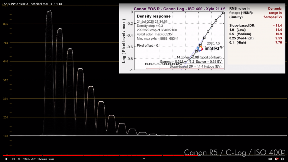

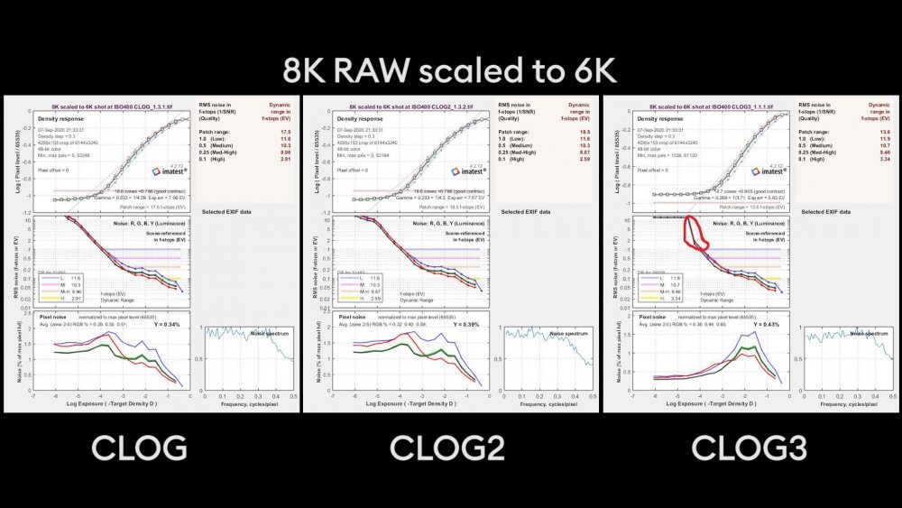

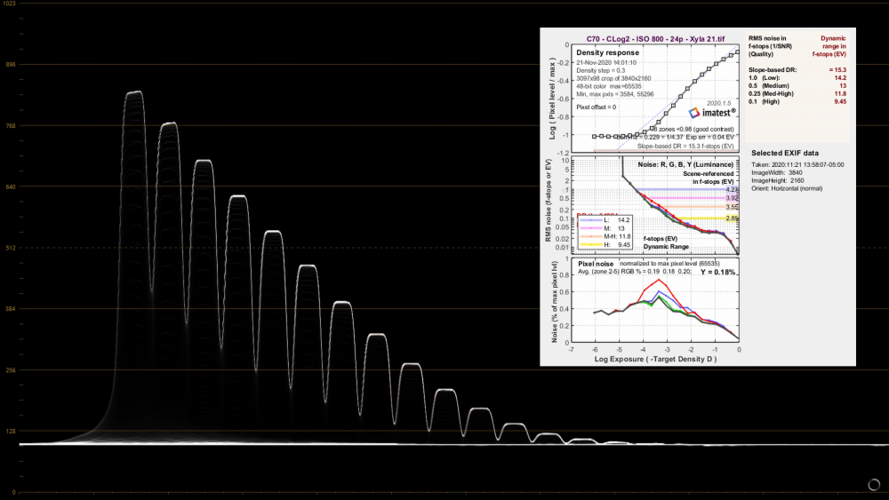

Kino Posted January 20, 2022 Share Posted January 20, 2022 There is no contest between C70 and R5/R5C when it comes to DR: Link to comment Share on other sites More sharing options...
independent Posted January 20, 2022 Share Posted January 20, 2022 Why compare clog 2 with clog? Link to comment Share on other sites More sharing options...

Kino Posted January 20, 2022 Share Posted January 20, 2022 1 hour ago, independent said: Why compare clog 2 with clog? As proven by numerous tests, 10-11 stops is the best DR that the R5 can yield when shot in RAW. R5/R5C has no Clog2 during the RAW encoding. Selecting the Clog2 gamma in Resolve will yield the same DR: All of this makes sense when you realize you are comparing a 12 bit sensor readout in the R5 to a 16 bit source (2 X 14 bit readout in DGO mode) in the C70. Canon rates the C70 at 16+ stops, significantly above any claims they have made for the R5. Link to comment Share on other sites More sharing options...
Kino Posted January 20, 2022 Share Posted January 20, 2022 Correction: 16 bit is a number from CVP's claim on the C70's DGO. But I don't see how they came up with that number . . . Technically: 2 x 14bit (16,384 gradients) = 15 bit or 32,768 gradients. Still, it is much more than the 12 bit (4,096) in the R5's video mode. PannySVHS 1 Link to comment Share on other sites More sharing options...
