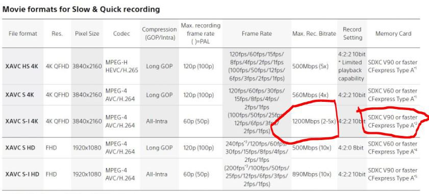

Oliver Daniel Posted September 10, 2020 Share Posted September 10, 2020 There is so much conflicting info out there, I don't know what works! So far I understand that you need v90 cards for all modes apart from S&Q modes, where you need the CFexpress Type A card that costs $100,00,000,00. I'm now seeing some people say that v60 cards work for non-S&Q modes then others saying they don't and yadda yadda. I own 6 of these cards. What exactly is it? @Hangs4Fun know? Anyone? Thank you. Link to comment Share on other sites More sharing options...
Trek of Joy Posted September 10, 2020 Share Posted September 10, 2020 The simplified breakdown, according to the chart: v60 = Long GOP recording options, no All-i (though footnote 1 & 2 for XAVC S/HS says a v90 *may* be required with 4k 100/120 & HD 200/240, that one is confusing, so a v60 works sometimes, or not? Is that because some cards aren't as reliable sustaining needed write speeds or something else?) v90 = All-i and Long GOP, some S&Q Type A = Required for S&Q All-i 4k120p, HD 200/240p - not sure why the chart doesn't say 100p, seems like it would be the same as 120 I think that's it in a nutshell. I'm going v90 to have most bases covered, but I want to try the S&Q to compare All-i with Long GOP in the HFR modes, so I'm getting the 80gb Type A card and will use the USB-c port to transfer files until there are more card reader options available. Everything Type A is way overpriced, the tax of being an early adopter. Chris Link to comment Share on other sites More sharing options...

Hangs4Fun Posted September 23, 2020 Share Posted September 23, 2020 On 9/10/2020 at 7:23 AM, Oliver Daniel said: There is so much conflicting info out there, I don't know what works! So far I understand that you need v90 cards for all modes apart from S&Q modes, where you need the CFexpress Type A card that costs $100,00,000,00. I'm now seeing some people say that v60 cards work for non-S&Q modes then others saying they don't and yadda yadda. I own 6 of these cards. What exactly is it? @Hangs4Fun know? Anyone? Thank you. Sorry Oliver, have been swamped prepping for a big shoot, had to avoid "suck holes" as much as possible, lol. Here's a page from the PRO Support guide that not only shows the minimum memory speeds, but also the max bitrates too. Sorry for the delay. Got an email this morning, that my A7SIII shipped before lunch, will be in hand Friday 🙂 Link to comment Share on other sites More sharing options...
