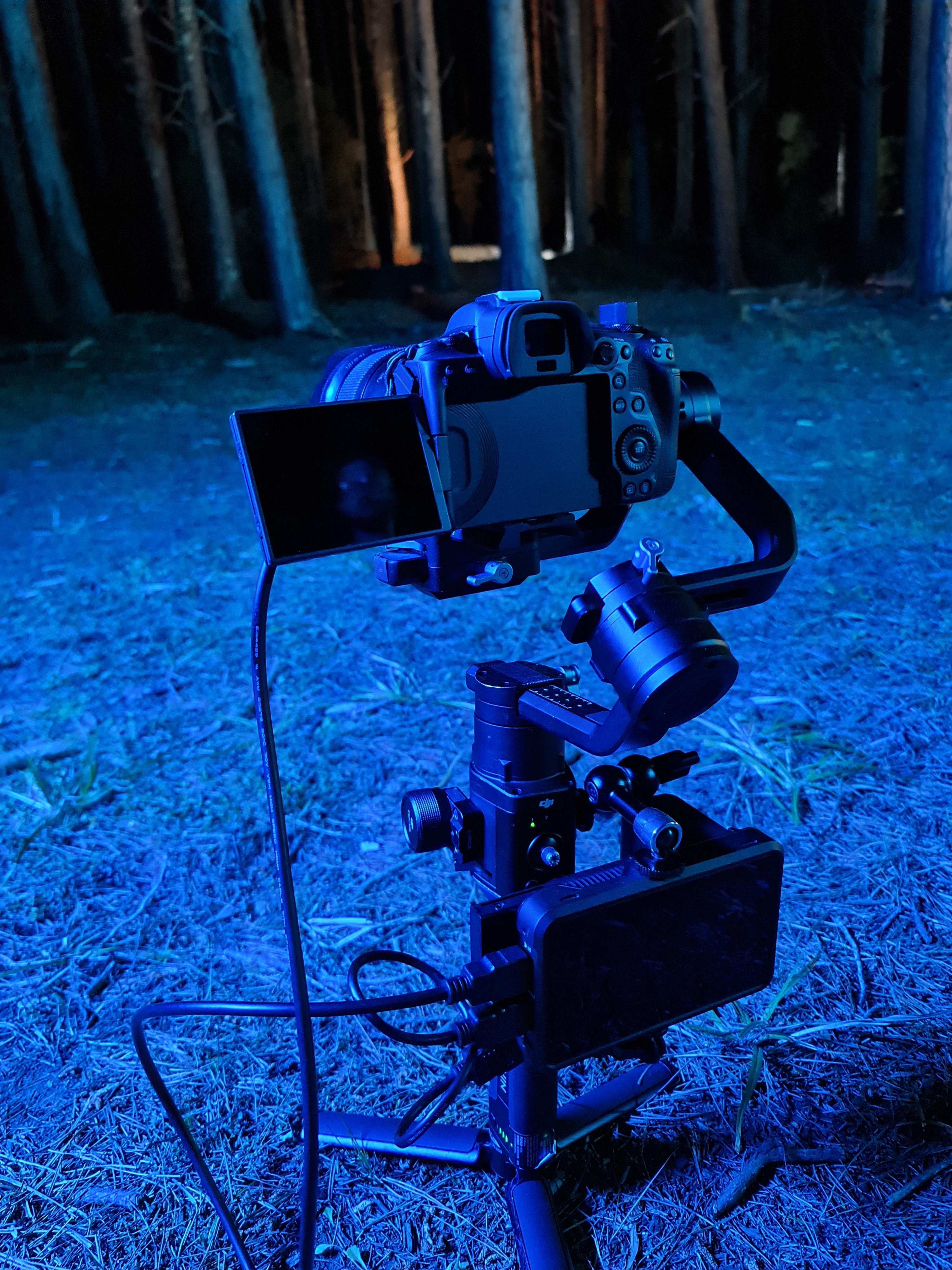

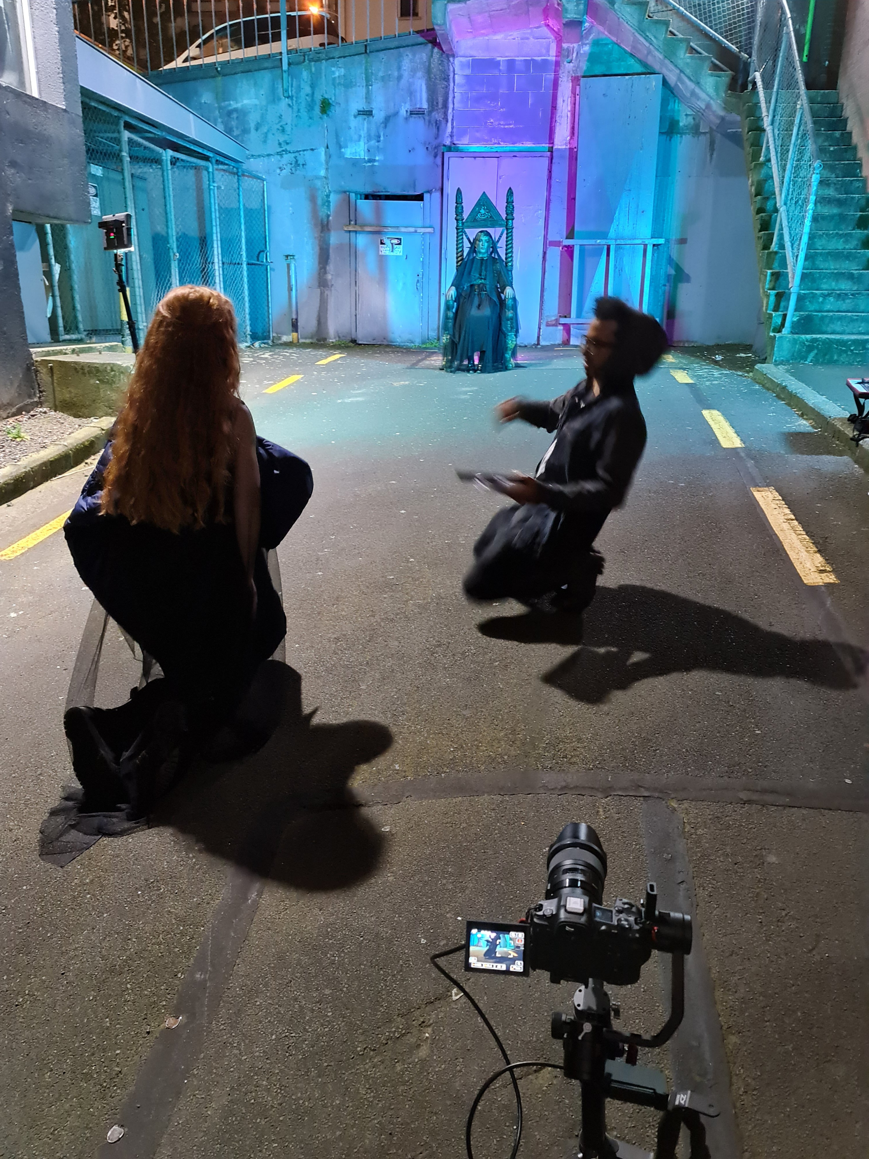

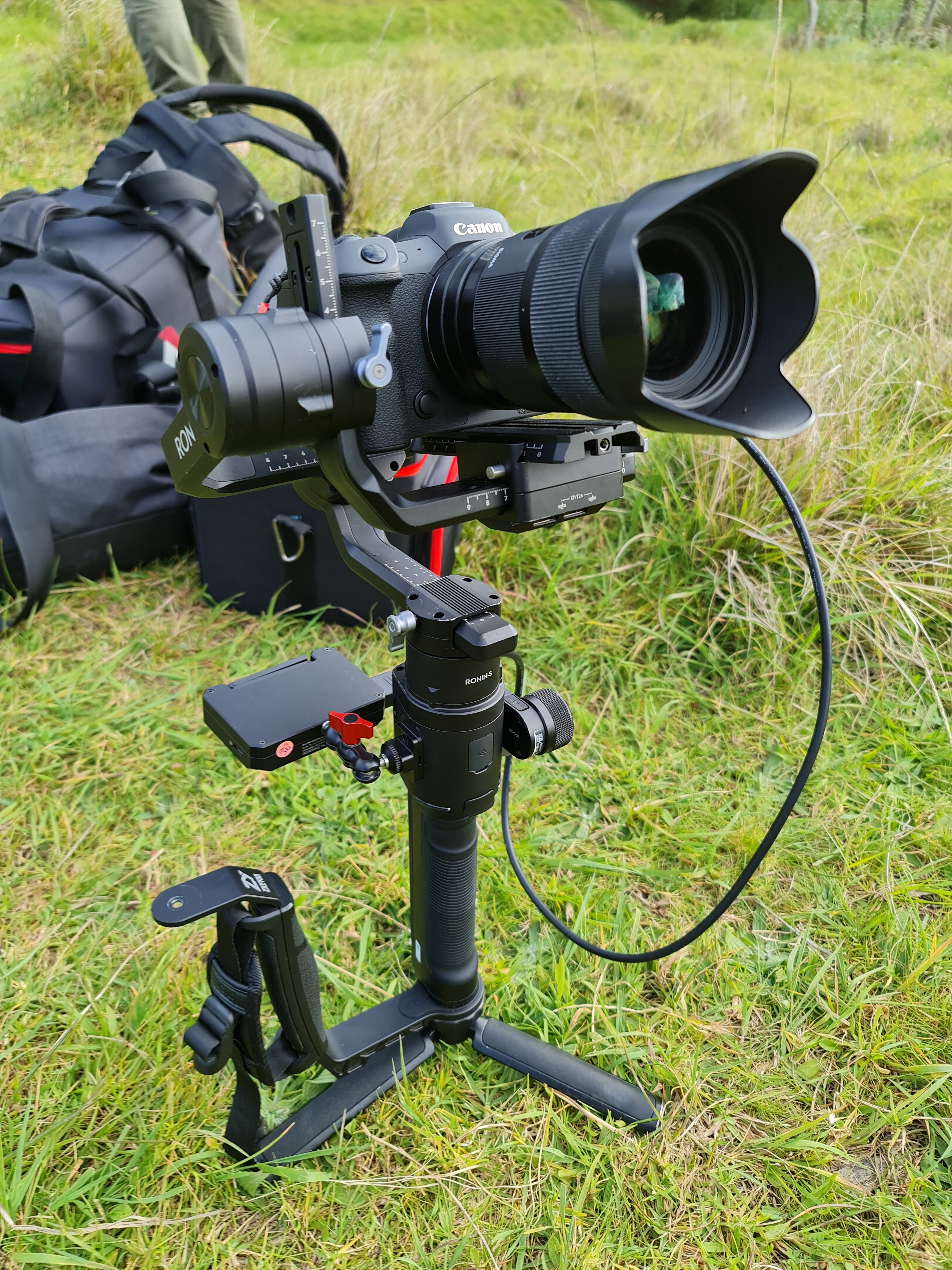

ntblowz Posted October 9, 2020 Author Share Posted October 9, 2020 Did a MV shoot last night, shooting everything 4k50p both internally and to Ninja V, no overheating after 1 and half battery. Got another shoot on Sunday and will update on that. The Sigma Art 35 1.4 works pretty well.. like it more than my rf 35 1.8 Link to comment Share on other sites More sharing options...

ntblowz Posted October 11, 2020 Author Share Posted October 11, 2020 So did a 7hr music video shoot today from 4-11pm (sunset 7:40pm here) R5 did see 4k50p drop to 25min a few times, but most of the time is 29.59. Used another 1 and half battery, and 1 128gb and 1 64gb card, I really need a 256gb sd card for 4k50p. Link to comment Share on other sites More sharing options...
